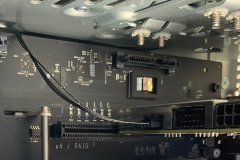

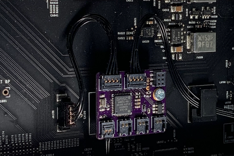

Update: GPIO and USB hub module installed and working.
The module provides four internal USB data connections: one for the BT module, two for the GC-TITAN RIDGE, and a spare (pictured above, only the BT connection is used). It also provides GPIO for the GC-TITAN RIDGE (see above on the right). To the best of my knowledge, this is the first active add-on module for interacting with a Thunderbolt card through the THB_C header. The module not only takes care of FORCE_PWR but also detects SLP_S3 to reset one of the PD controllers for proper wake-from-sleep behavior. As a result, my LG UltraFine 5K display no longer stays black when my Mac Pro wakes from sleep!
So JA120 can be connected to power the BT module? What is the pinout and what connector it requires? Do you have any board diagram?
Yes, the internal USB (Bluetooth) header (labeled JA120) is used to power and provide USB data lines for the GPIO and USB hub module. I'll be providing additional technical details about the device (as well as possible procurement information) in a dedicated thread shortly.
