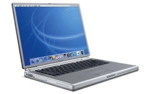

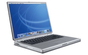

And also yes, Titanium will scratch also of course.
It's just lighter, very strong, and has a look some like 🙂
Oh the good ol' TiBook. My favorite Mac. Although I never even owned one 😀
