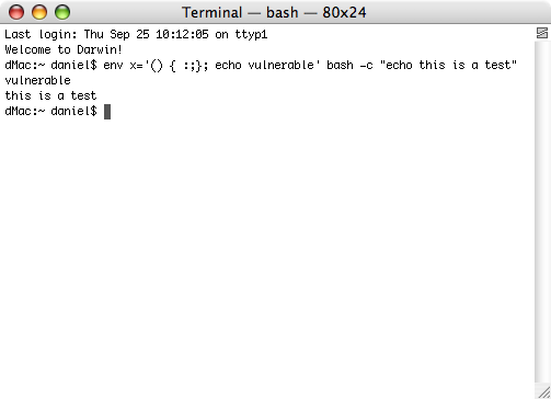

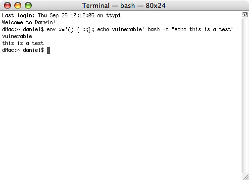

Well, I know for certain that Tiger is vulnerable to the bash bug and I was wondering what it means for us PowerPC users who will most likely not get a fix from Apple.
We had to abandon Flash due to vulnerabilities, but is it now time to abandon PPC altogether? Or is this simply a case of a vulnerability being over-hyped and in reality we're actually probably going to be okay?
Discuss. 🙂

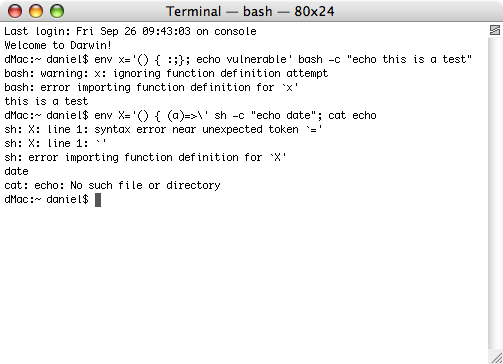

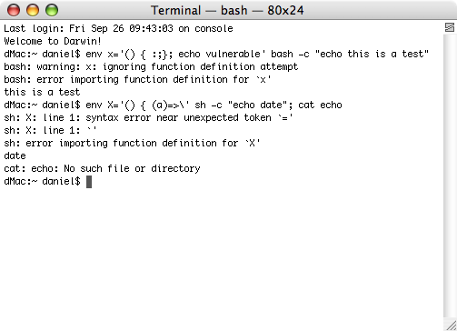

    Restart your Mac as a paranoia to make sure everything is using the new copy of bash.
    Bask in the glow. Then, find a shell that doesn't suck.
