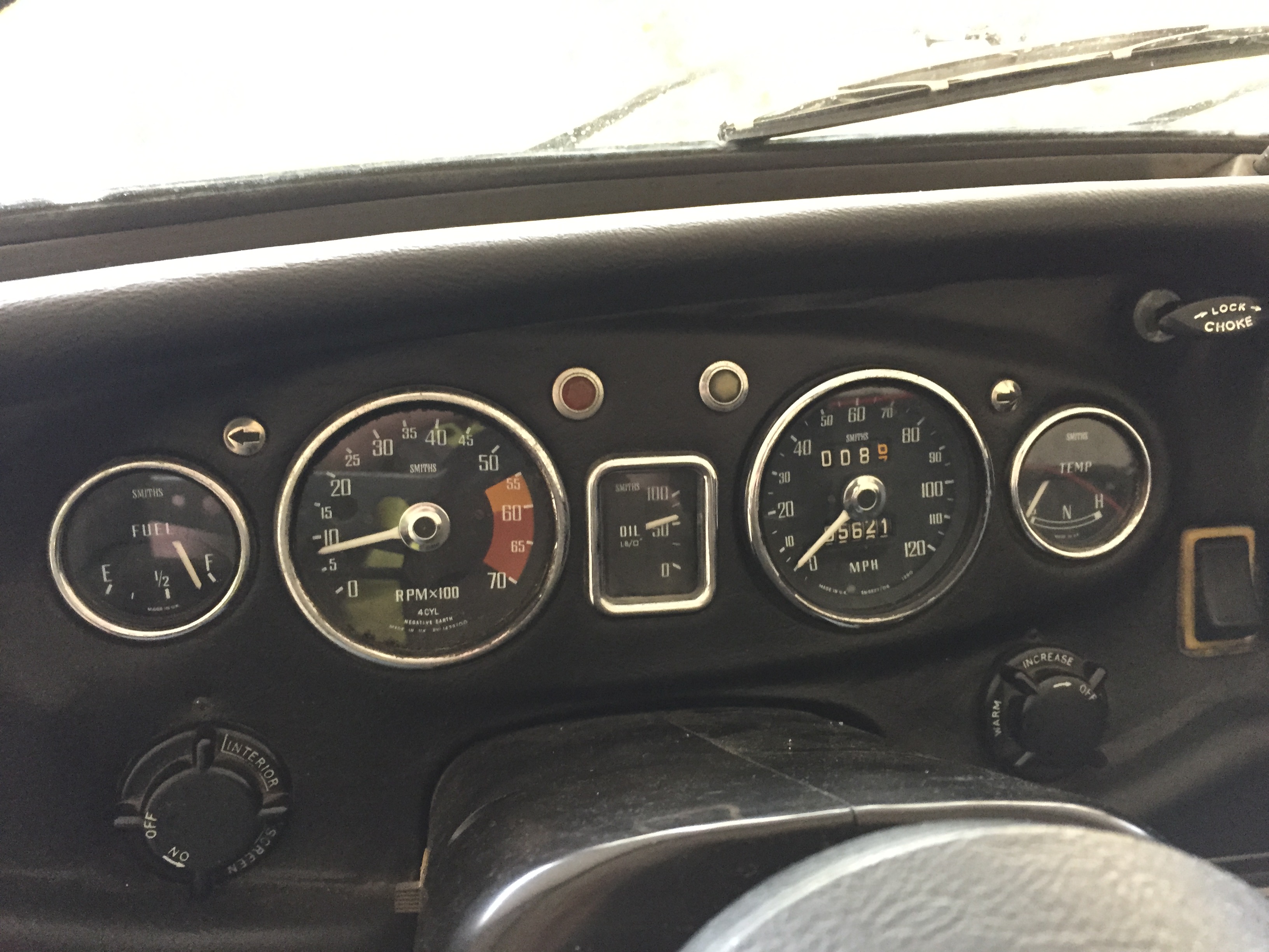

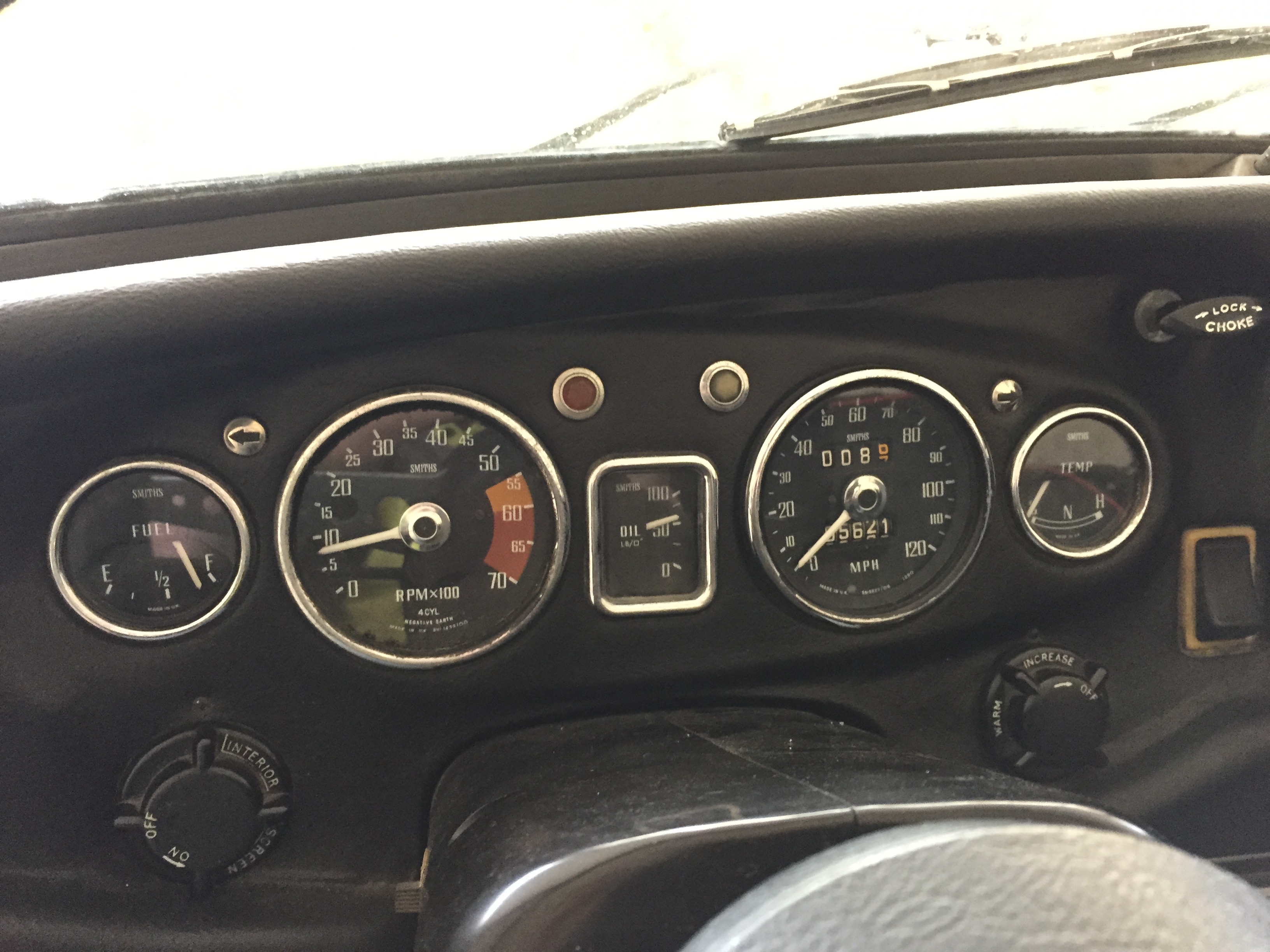

I know "about" how fast certain speeds are from the tach, so can watch my speed on things like state highways(i.e. ~3000 rpms in 4th gear is about 55) or otherwise I just keep up with the traffic.
After doing some investigating, the problem-it seems-is the nylon drive gear inside the transmission. The guy who sold it to me replaced everything between the transmission and the speedometer itself. The only way to fix this is with a full transmission pull down. This is actual a fairly common problem.
I've had more than one person tell me they have "a garage full" of good used MG 4-speed transmissions, and $50-100 is the going rate for one. When the time comes to do the clutch, I might drop in a replacement transmission, or I might put in an overdrive transmission. In the mean time, I don't see the value in pulling the whole thing apart just to fix the speedometer. If I really need one, I have a GPS and/or an iPhone app.
That's pretty much the exact same situation I was in, full teardown of the transmission or replace it. Just not worth the hassle, even though transmissions were about $75 at the junkyard.
