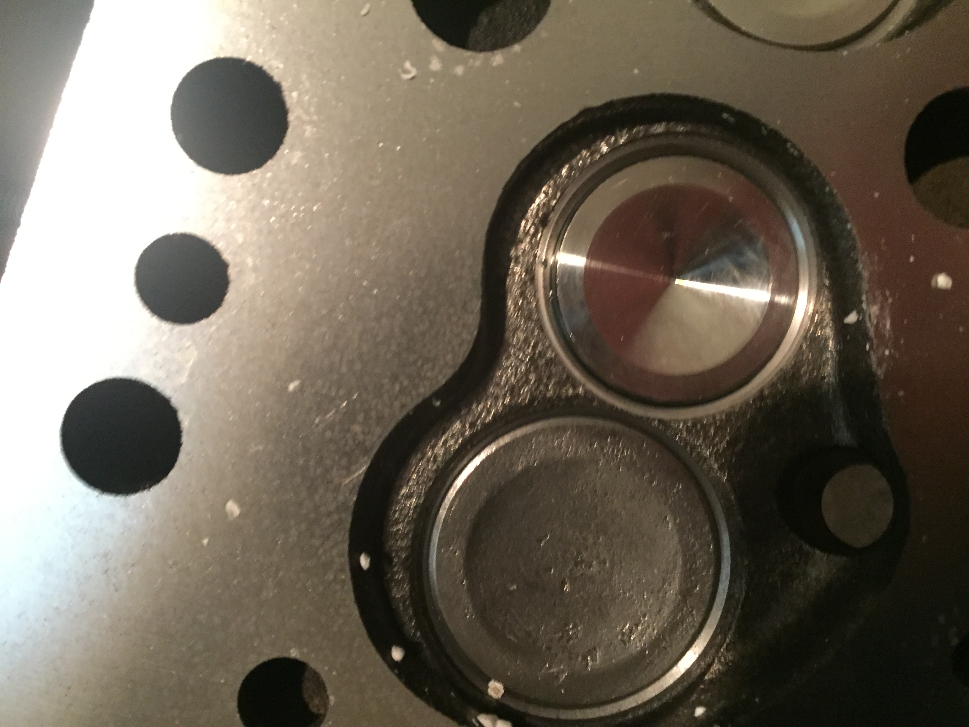

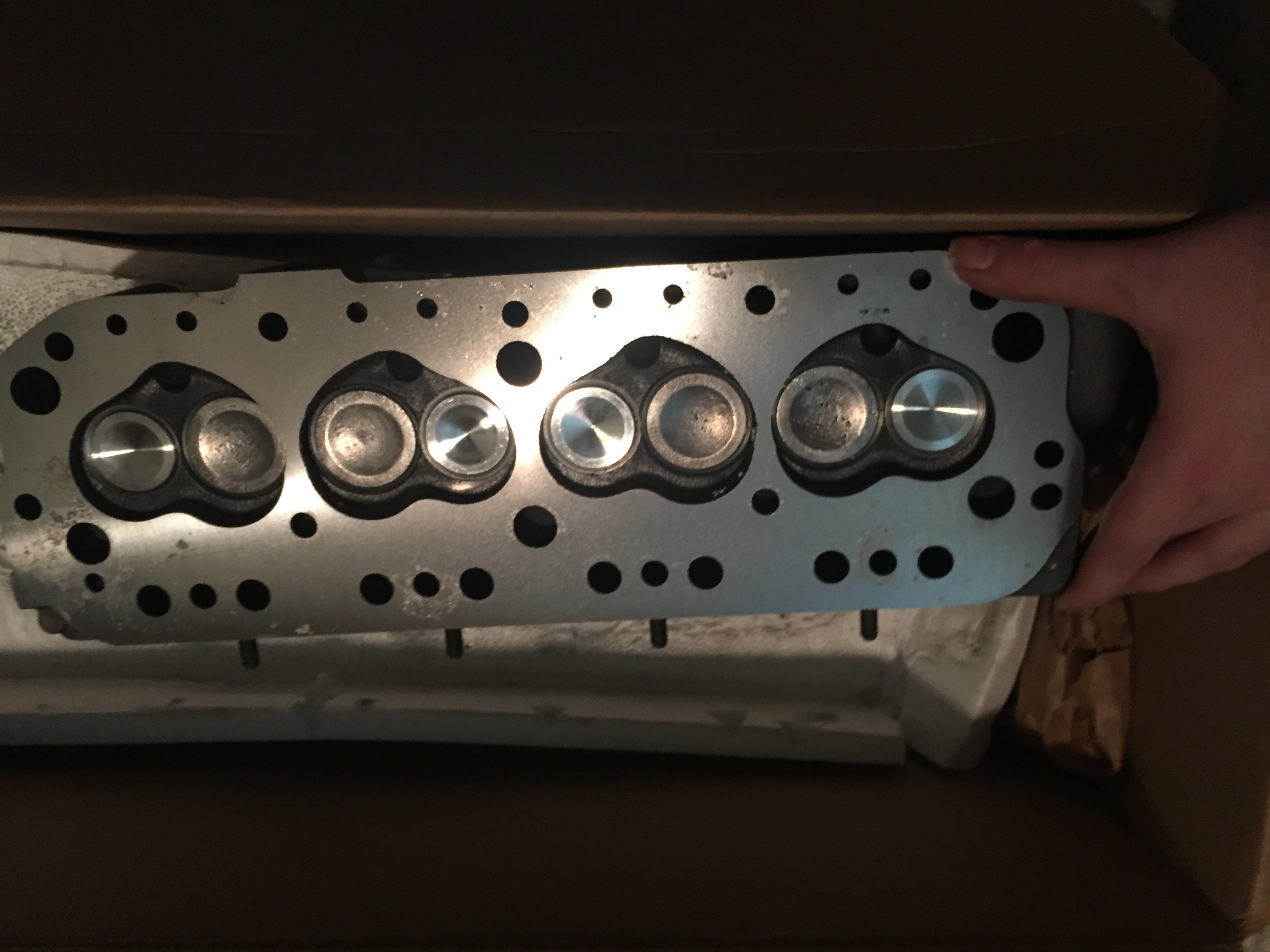

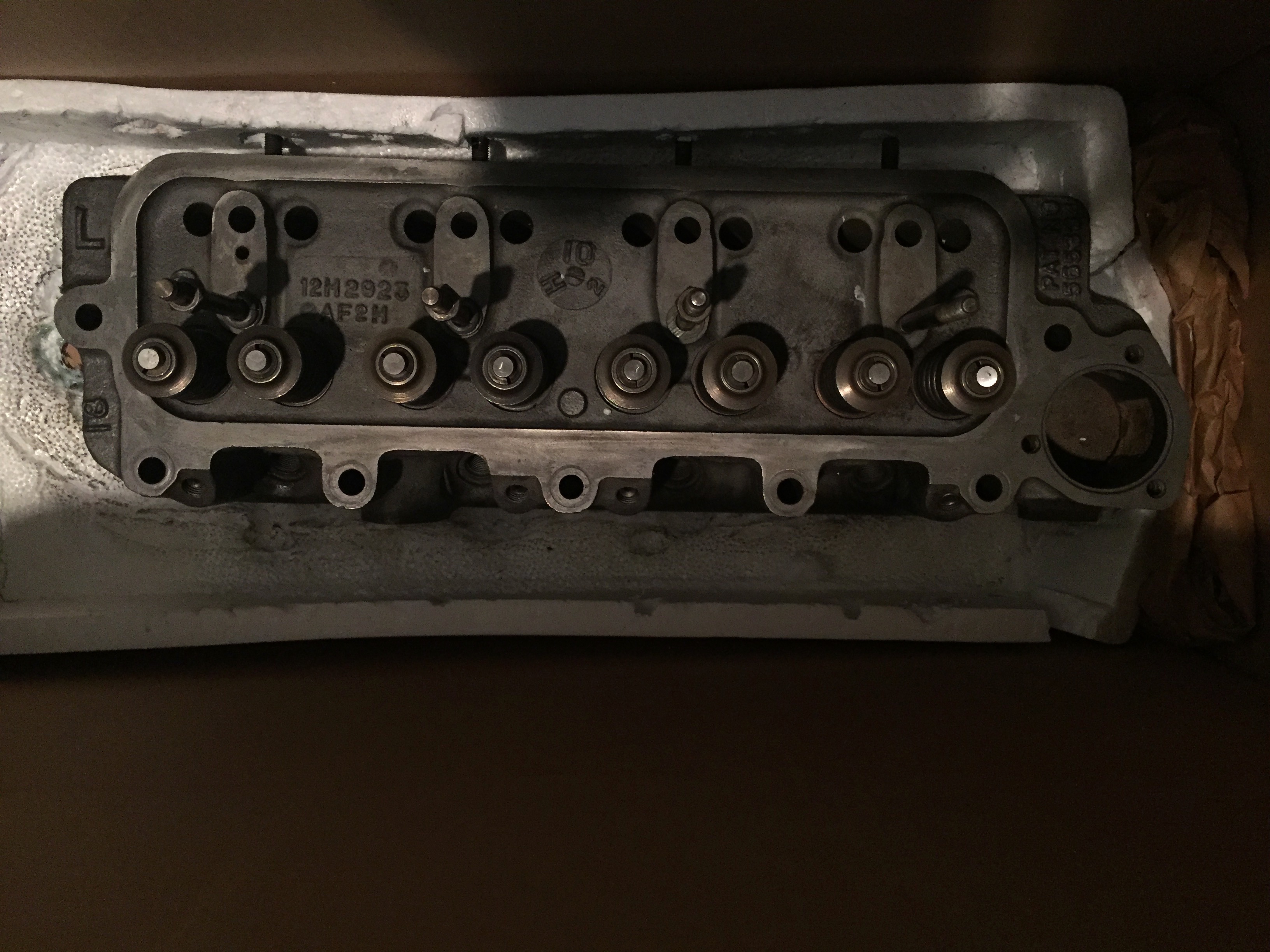

I have been fighting off doing a valve job for a little while. MGs are notorious for erosion on the #3 exhaust valve, and I've been steadily watching my compression drop off on cylinder #3 since I bought the car. When it hit 110 psi(vs. a steady 145psi for the other cylinders) I thought it was time to do something about it.
I'd bought the exhaust valves, but there's probably a 3 in 5 chance that I'll get my head off and find a crack in it-it's just the nature of the beast. I have a spare head sitting here that is good AFAIK(actually a spare mostly complete engine with a cracked block, but that's another story), but it's the notorious CAM1106 casting that has some other issues.
So, I decided that I'd take a chance to do a performance upgrade. Stock MG engines came with either "deep dish" or "shallow dish" pistons, and with either "big chamber" or "small chamber" heads. Pre-1974 cars had "shallow dish" pistons combined with a large chamber head. This gives them an 8.8:1 compression ratio. In 1973, the engine was redesigned for lower compression(emissions). The pistons were given a deeper dish, and the combustion chamber made smaller. This gave 8.0:1.
That leaves the opportunity for a "magic combination" of shallow dish pistons with a small chamber head to give a C/R of 9.4:1.
So, to that end, I contacted a friend who rebuilds heads, and he was able to supply a rebuilt 12AH2923 head. This is the desirable small chamber "big valve" head used from '73 to '76. He also did some very mild port and polish work on it.
I will have to make some very small modifications to my block, but it's otherwise a drop-on fix. Aside from restoring some factory performance, this will give a nice performance boost. I'm told that the compression boost will get to about 115hp, up from 93hp stock. I know that doesn't sound like a lot, but it's still a 20% increase on a 2000lb car.

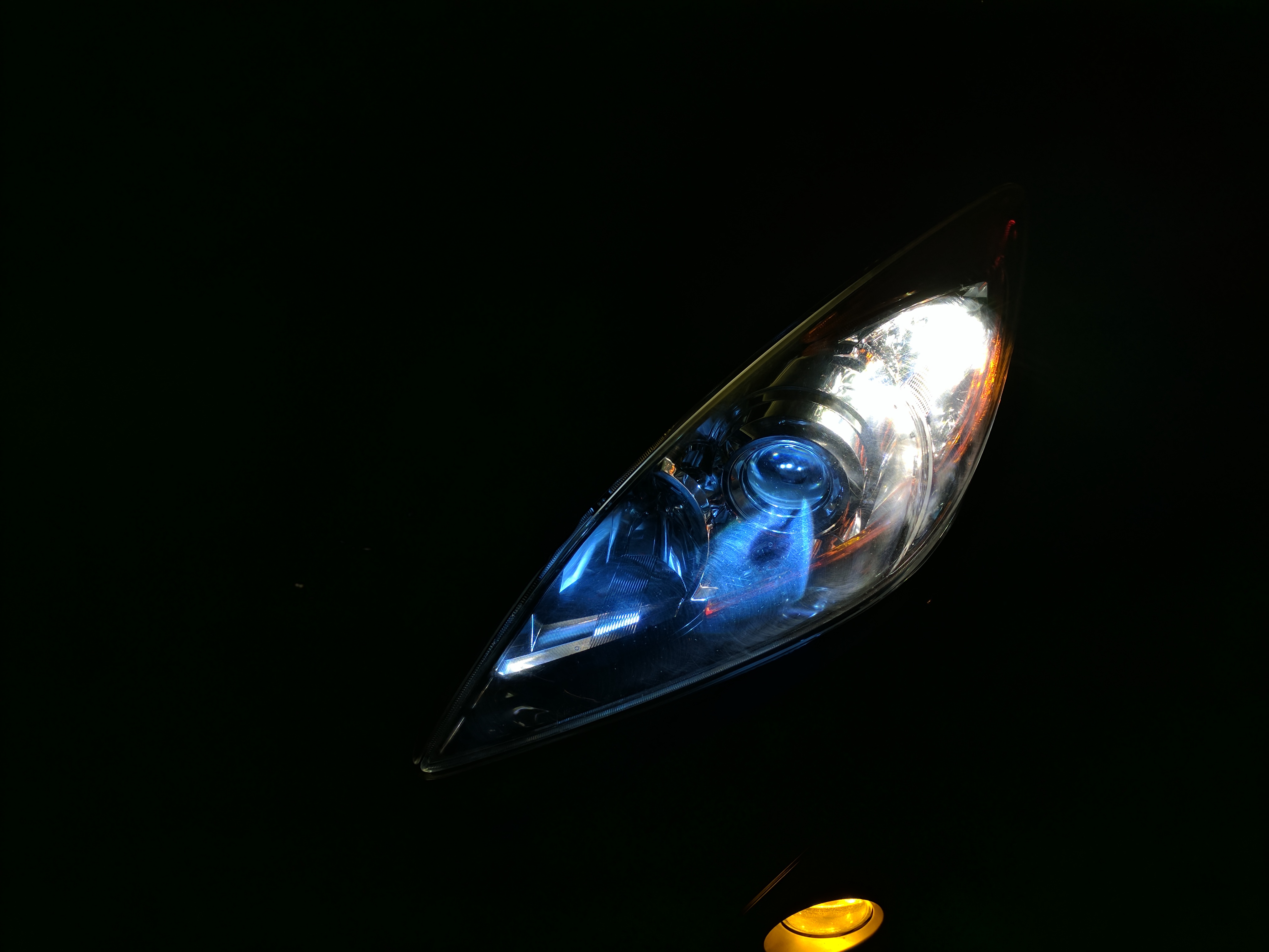

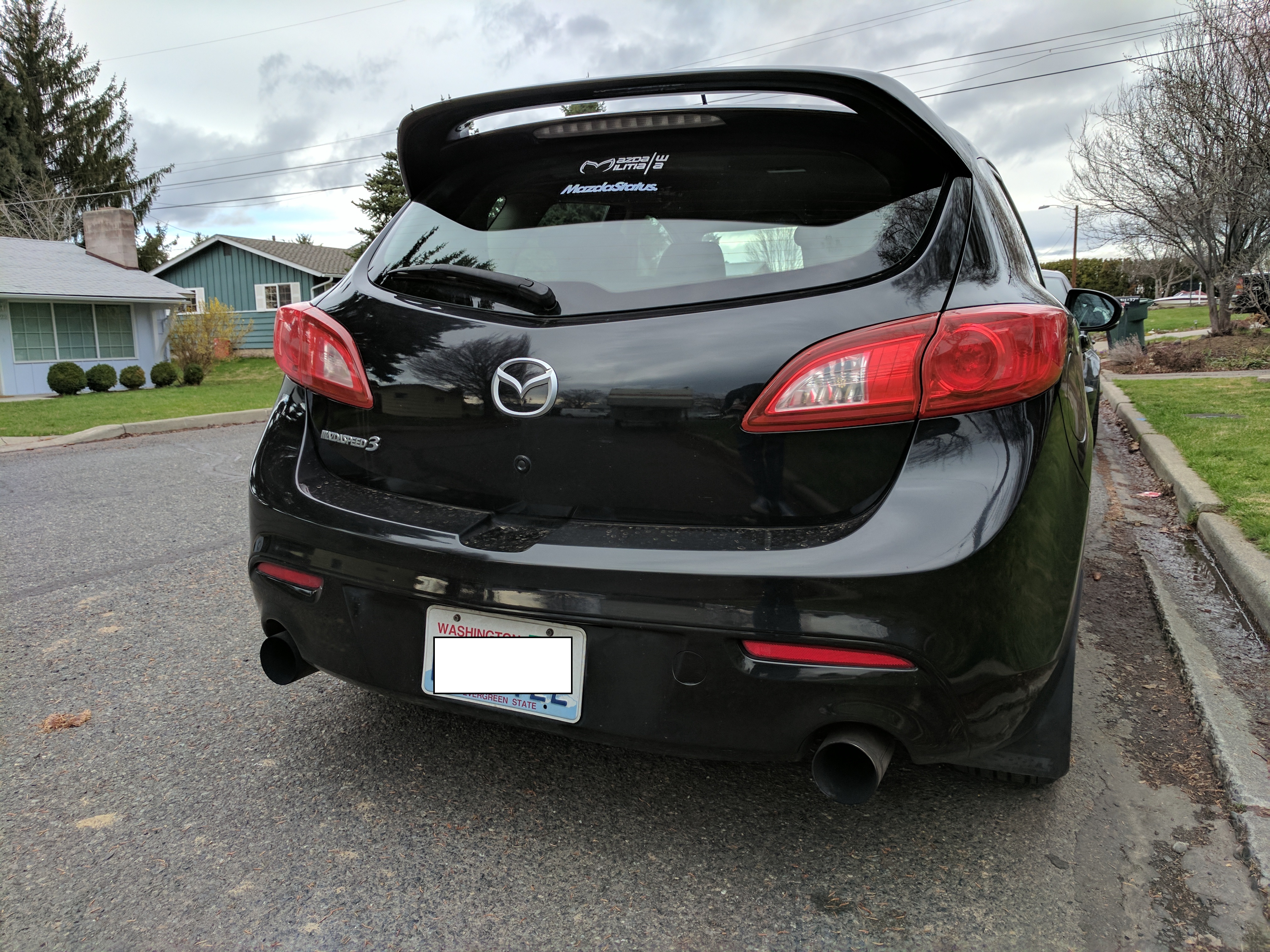

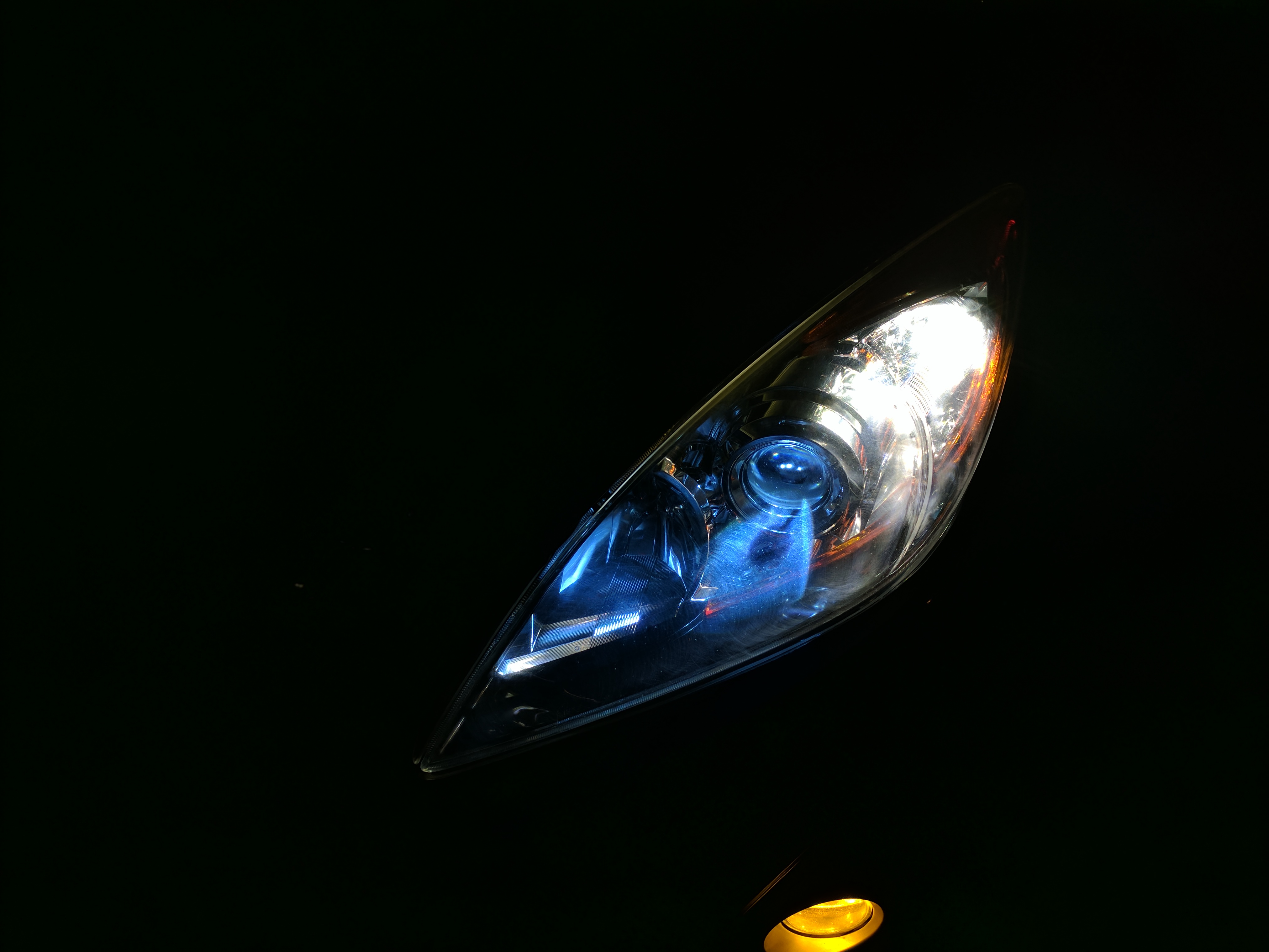

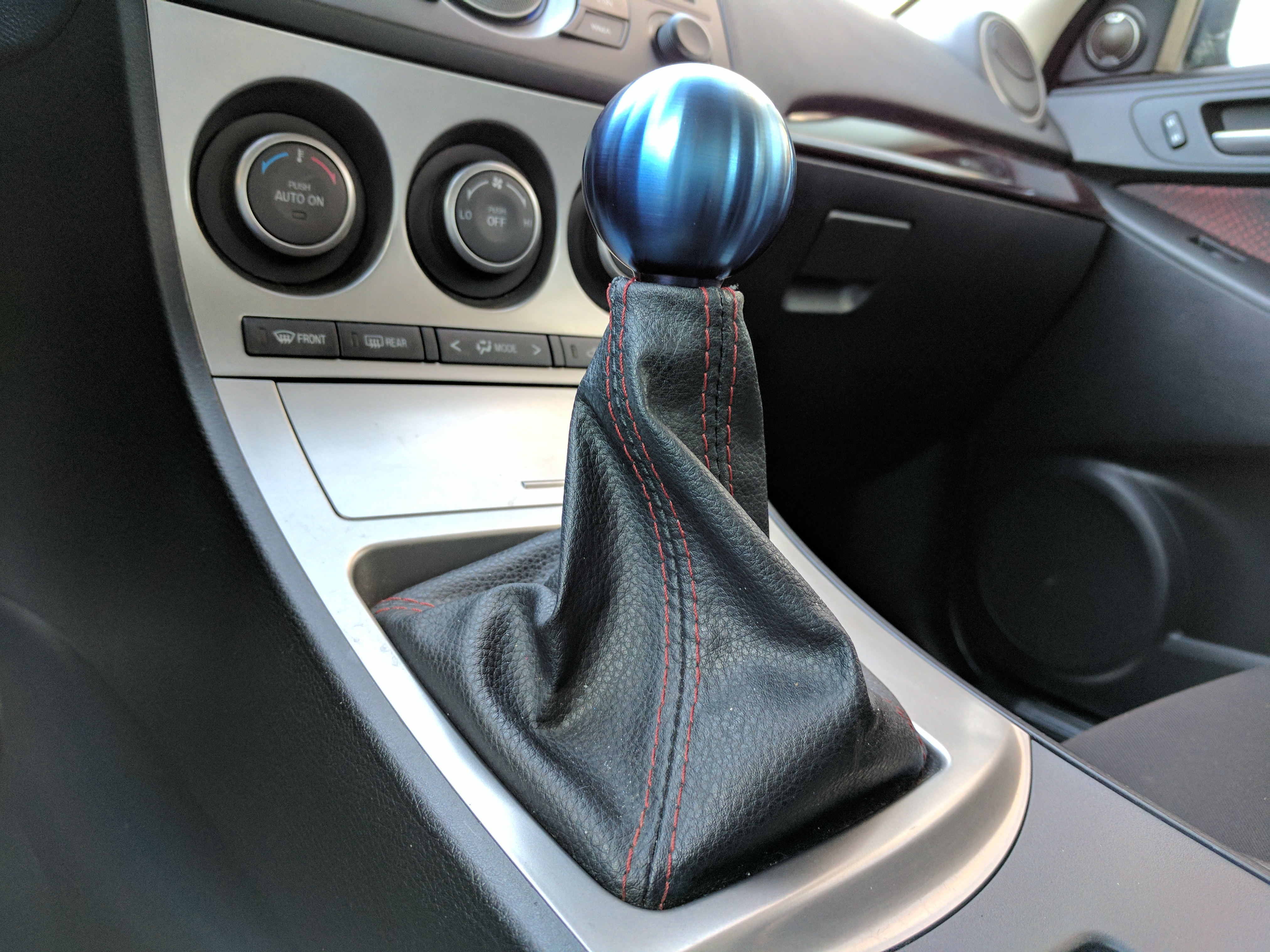

I've done a lot of little things to my 2010 Mazdaspeed 3 over the past month, as the winter has finally passed here in Eastern Washington... Bigger plans in the summer, but for now, little things.

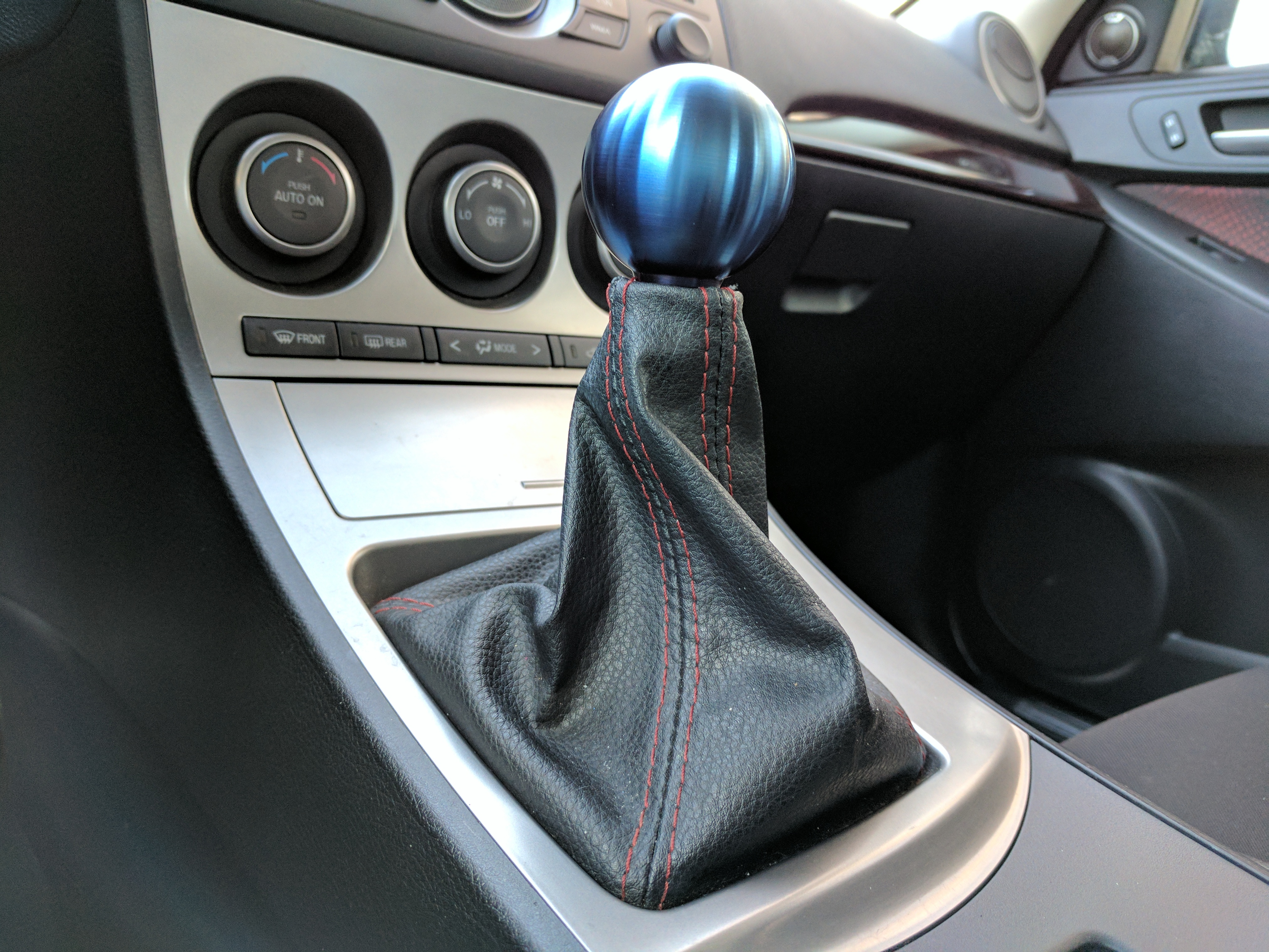

  • Blox Racing 490 Gram Shift Knob in Torch Blue - Amazing how much of an awesome difference a weighted shift knob makes to shifting gears.
  • Hella Optilux Yellow Fog Light Bulbs - The stock halogen fog light bulbs sucked, and I wasn't impressed with the few different sets of LED bulbs I tried. Ended up with these and boy, they're absolutely amazing. (https://www.amazon.com/gp/product/B002E2WMWG)
  • The Retrofit Source ACME LED Switchbacks (White / Amber) - For the "running light" / front turn signals. After getting 4 replacement sets of JDM ASTAR switchback LEDs (kept burning out after 30 seconds), even with resistors! I picked these up and they've been going solid for a few weeks now. I love how clean it looks.

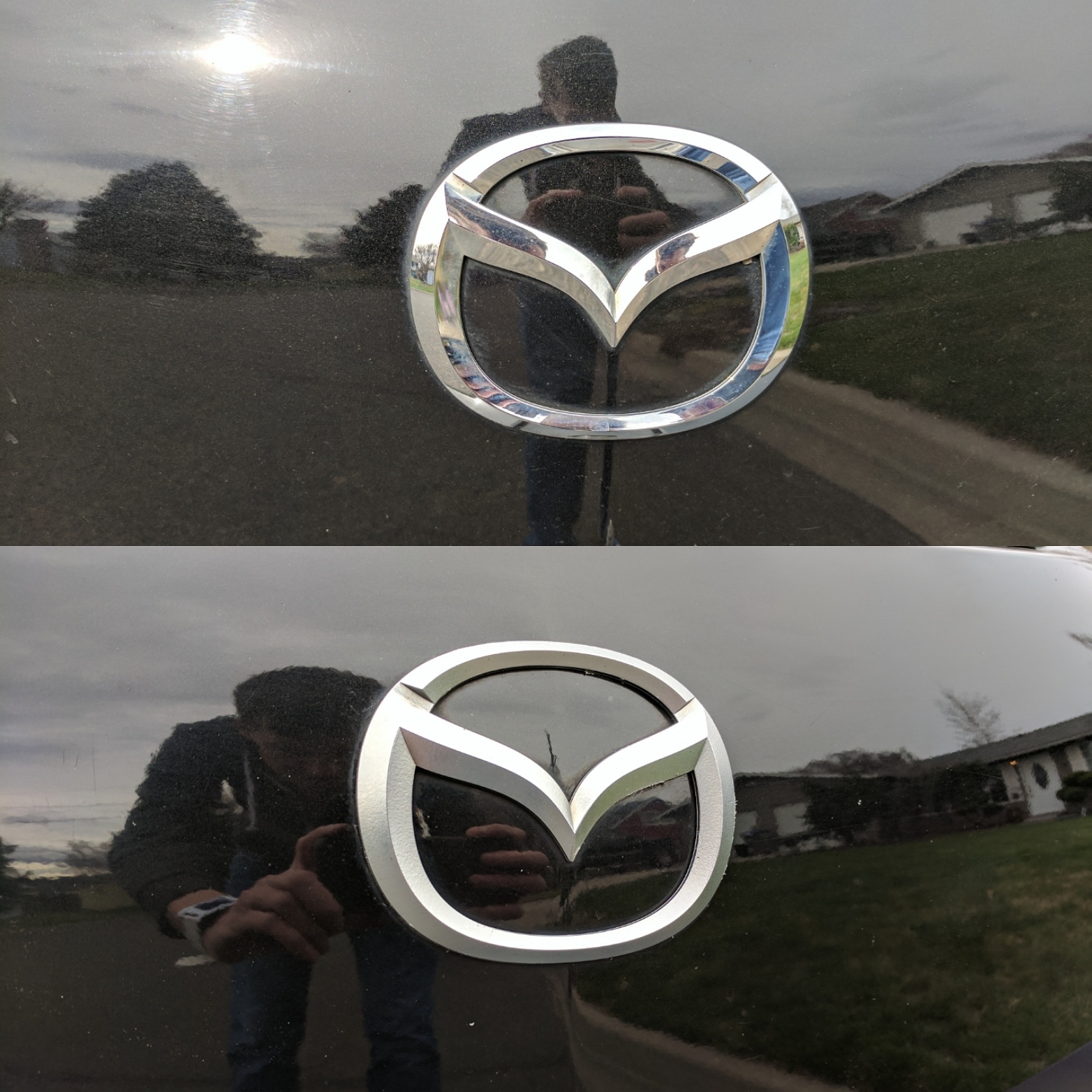

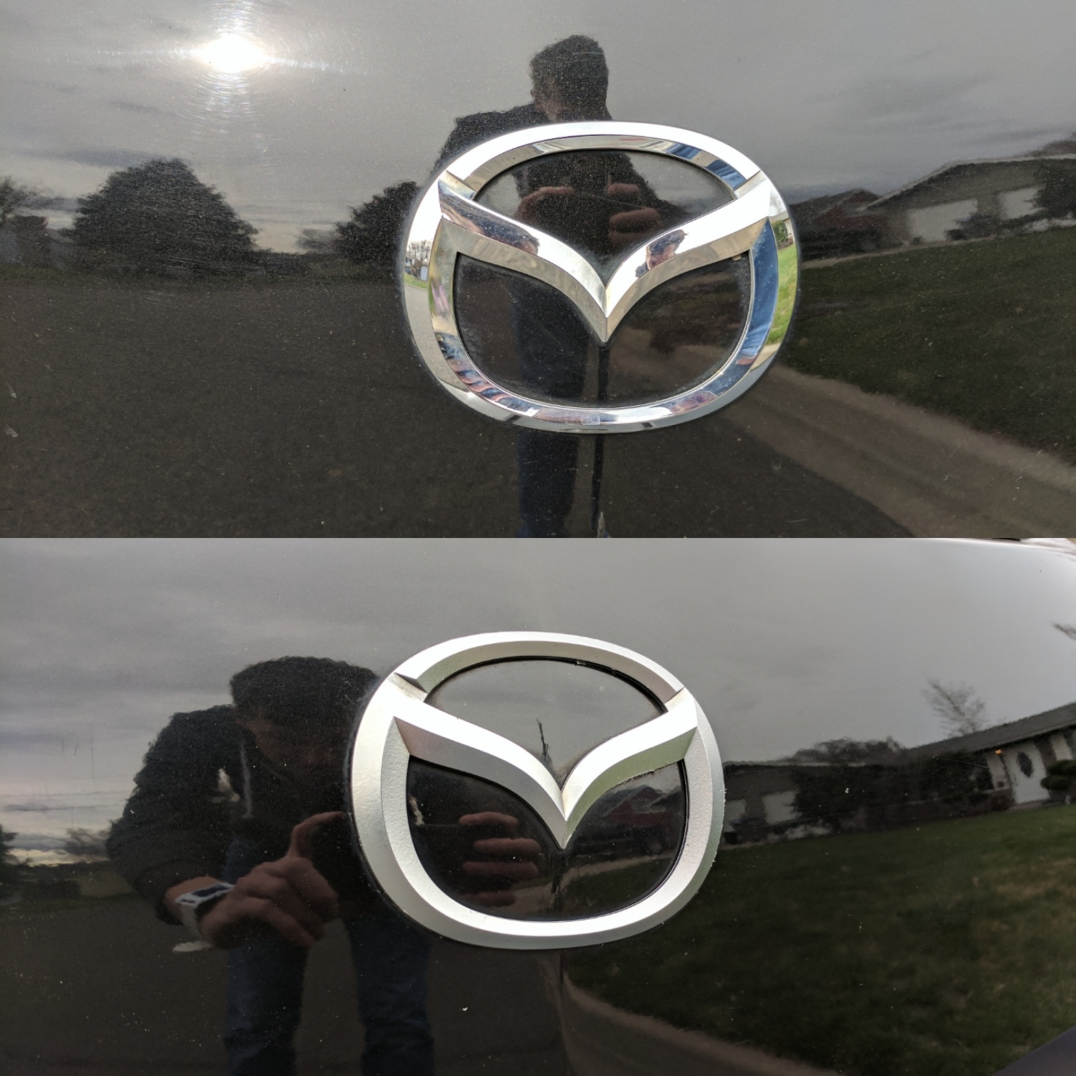

  • Matte Clear Plastidip over Mazda Badge - Found a can of this in my garage, decided to play around with it on the badges and was impressed with the look. Looks kind of satin!
  • Wrapped Taillights - Looks SO MUCH BETTER than the stock clear / chrome lights. 🙂
Pictures are in the order of the list:
IMG_20170222_151142.jpg IMG_20170311_193320_283.jpg IMG_20170325_220108.jpg IMG_20170328_175407_897.jpg IMG_20170329_133213.jpg
