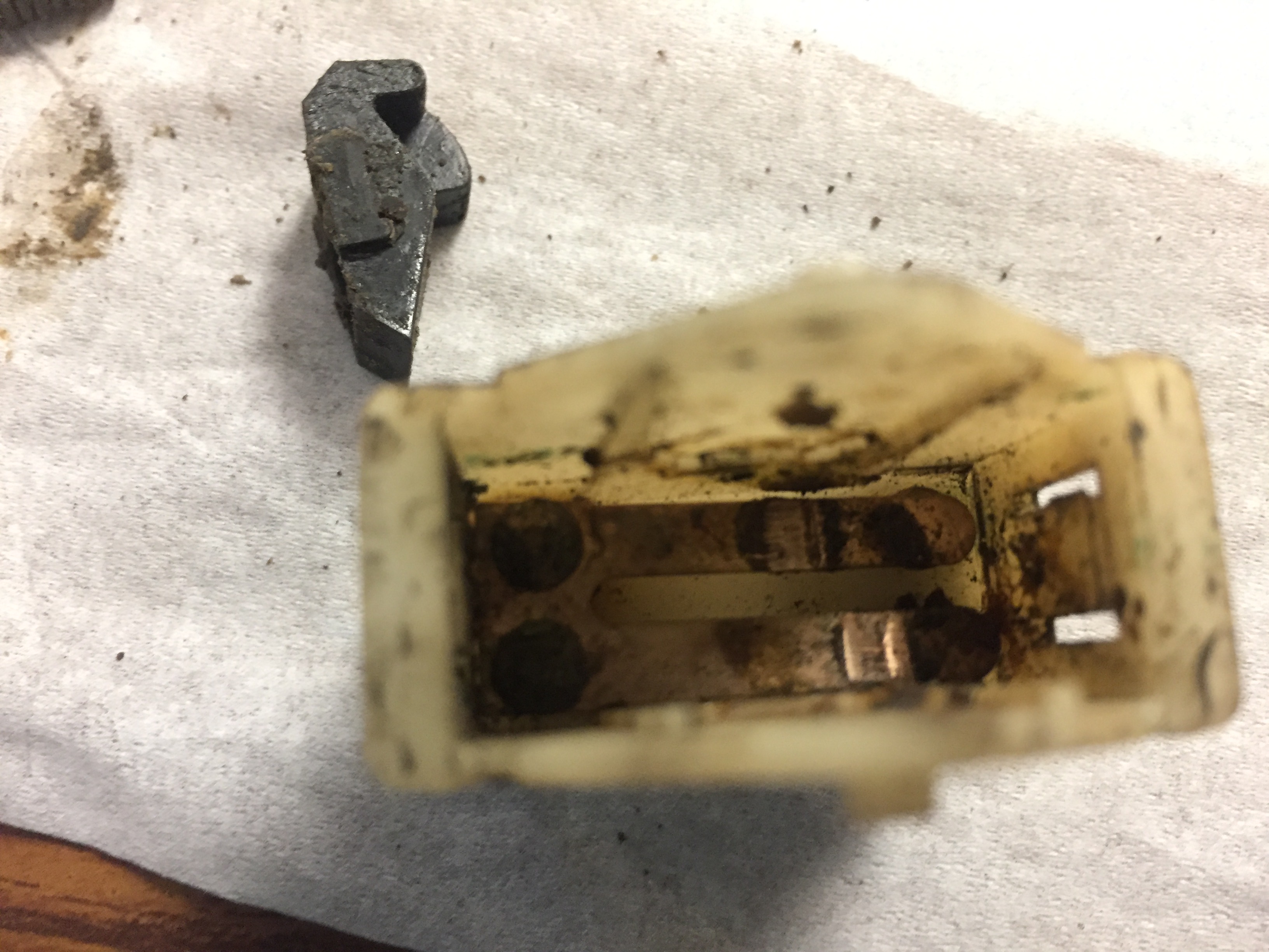

Alright, I drove the MG to work today and figured I'd tackle the headlight switch if I had time.
The biggest struggle was getting it out of the dash, but I finally figured out exactly how it was clipped in and it came out with a bit of wiggling.

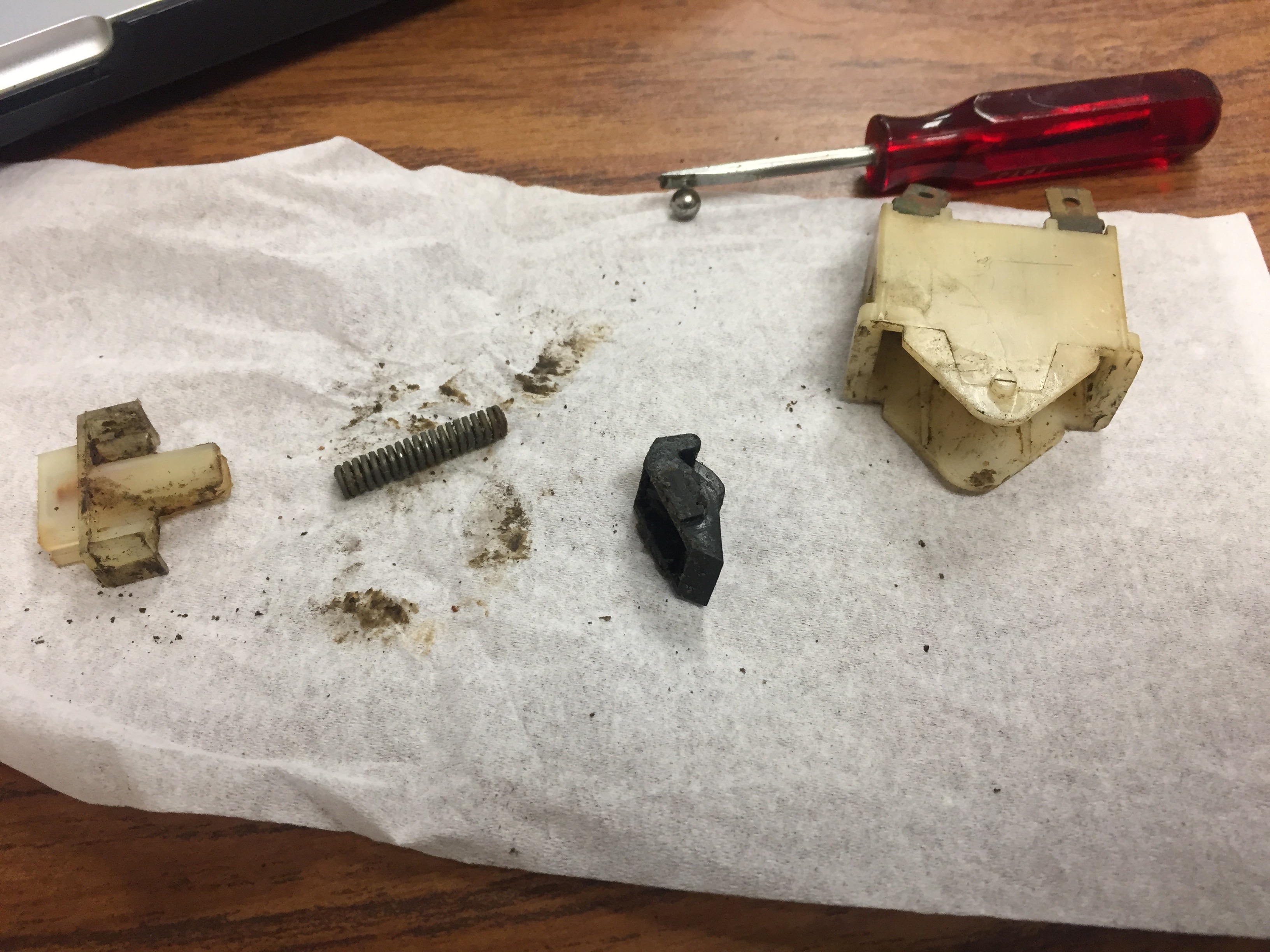

Disassembly was straight forward-the rocker switch popped off at the pivot point, and from there everything just pulled out.
There wasn't anything obviously wrong with the switch contacts aside from being dirty and greasy
So, I figured I'd give them a good cleaning and go from there.

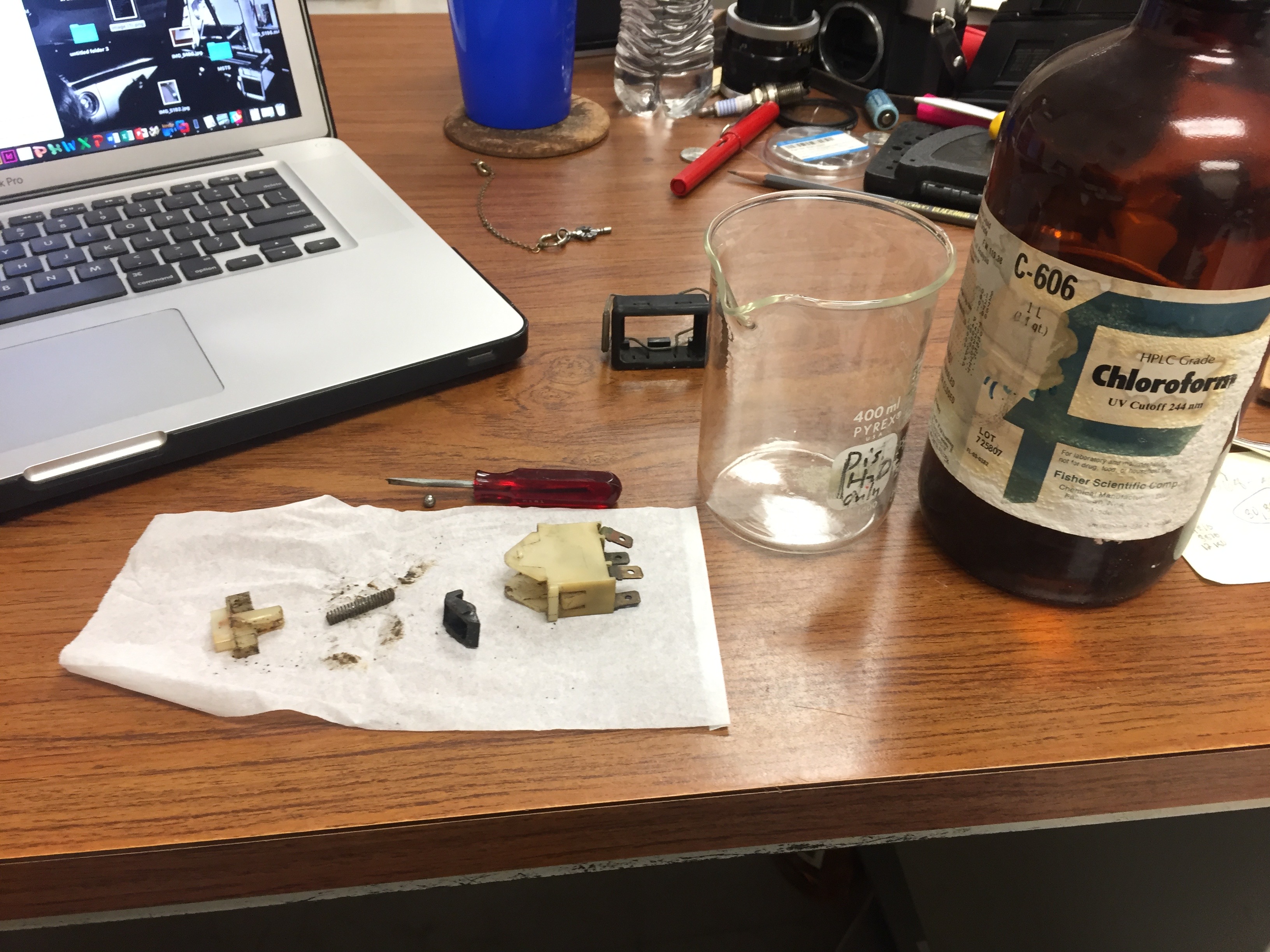

My stock of carbon tet is getting low, so I went for another great electronics cleaner-chloroform. In any case, I worked some into the contacts with an acid brush and got them relatively clean(er). Since they were all riveted in place, I couldn't get under them to inspect and clean them as well as I would like.
Still, though, after a few minutes of work I had this.

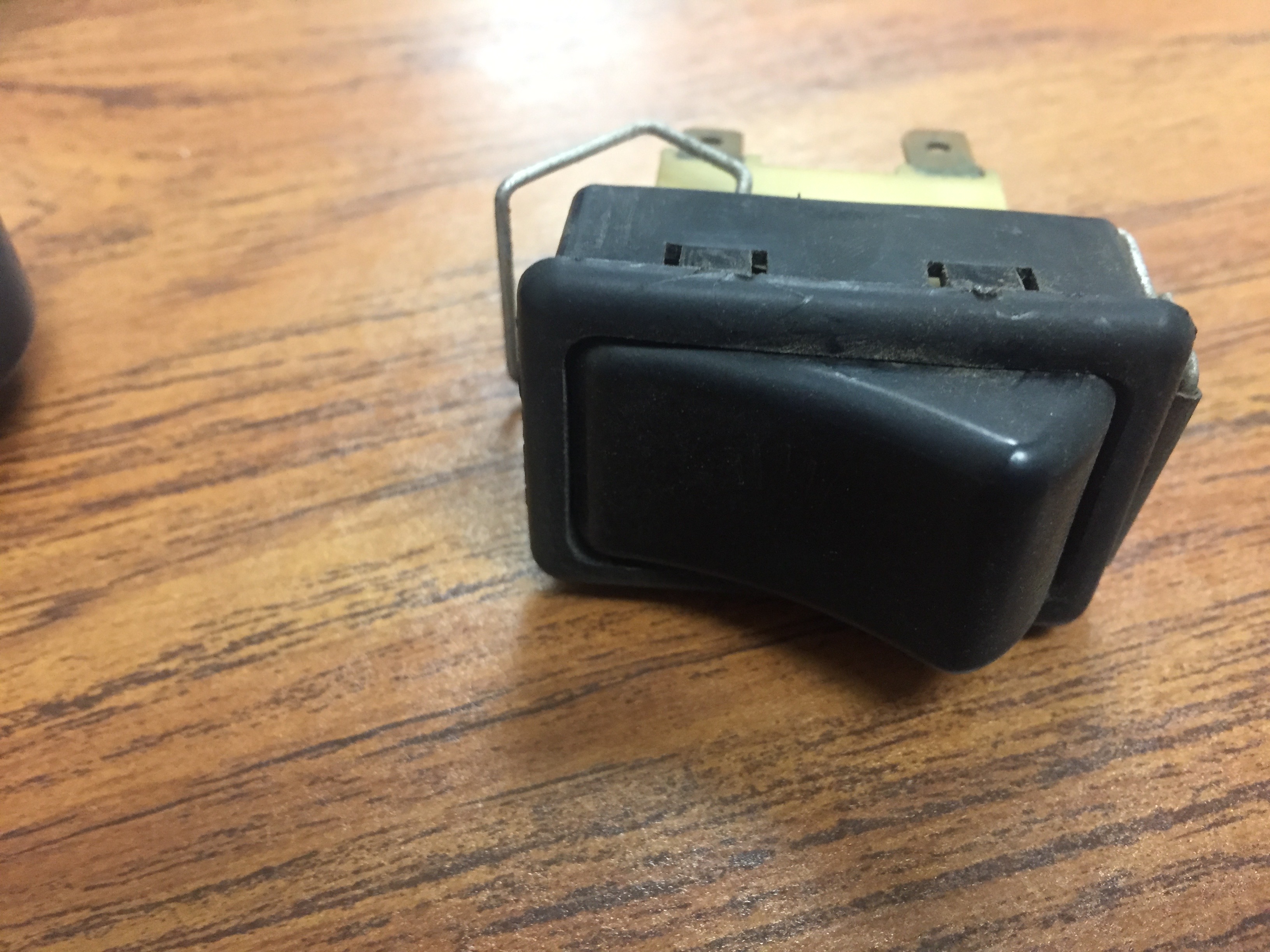

Once I figured out the ins and outs of how it went back together, it bench tested fine. During lunch, I hooked it back up and everything worked just as it should.
As a side note, one of the rivets was loose and I didn't have a good way to tighten it up at work. I thought I'd try soldering it. Unfortunately, apparently my soldering station got wind of the fact that I was working on a Lucas product. I heard a pop and saw the magic smoke coming out of the temperature controller-after that the iron wouldn't heat. Fortunately, the loose contact(which might have been my original problem...)was internally connected to the one next to it, so I just used the other.
