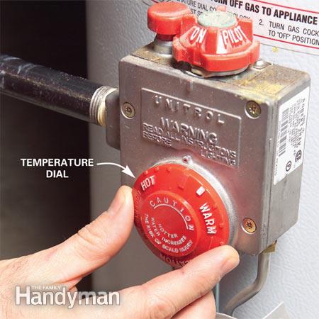

So, I've been having some issues with our water heater lately, which is gas.
Since winter started, I've had to turn the handle in the shower much further to the hot side of the spectrum to get a pretty warm shower. I haven't really been bothered by this, as long as the water has been hot enough to get a warm shower.
However a couple different times now the water just doesn't get hot at all, and I've had to take cold showers. Not 100% ice cold, but definitely cold to the point you are freezing and are hurrying to get it over with as quick as possible. This just happened this morning. Water heater could not have been out of hot water, as my wife is out of town for a month and I hadn't used hot water since yesterday's shower, 24 hours prior.
I turned my shower off and went to the upstairs bathroom to see if it was any better and it wasn't.
Water heater is not that old, it was new in 2007 or 2008.
I'll try running the shower again tonight and see if it's any better, but if it's not, do I just call a regular old plumber to come look at it/troubleshoot it? Or do I need to call a water heater specific place?
I don't really get how it could sort of work, seems like the kind of thing that would either work completely or completely crap out with no inbetween.

There are 2 things you should check:
1. the temperature control knob. It's possible someone turned it to the lowest temperature.
2. the pilot light. That's something an handy home owner can check himself and deal with himself. Most water heaters have the instructions on the heater itself.
A plumbers can deal with water heater issues.
