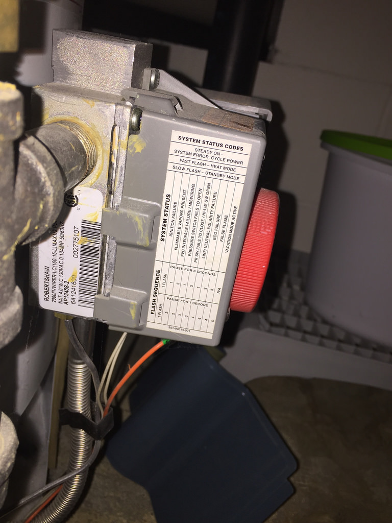

Went in to see what I could see, temperature control is 3/4 of the way to the hottest setting, so that's probably fine.
There's an LED on the unit that flashes when there's trouble, and best I can tell it seems to flash twice with 3 second pauses in-between, which I guess is an eco failure? This thing has a really bizarre flash troubleshooting scale, based on this pictured table, like if it flashes 3 times with a 1 second interval or 1 time with a three second interval it has the same problem? Bizarre.
So I guess I'll be calling a plumber tomorrow, goddamnit.

Looking in the pilot window, it's not lit/won't lit, and it also seems as if the heater is leaking as under it theres a slight wet ring and all behind the heater the concrete is freshly wet (not dripping from the overflow line etc).
Does anyone know how to read/understand these flash sequence codes? Looking online at someone else who had a "4-2 eco flash failure" it seems that my initial understanding of these codes were wrong, I thought you could have two different flash sequences to mean the same thing, but that doesn't appear to be it.
So using the Eco failure as an example, how do you read this table?
A) The LED flashes 4 times, waits 1 second, then flashes 2 times, and waits three seconds, then this repeats?
B) The LED flashes 4 times with 1 second in between each flash, then flashes 2 times, with three second intervals between flashes, then repeats?
C) Neither of the above/other?

"A" makes the most sense. 4 flash, 1 sec pause, 2 flash = eco failure. The 3 second pause = end of flashing sequence. That's my best guess.
From your previous post of 2 flash and 3 second pause, I believe that = 1 flash, 1 second pause, 1 flash which means ignition failure. That's consistent with you saying the pilot light being off.

So, the heater is trash, new one en route. $1600 installed for a like 40 gallon tall (it's a power vent style), but then it's on sale and the tech gave me a $25 coupon knocking it to $1525, and then if I pay with a check which I will, that knocks it to $1475, and there's a $100 rebate too that I'll get in a few months, so $1375 all in (plus $115 to have the guy come out this morning), unless there are incidental expenses or parts needed.

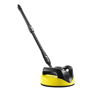

You might find one of these useful as well.
Makes even shorter work of decking etc.
I've got a pavement cleaner like that. Mine's steel or something though. I have an electrical power washer I bought sometime in 2002 or 2003. I have a much more powerful gas powered one I'll only use during the weekday, typically Fridays as I take them off. I do so not to piss my neighbors off by doing it on the weekend.
