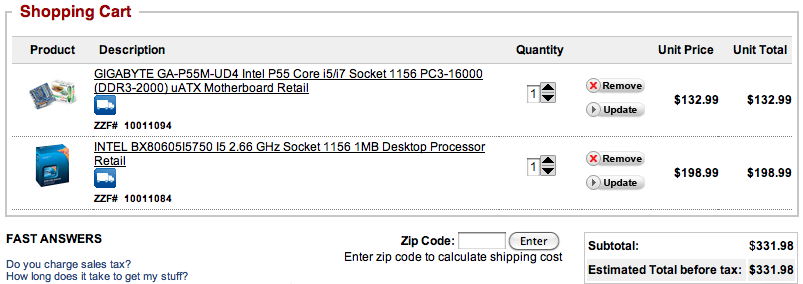

BTW, what board are you looking at for the i5?
http://www.newegg.com/Product/ComboDealDetails.aspx?ItemList=Combo.246589

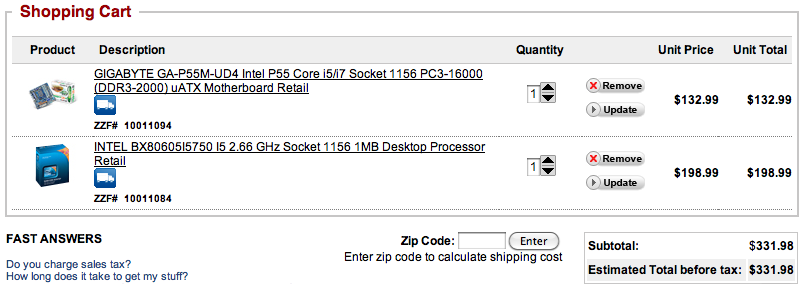

ZipZoomFly has a better deal on a GA-P55M-UD4 combo though. The launch day combo NewEgg had was $334.98.
It might be nice to have a couple of additional slots, but given the cost of the board, nothing to complain about. Put the optical drive on the PATA port, and that still leaves you all 5 of the SATA ports if you need them. Same count for HDD's/SSD's as an '09 MP Quad. 😉
And way less money. 😀
BTW, the newegg link is showing $304.98, but no idea of S/H.
