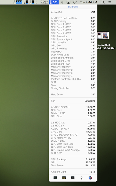

To correct my earlier post, my Prime95 test reached 55C for CPU Proximity, the default in iStat Menus. CPU Cores went to (at least) ~92C. I'll attach a screenshot I took around the peak of heat, but it was more or less an off-hand test.
Yes, that sounds about right. As mentioned, with Handbrake h.265 encoding, It'd very quickly hit 91-100C with the 7700K, and the fan would be pegged at max.
Proximity is more meaningful for MacBooks. On iMacs, at least this generation, the individual CPU cores heat up much faster while the proximity sensor doesn't pick up the trend close enough. The fans on the other hand are reacting directly to core heat. I used to leave the proximity temp as the menu bar icon for iStat Menus on MBPs and Minis, but for this iMac I am using the fan RPM instead, which is a more useful indicator of heat activity and it takes less space than listing 4 double-digit temp in degrees. (I wish iStat has an item for average core temp).
