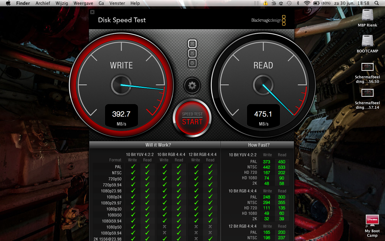

Another Samsung 830 high speed
awsome 🙂 installed with Kingston HyperX 8G RAM, even with bootcamp in Parallels it flies, no beach balls and programs opens in seconds
