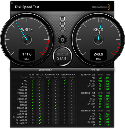

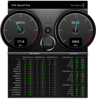

Just installed the 256GB version in my Mid 2009 MBP 13". It's a big different in startup time and application launches from the standard HDD. And the computer is very quiet now.
I guess the measured speed is all right when using SATA II.

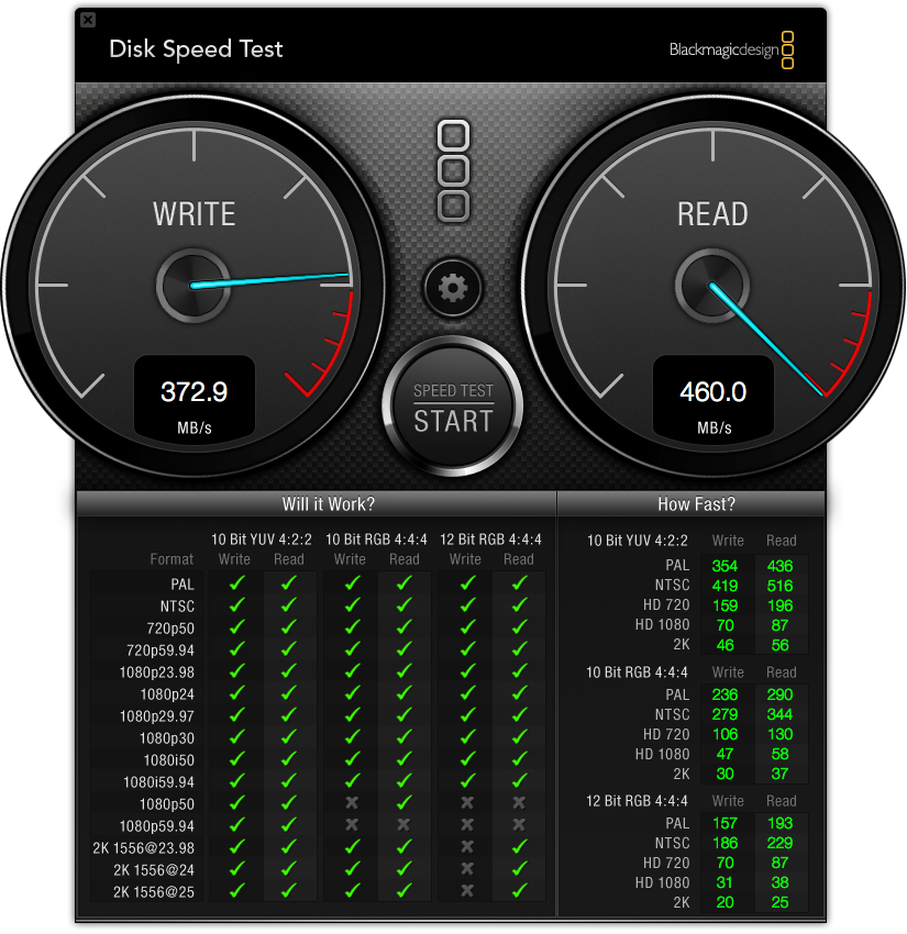

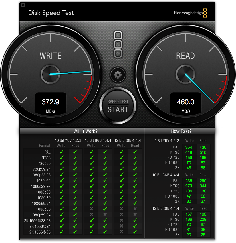

I also got the following speedtest results. Does that look right to you guys?
