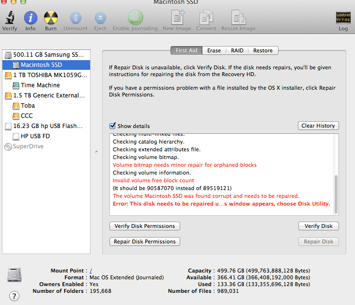

So I haven't even had my ssd for a week and I got this when I ran verify disk in disk utility
SHould I return it?
SHould I return it?
That stinks. Even SSD's are prone to having bad blocks and sectors just like HDD's. It should be repairable though.

That stinks. Even SSD's are prone to having bad blocks and sectors just like HDD's...
In dukebound85's post, Disk Utility is not reporting bad blocks, but only corruption of a portion of the disk directory (orphaned blocks).
So I haven't even had my ssd for a week and I got this when I ran verify disk in disk utility. SHould I return it?
Nothing in the report you posted indicates anything definitely wrong with your SSD. Just let Disk Utility fix the problem by running it off another startup disk, as indicated in the Disk Utility report you posted, and you're probably golden. If the problem keeps reoccurring, then post back, and someone here will help you.
