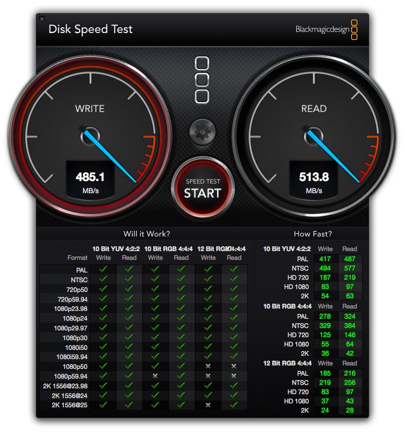

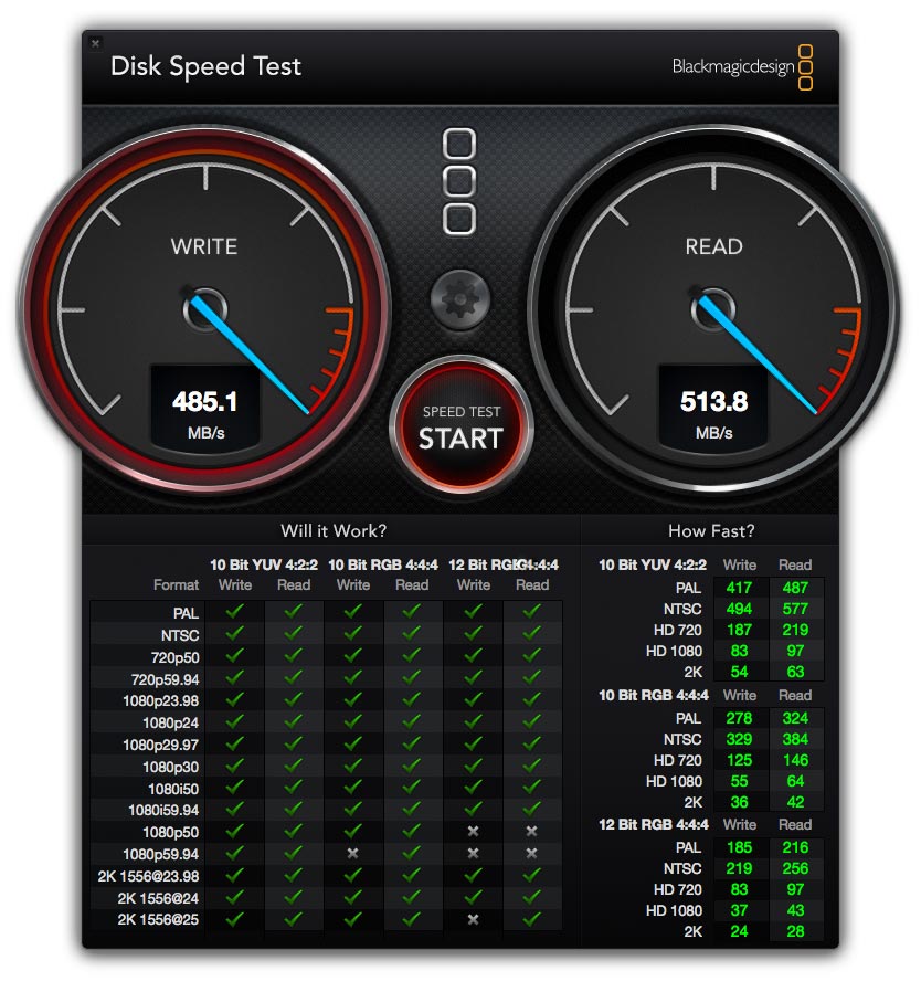

I have a Mid 2012 15" MBP, 16gb ram 2.3ghz i7. With my HHD that came with the MBP (Toshiba 500gb), I was getting 61 MB/s write and 40.9 MB/s read. Start up takes about 35 sec.
But now after I switch to the Samsung 840 SSD, with Trimm enable, I am getting 320 MB/s write and 509 MB/s read, and start up takes 10sec! An amazing improvement! I mean WOW!
