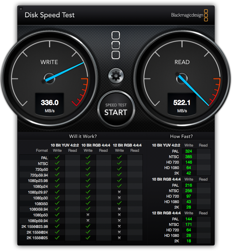

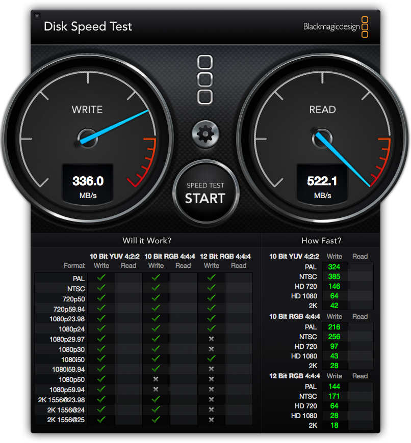

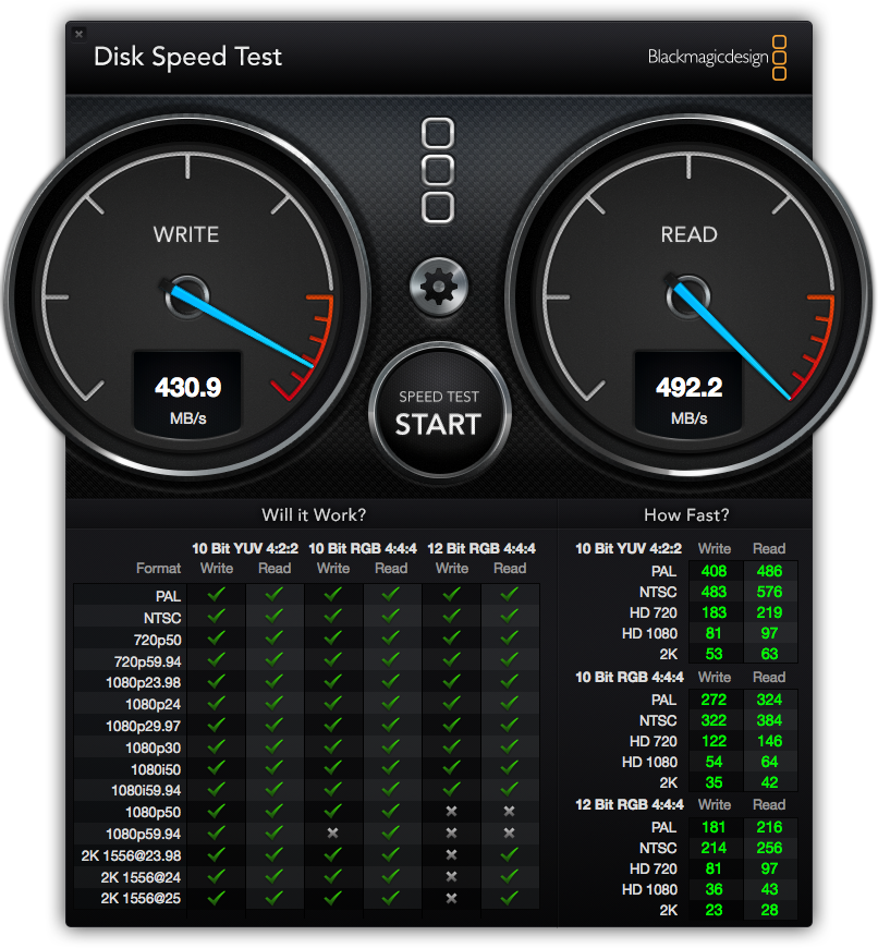

Okay, here are the AFTER results. Not sure I'm using the Disk Speed Test correctly. Does it ever stop by itself or do you have to stop it?
It goes for a very long time. I don't think I've ever let it finish and just stop it after a little while.
Well, based on the results, I'm not impressed with TRIM, in terms of performance. It also didn't yield me any additional space. Is turning TRIM off as easy as turning it on?
Yes turing it off is just the reverse process. Flip the switch to off and restart. However, despite your not noticing a difference, its still a good idea to leave it on to keep the SSD at its peak performance over time. It doesn't harm or reduce any performance by leaving it on.

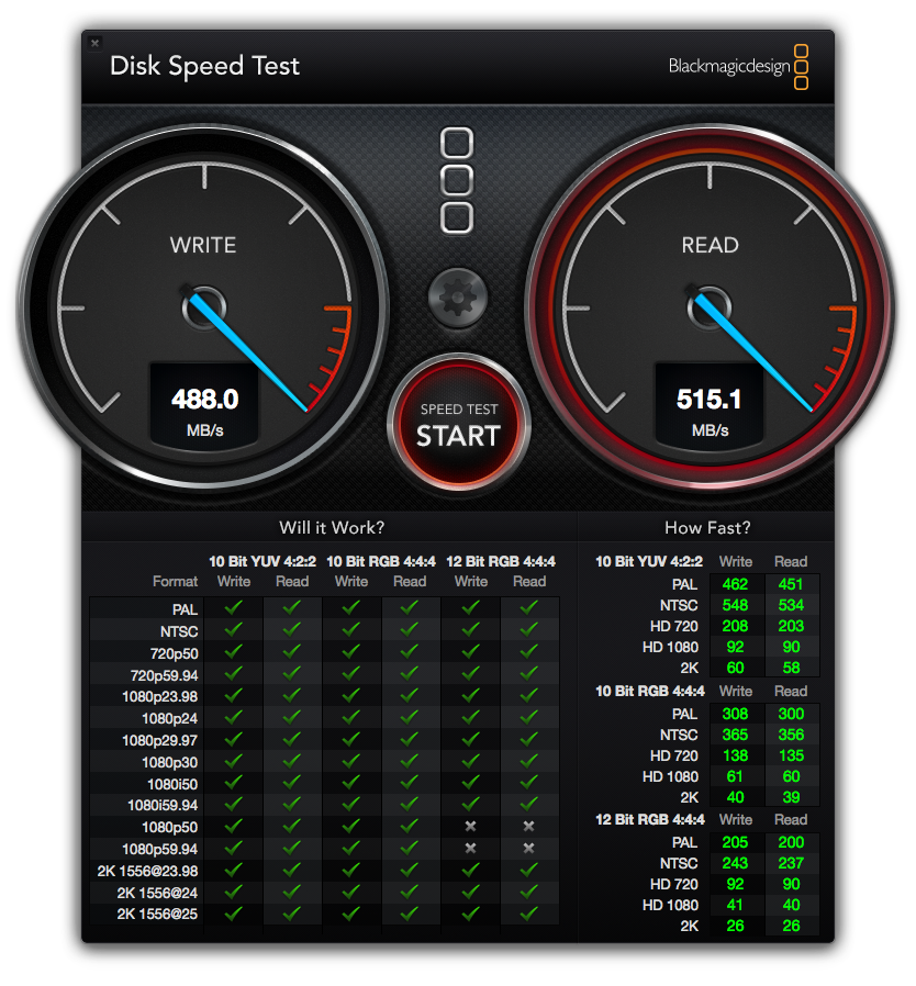

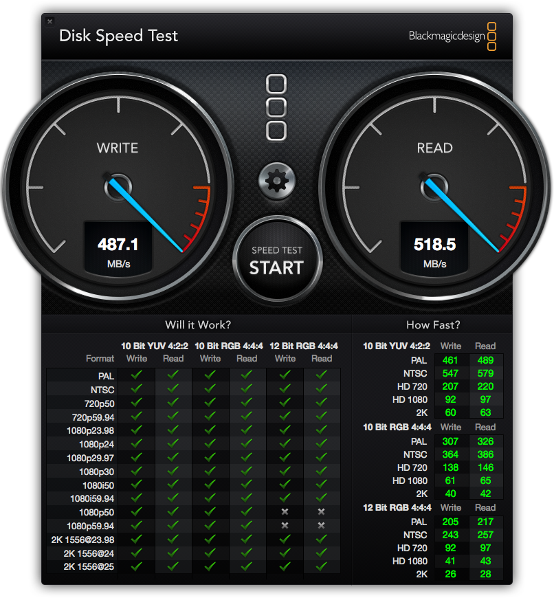

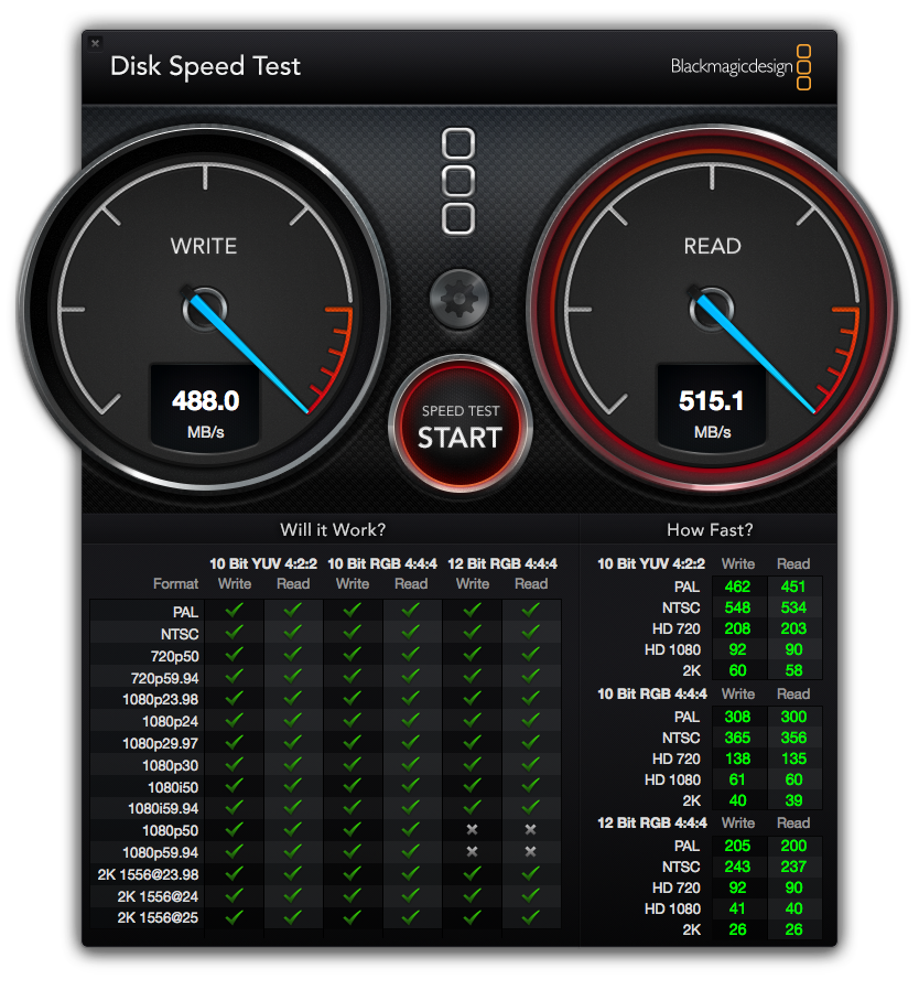

Left image is without TRIM, right is with TRIM.
I wouldn't necessarily let it run all the way unless you really wanted a full test. But the stress level is whatever you feel like running.

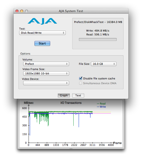

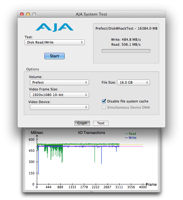

I usually run both the Black Magic test and AJA System Test.
