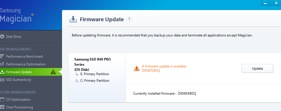

So I guess a new update came out for the Samsung 840 Pro?
I finally got bootcamp so I was able to get Samsung Magician and looked at the update area and it said there is one.
Is this new? Should I get it? Anyone have experience with this? I wasn't aware there was an update. When I installed it in Jan there wasn't one I don't think.

That is current as of May 2013 on the Windows side of the firmware.
http://www.samsung.com/global/business/semiconductor/samsungssd/downloads.html
Would you bother if you rarely used the Windows bootcamp partition? I only did it because I got win 7 for free through my school.
So it has no effect on the Mac side of things and my firmware is current for that?
You should do it. The firmware doesn't have anything to do with the OS. The version is only different because of the delivery method via the OS.
If my thoughts are correct, when you boot back into OS X, you'll see the firmware displayed as DXM04B0Q.
Ahh okay. So just different OS handle the updates different. I just thought since technically it's up to date on the mac side if I shouldn't bother.
I'll boot into Windows and do it
Thanks for the help 🙂

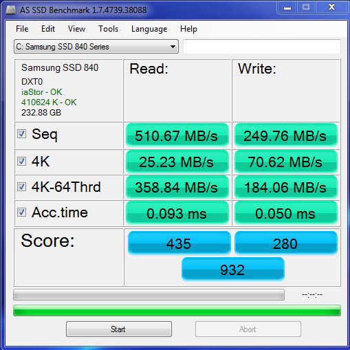

I found a Windows app for testing SSD speed. Here is my 840 256GB:
AS SSD Benchmark

Your non-pro seems to be running pretty good compared to my pro. Not sure what's wrong with the 4K and access times -_-

This one is on my office Dell Optiplex 990 PC. But I also have an 840 in my iMac and an 830 in my MacBook Pro.
I updated the firmware on the two Mac's via the Samsung Mac utility and on the Dell, used the Samsung Magician software.
