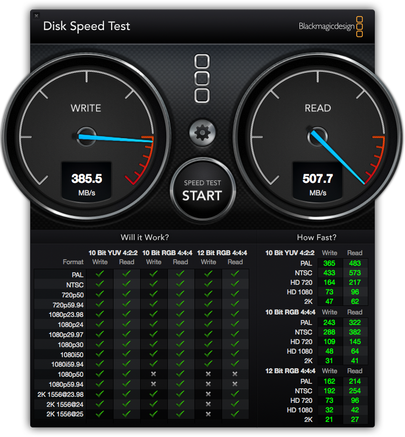

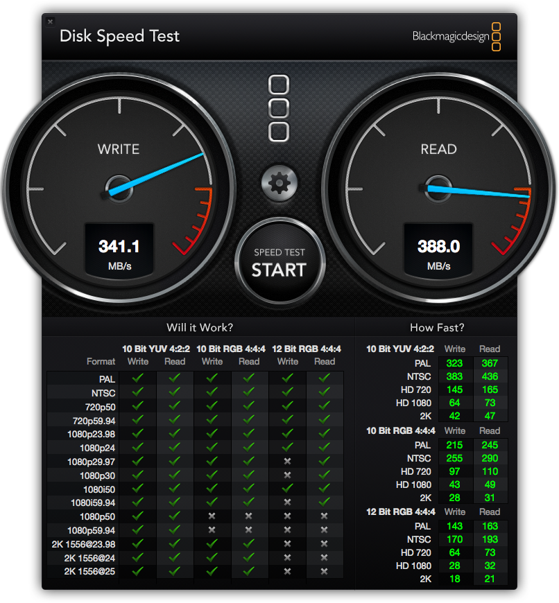

I have my Samsung 840 EVO 1TB SSD in an external Thunderbolt enclosure on a 2012 iMac and get these results (don't have a MacbookPro to try):

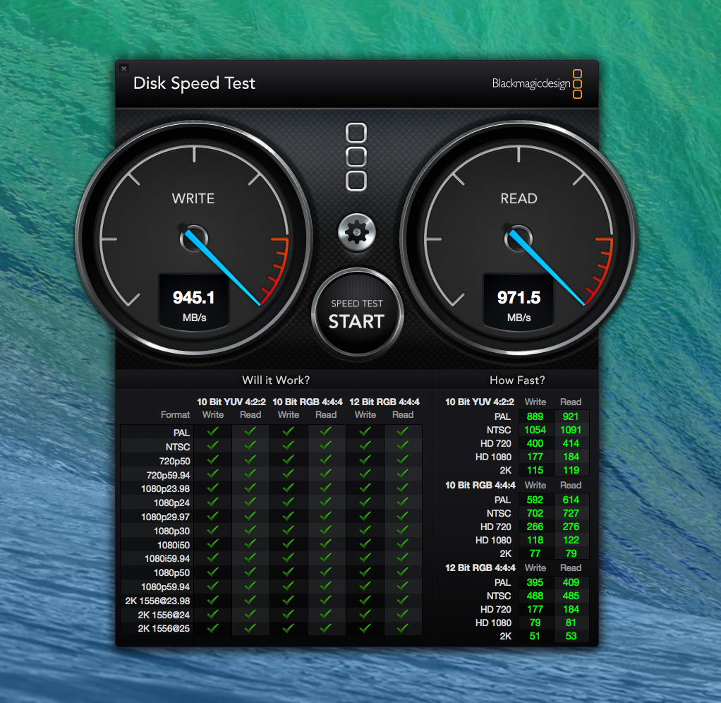

Samsung 840EVO 2TB (Raid0)
A bit off topic. Here's mine, RAID0 Samsung 840EVO (2TB) inside my Mid 2011 27" iMac. 😀
Looks great, may know which enclosure you're using for 840 EVO 1TB SSD? Thanks 🙂
