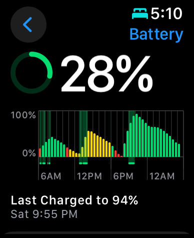

I changed to the Snoopy app and noticed a big battery drain too. I am guessing that perhaps it is on my watch 7 and that might have something too. the battery capacity is 88%, so I turned off the battery optimize so it would go above 80%. I do like the Snoopy and can charge it more often. Maybe when my new watch shows up that won't be an issue.
Series 7, watchOS 10.0.1
Had it up to 94% before bed. When I work up at 5am, it had dropped ~66% (screen off, on my wrist while sleeping).
Yesterday, was on flights in the morning so had it in airplane AND low power mode and the drop was still signficant.

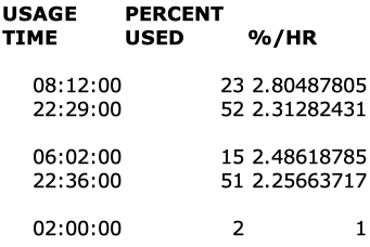

When noticed that battery life seemed to be worse (SE, May 2021), started to track with real number. Was real bad on Friday, but might have leveled out some.
So far today, seeing 1%/hr. The 2.48%/hr value was after using the Timer app a number of times. Did wake up with the Watch at about 5-6% lower than usual (42%) on Saturday, but also did not charge the Watch the day before up to "normal" level (usually around 96-98%, came off charger at 94%, wake-up usually in 52-62% range).
Just removed the Weather widget from the screen, will see if that helps some and have no need for it on the widget screen anyway.
(EDIT: one hour later, just dropped 4%, so now at 2%/hr, which if hold, will be close to normal pre-10 levels)
