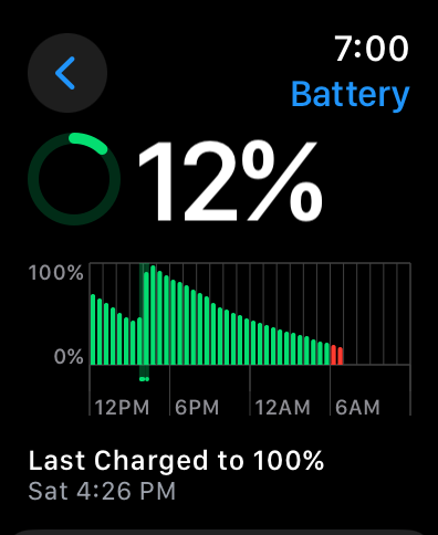

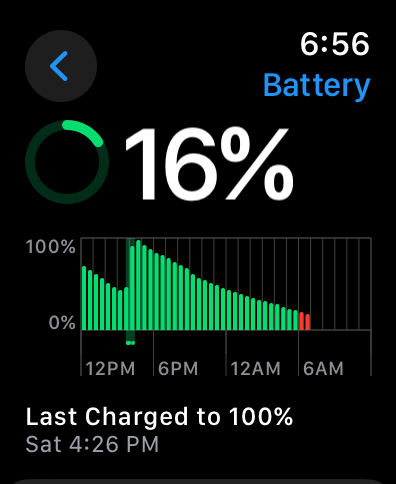

Just picked up a 45mm Series 9 SS last week, and… the battery life is atrocious. Easily on par with if not worse than my 4 year old Series 5 it replaced that had < 80% battery capacity left on it. I haven’t gone through this whole thread yet but is there something I should know? Was down to 16% after 14 hours; 8 hours of that was in sleep focus with the screen off, no workouts recorded, barely any actual use beyond glancing with wrist up. Fell to 12% 4 minutes later after waking up. Feels not good to me?

Watch had 10.1.1 installed on it from the start. It sounds like there’s some sort of issue that might be getting fixed in 10.2? Seems like it’s coming soon since they’re already on beta 4. If that doesn’t solve it then yeah I guess will have this one replaced.
