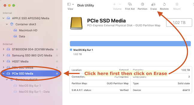

Just for the future can you confirm that you chose "erase volume group" from bottom left whilst in Disk Utility please?
It matters, as if you did that it makes Apple's new instructions wrong.
Thanks.
Nope, I erased those separately, via Disc util tool from recovery options screen. First the Macintosh HD and then DATA partition. Didn't touch "erase volume group"

As far as I can tell people using DU tend to delete Macintosh HD and sometimes the Data volumes. It is my theory that this is not enough. There are more volumes that also need deleting.
"erase mac" in the recovery environment and "erase volume group" in DU and erasing the Apple SSD in DU all do this (or so it is my belief).

The Apple guide that I linked you to said to erase the volume group, not the seperate volumes and I suspect this is why you had the error you had.

The instructions I followed said, "Select your startup disk on the left, then click Erase." Those instructions are linked on the first post of this thread. The new instructions you linked are much clearer. I don't see why they would leave the old instructions up. As long as those instructions are out there, people will probably continue to make the same mistake I made. For people in that state (having erased HD and Data), the instructions in post #26 are valid.
Yes, fair enough.
Unfortunately once they're on the web they can stay there for a long time on google searches.
The original Apple instructions did say that and that is where the mistakes are first made, I believe.
