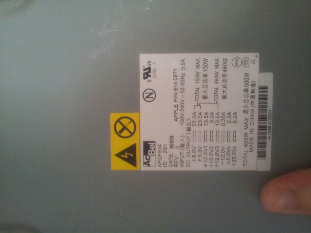

It should be. I think I've seen 450w and 600w ones (my 2.0ghz had a 600w) and I'm not sure what the 1.8Ghz uses.

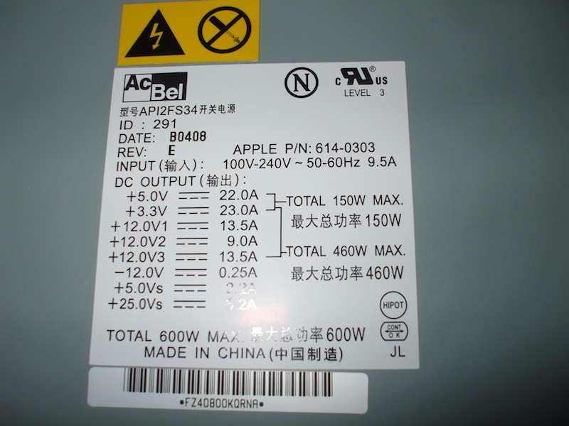

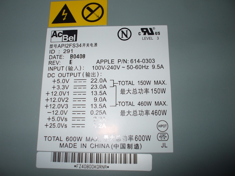

Just check the wattage on them both first. It should look like this
Just look at the max output

Yes. The power supply will only output what is necessary. But if a computer comes with a 600w power supply it may use 450w regularly, so a 400w wouldn't work. But if you stuck a 1000w in it would only use 450w still. That's why it says XXXw MAX output. This is the same with all desktops.
This is true for the 450W and 600w, but with the Late2005's 710W and 1KW they have different connector plugs so they wont fit on the logic board thats not late 2005, but yeah if yours has a 450w you can use a 600w instead it wont fry anything.
