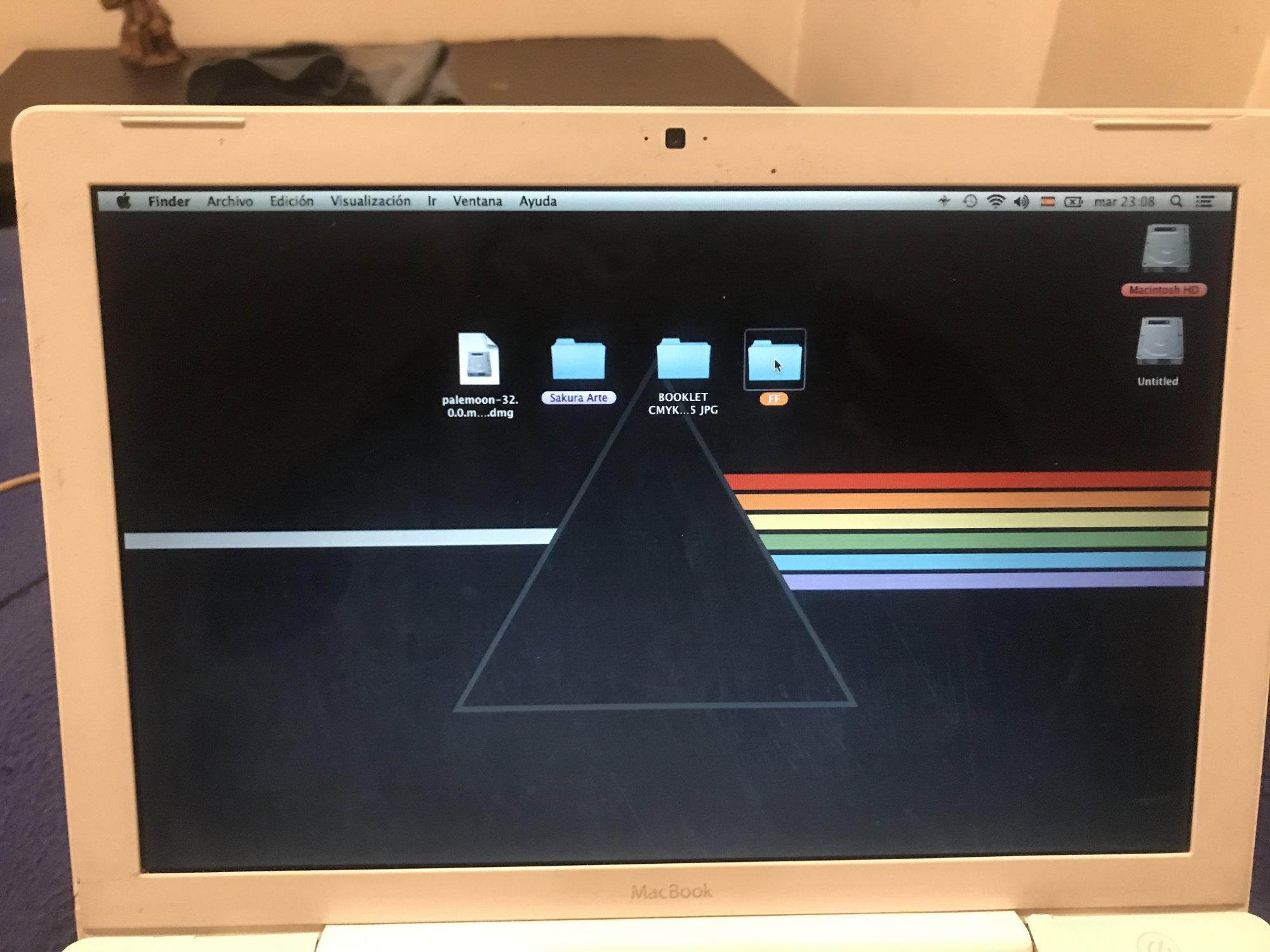

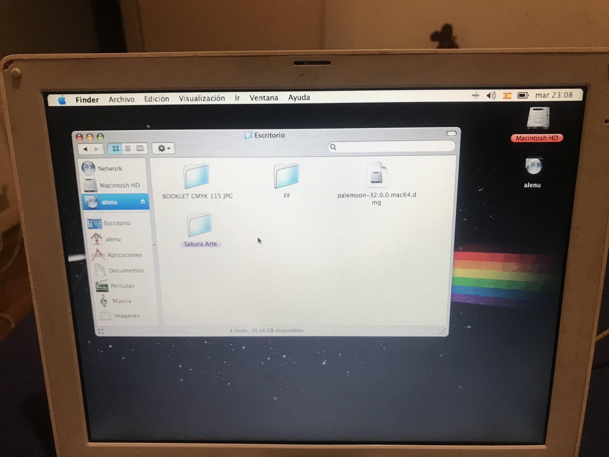

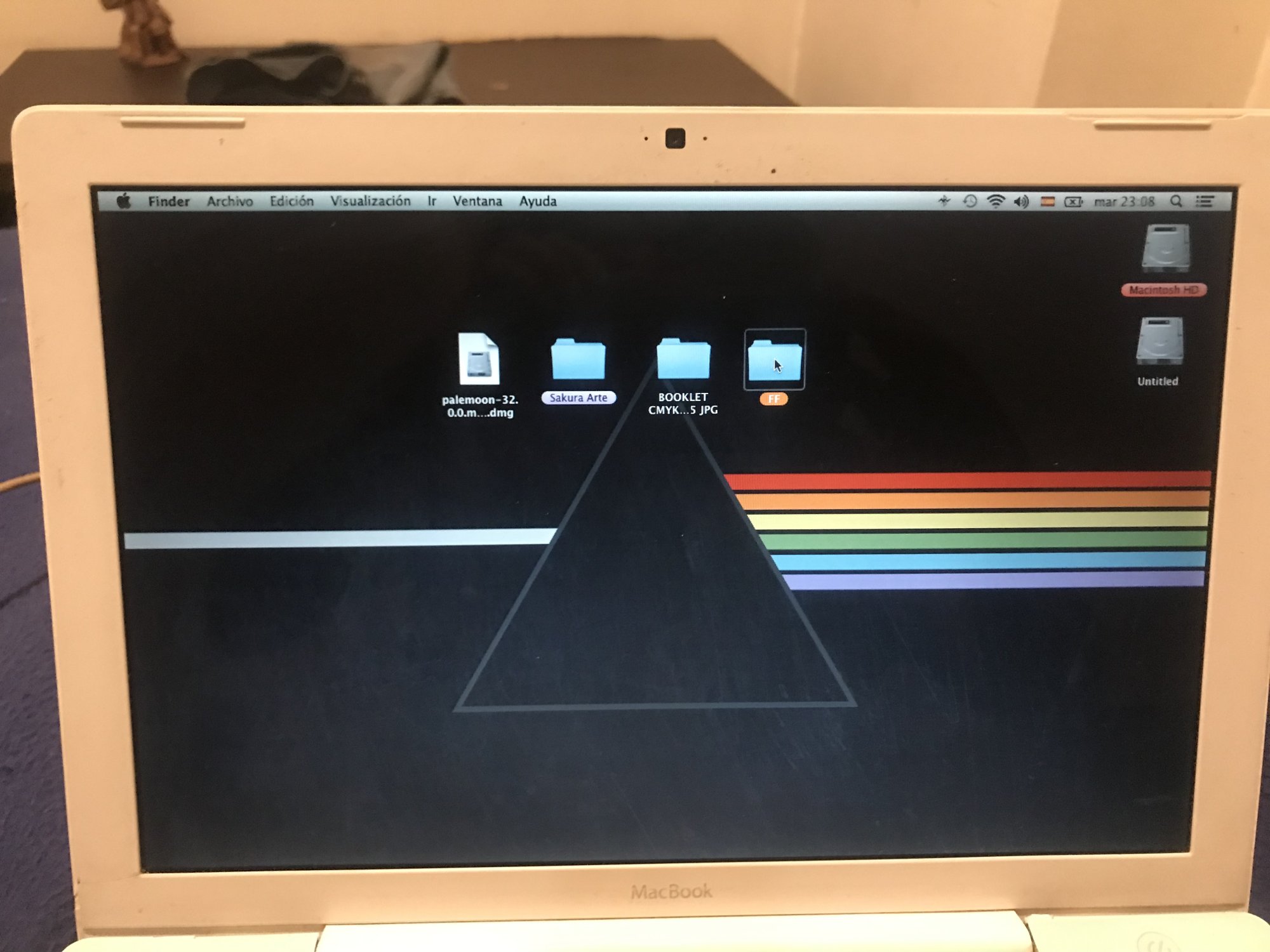

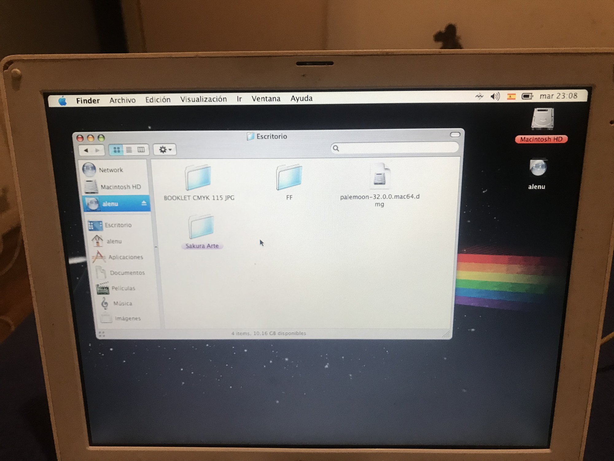

I have four PPC Macs and three Intels, and i´m running several versions of OS X on them, from Tiger being the oldest to Sierra being the most modern. AFP connections works between all of them and i use it all the time for sharing files. Screen sharing works too. You said "every time I try and type my username and password". Are you typing the target computer username and password, right? Maybe this can sound a little silly, but i remember i didn´t knew it at the time. Also, you can try typing the name of the target machine as it appears on your router´s configuration menu. Example: My Sierra MacBook is called snowhite. If i try to mount it on one of my PPCs using afp://snowhite.local, it will fail. I must use afp://snowhite.fibertel.com.ar instead. I don´t know why. This applies only for mounting an Intel Mac drive on a PPC. From Intel to Intel, or from Intel to PPC, you´re fine using just thecomputername.local
Here you can see my 10.8 MacBook´s home folder (alenu) mounted on my 10.4 iBook G4. The MacBook´s desktop folder window is opened on the iBook and you can see the same files showing on both computers.
View attachment 2158773 View attachment 2158774

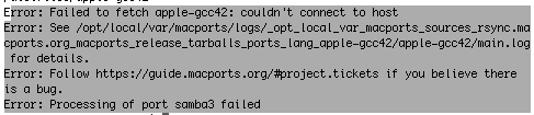

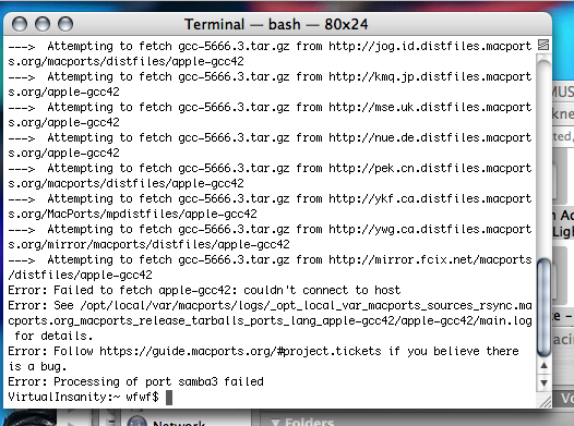

Every time I try to install Samba3, this comes up:
Am I missing a file that I need to install/download from MacPorts, or do I need to update something? I'm not sure because I'm new to using Macports to install things, and for using it in general.

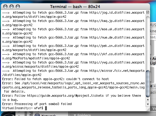

Are you, by any chance, running Little Snitch or the Apple firewall option under System Preferences > Security?
What this looks like, just from this screen cap alone, is macports cannot get online to download/fetch anything. This means macports is being prevented from reaching a network connection — whether by something configured on your iBook or on your router. I suspect it’s something set and long ago forgotten on your iBook, not your router.
Even if, ultimately, you don’t end up tinkering with samba3 from macports, there are still many other ports you may, in the future, want to install on your iBook. To do that, macports is going to need to find a way to connect to the internet.

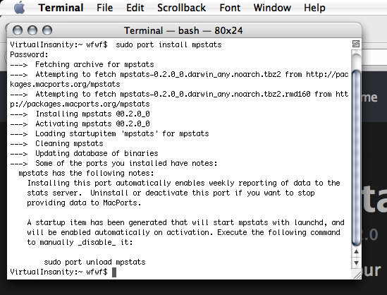

This got me wondering what is actually required to replace Apple's daemon with samba.org's. I suspect you're referring from the client perspective which I also have no idea how you would do, but was curious from the server perspective. From what I can tell, it's relatively straight forward. I stumbled across this nugget from someone doing just that on 10.7 and it is pretty easy to modify for use in Leopard. I don't have a Tiger machine to try this out with, but it does seem to work on Leopard in my initial tests!
I'll fork this when I get a chance and put in the Leopard code that works with the Macports defaults.

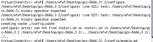

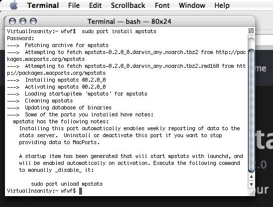

I have the MacPorts version (2.8.1, I believe, the most up-to-date version), and the XCode Tools downloaded (for Tiger, and it's on Tiger 10.4.11). Both are running fine, but Samba just won't install for me.
@VirtuallyInsane Can you install any other ports via Macports? It's possible those files for apple-gcc42 really aren't available on any of those servers, though it is unlikely. I've also seen odd behavior like that if the Portfile has a line that isn't properly terminated, but that is also unlikely.
EDIT: You actually might get a 404 error instead of "couldn't connect to host" if the files aren't there, I'm not sure off hand. If so, that would seem to indicate you really do have something (like a firewall) blocking the connection.
Which ports/programs work with Mac OS Tiger? Shoot me some and I will download them, give them a go and report back. (I've been busy, that's why I haven't had a chance to reply til now).

Yeah, I was busy again today lol but oh well.
Is your signature up to date? I thought it said that you had one on 10.4. Well anyway, I installed it and it looks like it installed perfectly:
Maybe the problem is that the files are down/deleted. I tried Samba again, but to no avail:
Failing to connect to the host makes me think that the files were changed, if I can download "mpstats" and have to it run successfully.
Ah, excellent you were able to get it installed! At least you know you have a functioning Macports installation now. You can uninstall it of course if you want, I just wanted to see if it worked at all. Curiously enough, I picked the first URL in your screenshot for apple-gcc42 to see if the files were actually there, and well, it looks like they are. So I'm not entirely sure what's going on, you could try to manually download the files and place them on your machine for Macports to utilize, but it might become a pain to do that if there are a lot of dependencies for Samba3 on Tiger and they also fail to fetch. I suspect they won't fail though, since mpstats worked. Hard to say without trying it.
One more thing you could try to narrow it down: see if you can get to the distfiles directory from your browser (http://jog.id.distfiles.macports.org/macports/distfiles/apple-gcc42/ or any of the other ones from your screenshot). If not, then something on your network or your machine are very likely blocking the connection. You could also try to curl the file(s) from Terminal. If all that works, then there might be a bug in the Portfile, but I'm not the resident Portfile expert so if that is the case you'd probably need some help from the other folks.
At the risk of overstating the previous discussion, samba3 really won't help you connect to other modern file shares from your Tiger machine from Finder, but it will give you a command-line utility to do it (i.e., smbclient). So if that is not your goal, getting the port to work is a bit of a dead end anyhow.
Yeah, at least I know that Macports works in general on this iBook G4 (I'm typing from it right now using TFF because I'm at the iBook). I might uninstall it, I'll see. Maybe sending back error reports to the program isn't a bad thing at all, lol. It might help them, actually.
I downloaded the files, and I opened them on the desktop and ran them, but nothing. It's strange that I can download the files, but not get them from the host. And when i download the files and try to install/run them, I get more errors:
Why would the "install" files not be included within the package? They should be there, if it is a package ready to install. I tried "enable" as well, but more errors. There could be a bug, maybe. And fair enough, thank you for trying by the way.
And yeah, even if I get a command-line utility, that's better than nothing. I might just end up installing DAVE like eyoungren had mentioned earlier at this rate. Looks like it might end up being the most feasible choice.
There's probably a better write-up on this somewhere, but here's my version.
Unfortunately (but also fortunately for us pre-Intel Macers wanting modern software) it's not so simple with Macports as downloading an archive, extracting it, and running its contents. There's a lot to Macports and that complexity is what lends itself to being flexible enough to accommodate porting a huge library of software across the huge swath of MacOS 10.4+ (crazy!).
At a high level, Macports uses a Portfile to define how the source code for every port should be utilized on specific CPU architectures and OS versions. For newer versions of MacOS, it downloads and installs ports for you. But it takes care of passing all of the necessary arguments/switches/flags to the compiler/linker/etc when building from source. It takes care of acquiring and applying patches. It manages all the dependencies. It takes care of, well, pretty much everything.
Long story even longer, the archive you downloaded is somewhat useless outside the context of the Macports program. Sure you could use it, but you'd have to manually take care of all the things I mentioned MP does. When I was suggesting manually downloading the archives for Macports to utilize, I was referring to placing them in the local cache that Macports uses for downloaded files to essentially tell it "hey look, the files you wanted to download are already here". If you're using the default MP installation settings, you'd put the archive you downloaded in " /opt/local/var/macports/distfiles/apple-gcc42/" and then rerun "sudo port -v install apple-gcc42" and see what happens. But be warned it can get messy doing this, and if Macports has trouble finding any of the other dependencies of samba3, I'd say it's probably more trouble than it's worth. It would likely be easier to figure out what's going awry with MP's ability to download files at that point.
A few more tidbits: I mentinoed that for newer versions of MacOS, it will just download the port and install it. But there is no build bot for 10.4 or 10.5 in the official Macports repository (as I learned from the other folks here) so you can't grab pre-compiled binaries. Anything you want from Macports on a PPC machine will have to be built from source code, which Macports is quite capable of handling provided everything is correct. Macports doesn't accept bug submissions for 10.4 (someone correct me if I'm wrong), so even if it is bugged, I don't think you can submit a ticket to ask for a fix.
