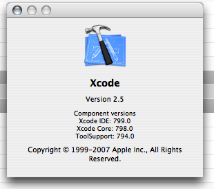

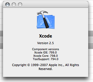

p.s., And the version of Xcode you’re running is 2.5, yes?

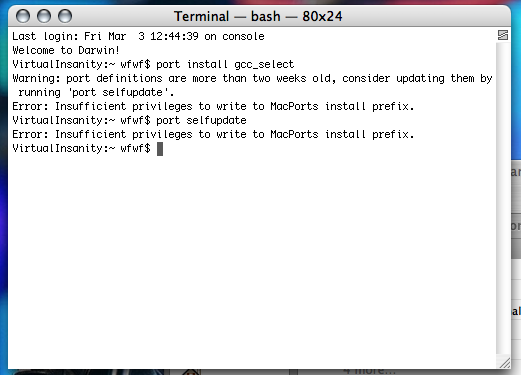

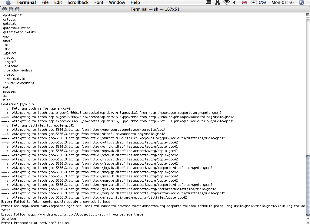

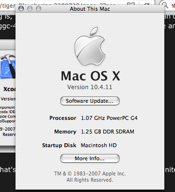

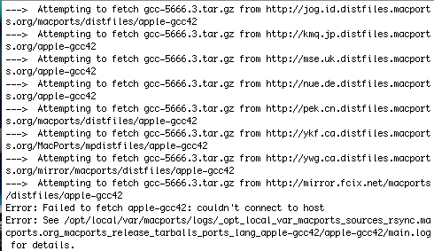

Sorry it took me so long. I just got my WiFi Card today. Here is the error message when I try and install gcc_select:
This is what I get. Samba is still not installing.

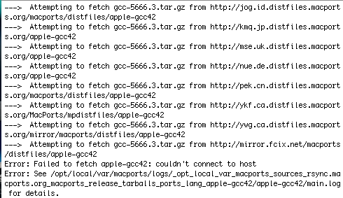

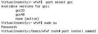

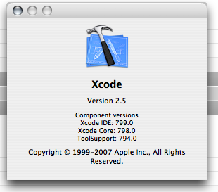

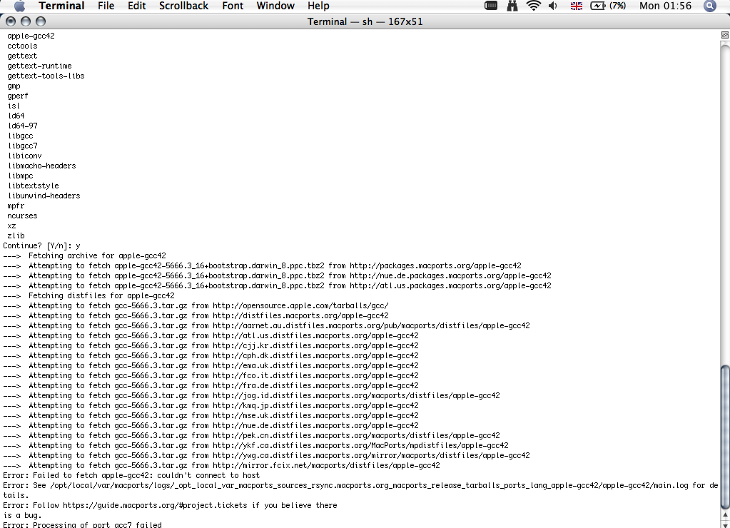

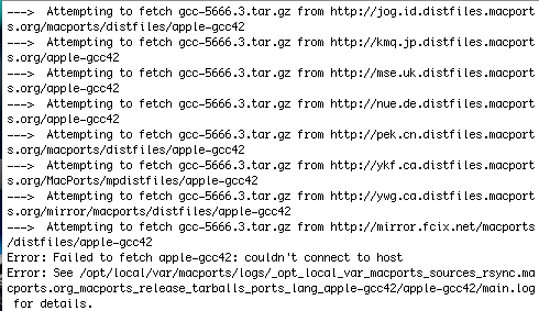

Hey, thanks for getting back to me. I checked the files, and it comes back like this. The gcc files aren't there, (well the ones that we need aren't). It's downloading some of them, for some reason.

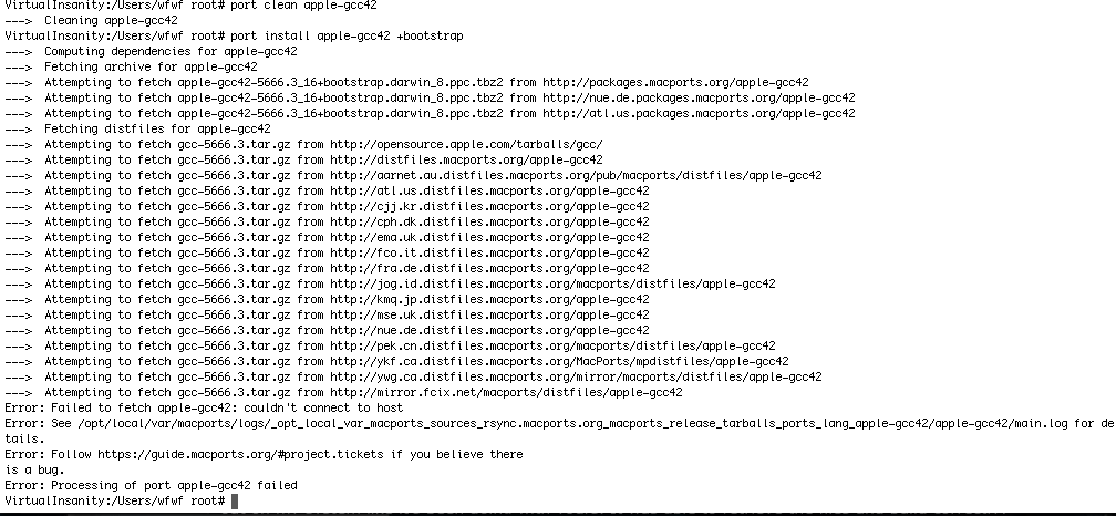

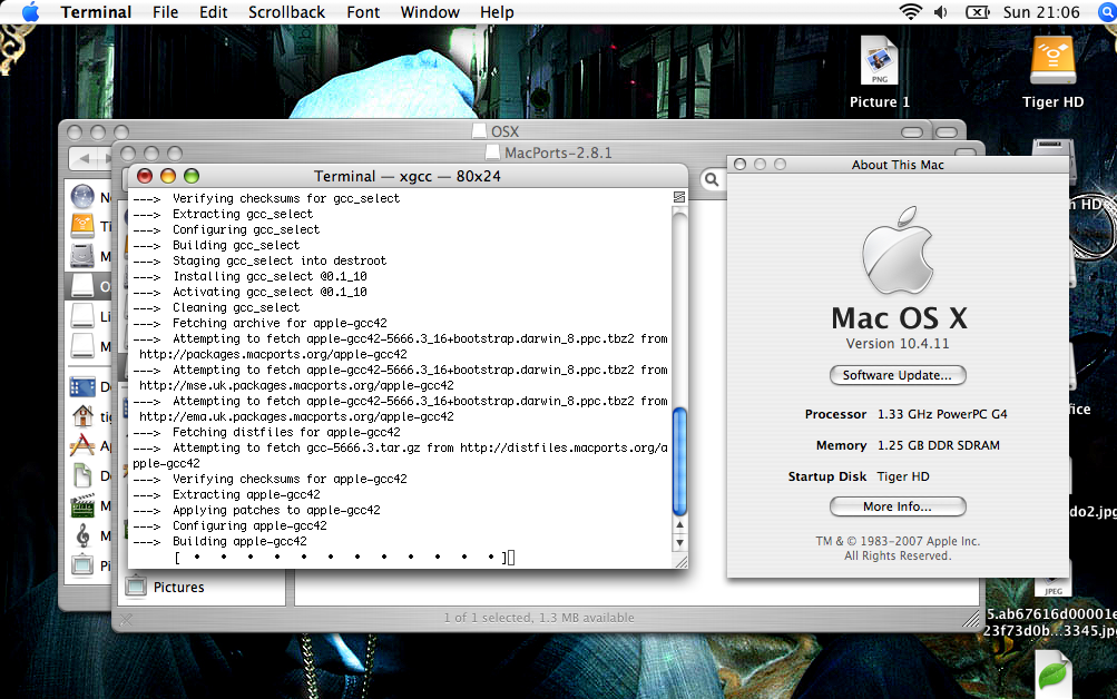

So, I logged into the root, and I ran samba3 to see if it would install the gcc42 files and I am still getting errors:

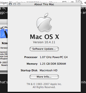

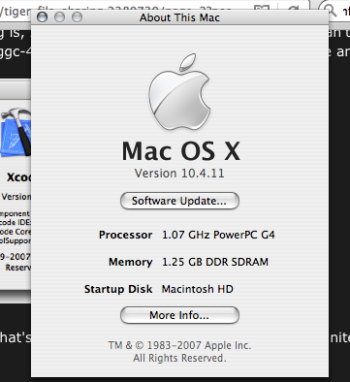

The weird thing is, I can download the files from online but I can't download the samba 3 port at all, even with the ggc-42 on my computer. Everything is up to date and I am definitely on XCode 2.5:

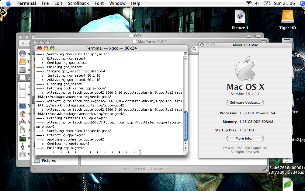

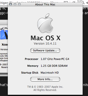

I don't know what's wrong at all. It has storage left, and is definitely running Tiger.
Macports is up to date, I did that earlier today as well.
Aside from Samba, I am wondering if anything else is up with Macports on Tiger for the iBook. It's actually quite a capable machine for being so old if you don't push it too far. It plays music well, runs Word, can play Games, can connect to Localhost, run a few apps and browse some of the web. I am writing this reply on it rn.
Or maybe some things genuinely aren't available on Tiger. I could also try this process with my iMac G5, on Leopard. See if that downloads. Or maybe I am doing something wrong that you can detect. I've been trying to get Macports to install this darned thing for the past month now.
I know eyoungren told me to install DAVE, and I will soon, but I still want to fix this Samba3 issue first to see if I can to ensure that Tiger Macports is still running to the best of its ability. I'd like it to be. It's a very useful tool (I have it on my MBP 09 running SL, and sometimes Lion from an external enclosure).

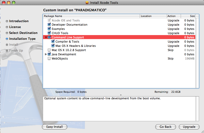

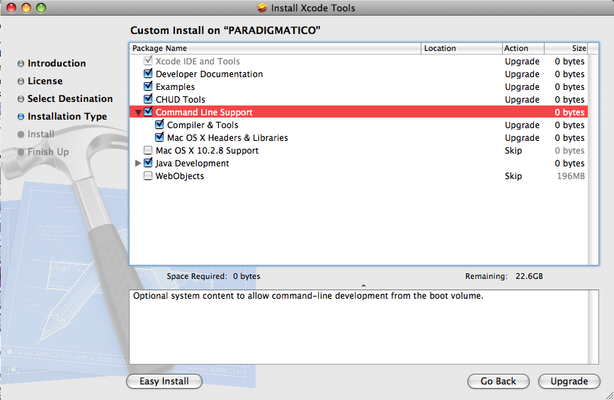

Separately, go ahead and try re-running the Xcode 2.5 installer again — except this time, on the step after selecting the target volume but before the “Upgrade” button, click on the “Customize” button and check to make sure the “Command Line Support” checkbox is selected. (It’s possible this was installed previously and will show a size of “0 bytes” now.) If for whatever reason it wasn’t previously, go ahead and select it now for installation.
For example, this is what I see when running the Xcode 2.5 installer on my Tiger G3, which already has Tiger 2.5 and all options installed previously (save for the 10.2.8 support and WebObjects):
[A note about installing Xcode atop the same version of Xcode: you can do this and it won’t break anything from before; if the installer finds anything was amiss from the previous install, like a moved or modified file, it will correct the problem with the “Upgrade” button step.]

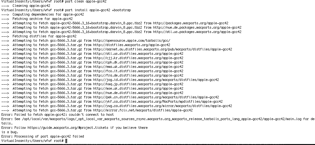

Reinstalled and checked that Command Line Tools were installed. Updated Python. Checked everything was up to date, and I got as far as gcc7, which refuses to install because I need gcc42, apparently. Gcc42 refuses to install, no matter what I do. I can't install anything with it in it because it point blank refuses to download from the servers.

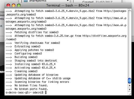

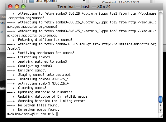

Last night, I managed to install Samba through Macports on my iMac G5 running Leopard no problem. Took a while, though:

It can fetch files fine though?
Reinstalled and checked that Command Line Tools were installed. Updated Python. Checked everything was up to date, and I got as far as gcc7, which refuses to install because I need gcc42, apparently. Gcc42 refuses to install, no matter what I do. I can't install anything with it in it because it point blank refuses to download from the servers. View attachment 2168870

OK. Try this, as root:
port clean apple-gcc42
Then,
port install apple-gcc42 +bootstrap
For what it’s worth, I already had apple-gcc42 installed on my Tiger G3 iBook, but I went ahead, deactivated it, and installed it again — except this time with the +gpl3 variant selected, just to see whether it would error out on my system like it’s been doing with yours. It was able to retrieve the files and build correctly:

Could somebody here with more Macports backend insight (paging @barracuda156 @wicknix and other folks, if any of you have a moment to put minds together!) try to hypothesize what in particular is causing @VirtuallyInsane ’s G3 (running macports in Tiger) to divert in a different direction (i.e., to a g-zipped tarball) from my G3 running macports on Tiger (which looks for a patch instead)?
[note: the +bootstrap flag I suggested VirtuallyInsane to tryisn’t relevant here, as the same erroring is happening with their Mac regardless of that variant.]
Mine:
---> Attempting to fetch apple-gcc42-5666.3_16+gpl3.darwin_8.ppc.tbz2 from http://mirror.fcix.net/macports/packages/apple-gcc42
---> Fetching distfiles for apple-gcc42
---> Attempting to fetch gcc-4.2.1-4.2.4-v2.patch from https://svn.macports.org/repository/macports/distfiles/apple-gcc42
VirtuallyInsane’s:
---> Attempting to fetch apple-gcc42-5666.3_16+bootstrap.darwin_8.ppc.tbz2 from http://atl.us.packages.macports.org/apple-gcc42
---> Attempting to fetch gcc-gcc-5666.3.tar.gz from http://opensource.apple.com/tarballs/gcc/
This one has me stumped, especially for something as legacy, stable, and established as apple-gcc4.2. Cheers!
What is the problem though? tar.gz is a correct source: https://github.com/macports/macport...ef92e029a8ecefa/lang/apple-gcc42/Portfile#L45
tbz2 is pre-built port.
Obviously, either Macports is set to build from source always, or non-default prefix being used, or asked-for port variant does not exist pre-built.
If download fails however, then it is worth reporting on https://trac.macports.org
Do other ports download normally? It works for me right now:

P. S. Please make sure you use Macports 2.8.1 and do sudo port sync. 2.8.0 was buggy.

I also tried to use tiger.sh and the gcc 4.2 package downloaded fine, and it is working but when I try to install Samba3 or apple-gcc42, it refuses to install it because it needs that specific apple-gcc42 file from apple online for some reason. It just refuses to download it, and MacPorts is up to date, and all the ports are up to date.
It just won't redirect it for some strange reason.
Yes, AFAIK.
Yes, it is up to date (2.8.1) and everything has been synced/updated, all the ports are updated, and there are no updates needed to be added. It just keeps circling the same cycle and refusing to connect to the host for some reason.
I have tried numerous methods, and every single thing is up to date.
I'm not sure what I am doing wrong.
Everything is set up correctly.

If the purpose is tenfourfox, then it is as easy as https://ports.macports.org/port/tenfourfox or https://ports.macports.org/port/tenfourfox-devel
I have no idea why download fails though, it should work. The author may open a ticket at Trac and get help.

So...how did that work out?
I just built Samba3 on my mini G4 and the only thing different is that now an alias shows up in Network in Finder but when I click the alias it just says "original location not found". Connect to server just ends with "password isn't correct".
Since 10.4 is [still] an officially supported system, if the port does not work, please open a ticket at https://trac.macports.org
Pretty sure it's working. No errors or broken files. I just wish there were, you know, like a basic user manual for Macports but I can't even find out what Samba3 looks like or how to use it based on whatever github says, which is just as sparse. The description is along the lines of "it makes your system work with Samba 3". Compelling.
Anyway, I use findsmb in terminal and the only thing that shows up is the G4 itself. I can ping the Mac that is hosting.
99% of the time I try to Connect to Server it ends with "name or password may be incorrect" and the only time it doesn't end with that it says "can't connect because some data may be read-only".
