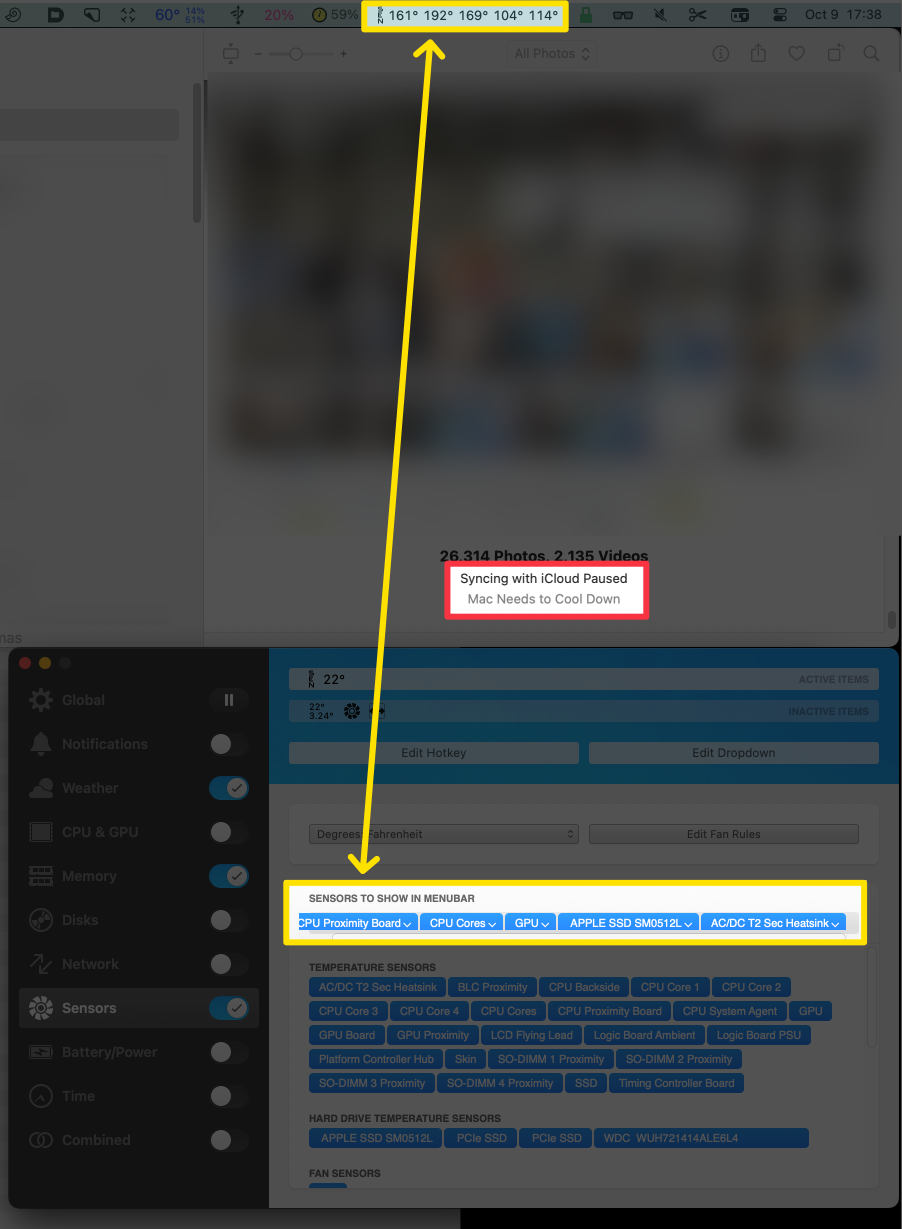

Incidentally, my Time Machine backup is working, but since upgrading to Sonoma, I'm suddenly getting Syncing with iCloud Paused Mac Needs to Cool Down errors. And as is apparent from iStat Menu temperature sensors, nothing is especially hot.
