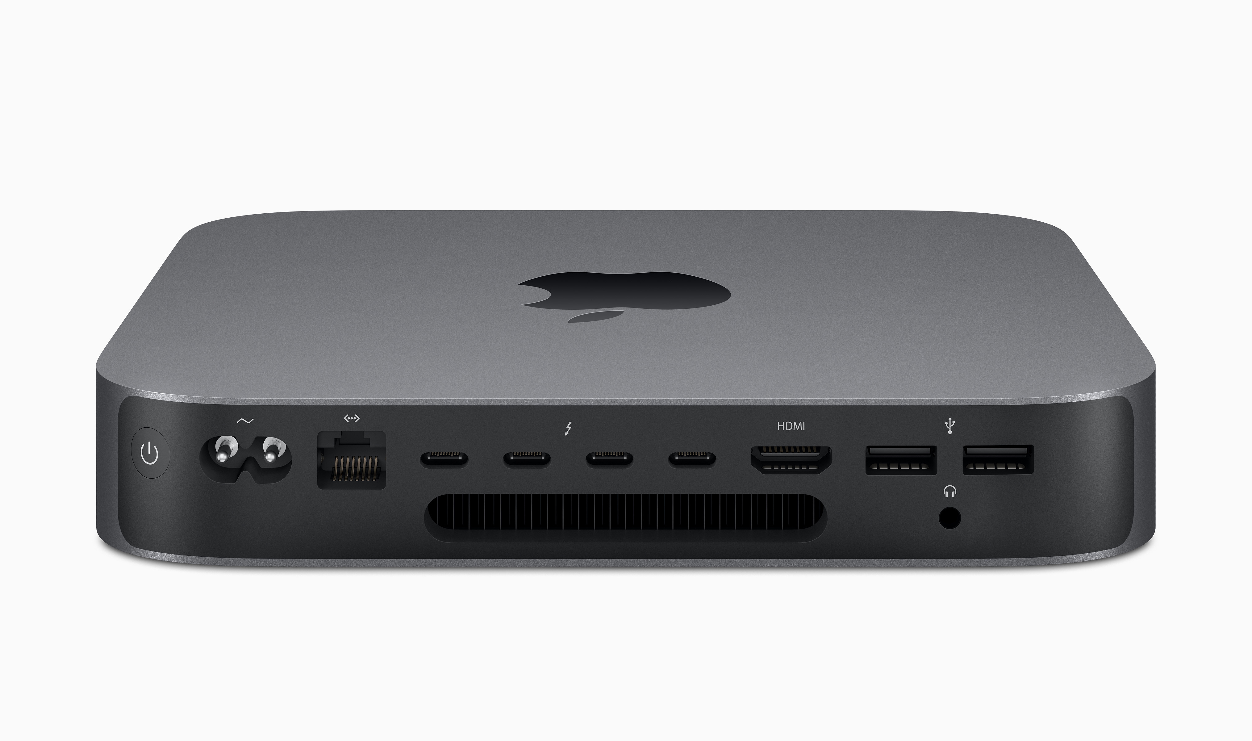

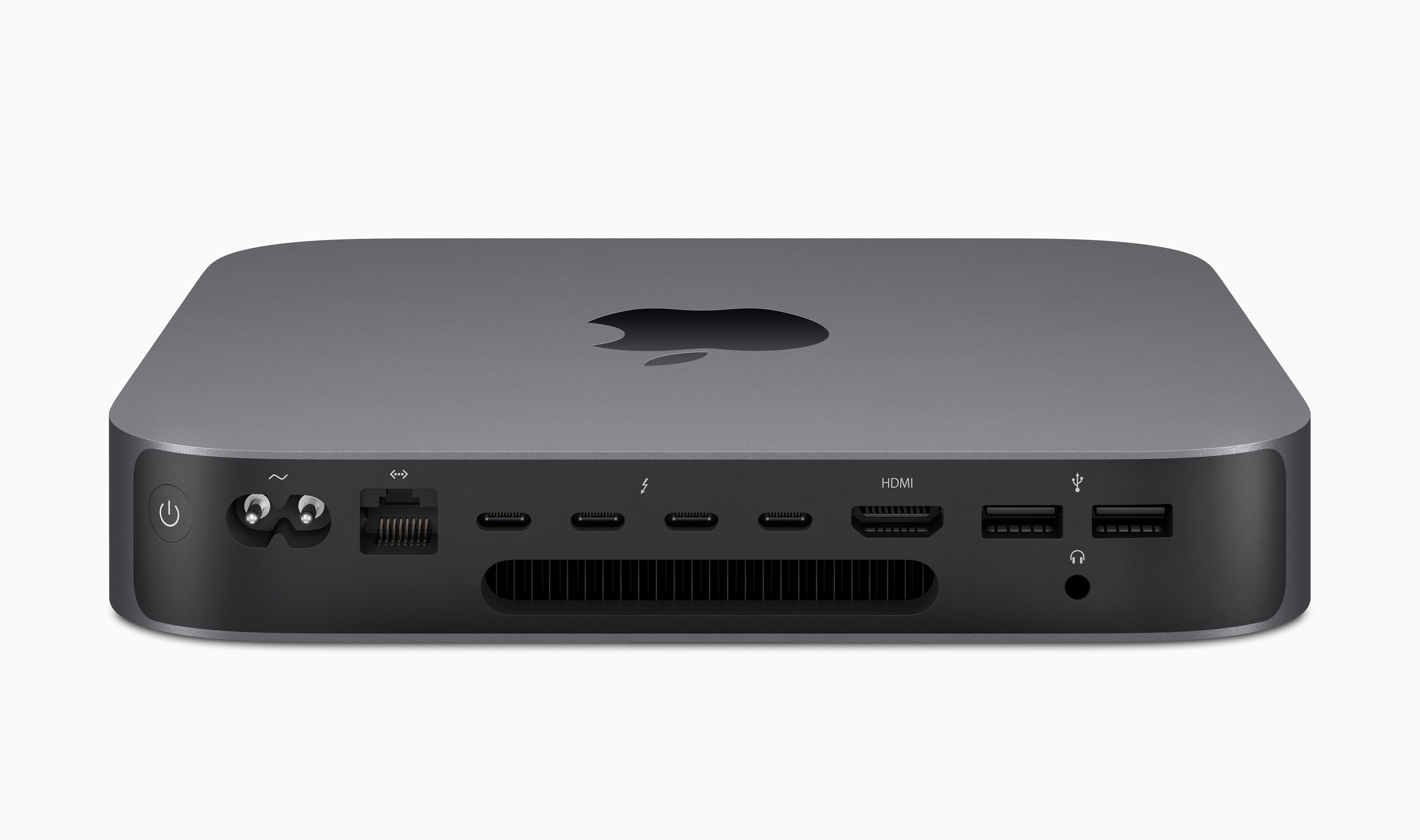

In looking at the specs of the 2018 mini, I notice the absence of optical audio. I use optical to connect my current mini to the stereo and would hate to lose it. Yes, i could use HDMI, but my TV panel doesn't have ARC, so I can't drive it as a monitor AND have audio at the same time. 🙁

I asked Apple sales support over chat about this yesterday. They told me that the 2018 mini does still support digital audio out through the 3.5 "headphone" jack with the use of a minitoslink adapter. I'm assuming that is what you are using now. I'm also using one currently with my 2011 mac mini and would hate to lose it. Often you have to take chat answers with a grain of salt, so I'm wait for a more solid confirmation before purchasing.
Monoprice has a couple on inexpensive options if you don't already have one or need another.
https://www.monoprice.com/search/index?keyword=minitoslink
Otherwise, it will take some type of USB audio interface to get the digital signal to by-pass the internal DAC so you can send a digital signal it to an external DAC.

Apple has been dumping optical from its audio out ports for a few years. Now that the Mini is finally(!) being updated, its audio out is next. They make USB to SPDIF-Toslink adaptors, and it sounds like this could solve your problem. I do not have experience with them, but perhaps others here have.
The problem with this is that going through the USB interface causes issues with timing, and reclocking of digital audio signals. This introduces jitter in the bitstream which becomes audible as aliasing and sibilance. USB audio can be made to work well with independent clock crystals on the converter but proper converters usually start at about $150. For high quality audio applications it would have been far more convenient to use the onboard optical that has low BOM cost impact then having to add a $150 dongle.
The problem with this is that going through the USB interface causes issues with timing, and reclocking of digital audio signals. This introduces jitter in the bitstream which becomes audible as aliasing https://www.soundmaximum.com/best-usb-dac-under-100/ sibilance. USB audio can be made to work well with independent clock crystals on the converter but proper converters usually start at about $150. For high quality audio applications it would have been far more convenient to use the onboard optical that has low BOM cost impact then having to add a $150 dongle.

Anybody have any thoughts on the behringer uca202 as an inexpensive option
http://www.musictribe.com/Categories/Behringer/Computer-Audio/Interfaces/UCA202/p/P0484
I know it is primarily designed for getting analog music into your computer, but I've read it also works the other way to convert usb to toslink as well. I think they're only about $30 and probably not to be confused with high quality audio, but it does seem one inexpensive way to get a digital signal (optical) out of the new mini if optical out is not supported over the 3.5 jack.
You wouldn't use any of the RCA Jacks (for this purpose) on the UCA202, just hook usb to computer, optical cable from the UCA202 to your DAC and adjust the necessary settings in the apple audio MIDI setting utility.
I'm still hoping that toslink mini is supported in the 3.5 jack, but will have to wait and see....
Apple removed the optical out in the new Macbook Pros, the iMacs, and now in the Mac Mini too. Completely stupid and unnecessary decision, in my opinion. A lot of companies still include digital out, for example DELL or INTEL in their Intel NUC, a direct competitor to the Mac Mini. Digital out is not outdated and still widely used. I for example use/need it to connect my MBP to my stereo amplifier via Toslink. A simple and elegant solution. Why did Apple remove this useful feature? To save a few cent? No, they deliberately gimp the headphone jack in order to prepare for its outright removal. If a port loses more and more of its functionality you may as well remove it completely, that appears to be Apples reasoning.

I am fairly certain that Apple removed the digital out from the headphone jack because they have already removed that feature from the iMac and the Macbook Pro line and they (mostly) strive to be consistent.
If you look at the spec sheet for the Mac Mini on Apples website (--> https://www.apple.com/mac-mini/specs/ ) you can read the following under "audio":
  • 3.5 mm headphone jack
  • HDMI 2.0 port supports multichannel audio output.
Nothing more. In the past, the digital out was directly mentioned. It is no longer mentioned here, so it probably is no longer there. The Apple support was wrong in the past regarding this topic by the way, they would tell people that the iMac still has digital out, when in fact thats no longer the case. There was one such incident here in the forum.
I am fairly certain that Apple removed the digital out because they have already removed it from the iMac and the Macbook Pro line and they (mostly) strive to be consistent.
If you look at the spec sheet on Apples website --> https://www.apple.com/mac-mini/specs/
