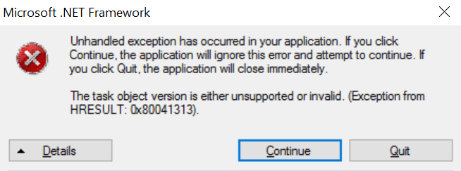

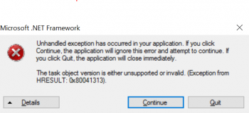

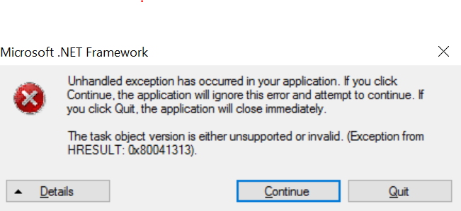

I finally took the plunge and upgraded my Boot Camp installation to Windows 10 (build 10586). After having a lot of problems installing the Boot Camp 6 drivers, I finally resolved those problems with the help of the Apple support forums. It looks like a lot of other people had the same type of problems.
Anyway, I wanted to reinstall Trackpad++ but kept getting a Windows .net error right after I choose between a Mac Book Air or Mac Book Pro. I got similar errors when trying to re-install PowerPlan Assistant as well. I already have the Test Mode watermark on the bottom right so the system is allowing non-signed drivers.
I tried updating Windows to see if there was a new version of the .Net framework but there was nothing to update.
Any ideas?
Error message:

************** Exception Text **************
System.Runtime.InteropServices.COMException (0x80041313): The task object version is either unsupported or invalid. (Exception from HRESULT: 0x80041313)
   at TaskScheduler.ITaskFolder.RegisterTaskDefinition(String Path, ITaskDefinition pDefinition, Int32 flags, Object UserId, Object password, _TASK_LOGON_TYPE LogonType, Object sddl)
   at TPPLauncher.Form1.Form1_Load(Object sender, EventArgs e)

@calkenneth: Thanks a lot for reporting. Actually since July 29 and till today, as reported by hundreds of people already, something went wrong only for one other user. While literally hundreds of the Trackpad++ users had personally confirmed total success upgrading to Windows 10. I'm pasting the message from this only user who had also experienced the issue similar to yours. Maybe this will work for you. Sorry, but I cannot check, cannot confirm, as all of the upgrade paths always worked fine for me, and I tested many, many times.
Quoting the Trackpad++ user (Mr. Coenraad Stijne):
"After messing around with the Windows 10 upgrade, I reverted back to 7, but Trackpad++ no longer worked.
After uninstalling I tried to reinstall, but both setups failed with "The Task Image Is Corrupt Or Has Been Tampered With" errors.
The solution was to delete powerplan and trackpad++ related keys in HKEY_LOCAL_MACHINE\SOFTWARE\Microsoft\Windows NT\CurrentVersion\Schedule\TaskCache\Tree
Just thought I'd pass on the solution for others who may have reverted their Windows 10 upgrade."
