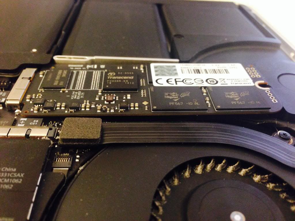

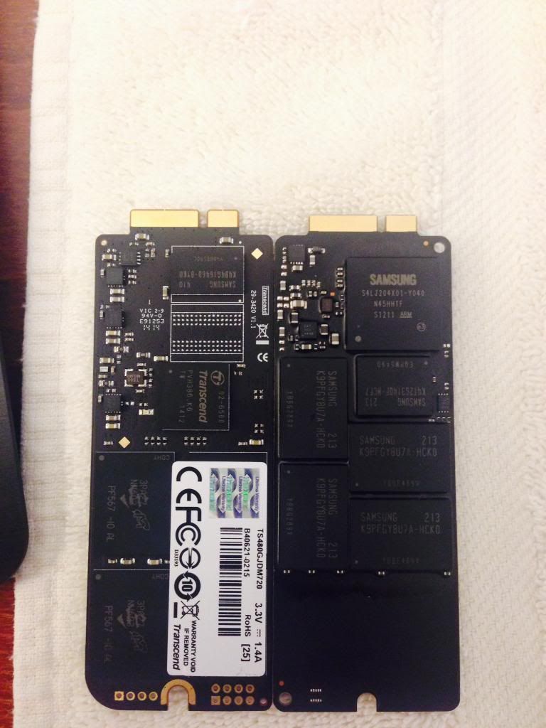

Just received my Jetdrive 720 for a 15 rMBP. The Transcend drive doesn't fit.
You can see that there's an ever so slight difference in overall length, which is preventing the Transcend drive from fitting properly.
Very disappointing. Manufacturing at this level shouldn't have this level of tolerance failure.
Going to return this POS to Amazon and rate it a 1 star.

Hello endlessct9a,
We apologize for the difficulties you are having with our product. We have noticed that if installed at a slight angle, the JetDrive won't fit correctly. Please try removing the JetDrive completely and reinsert while ensuring that your alignment is straight. This should solve your issue. If not, please don't hesitate to reply to this thread or contact us directly at support_ibu@transcend-info.com.
Please see this diagram: http://de-s1.transcend-info.com/images/jetdriveinstallation.jpg

Everything has been tried. It was inserted properly and retried several times. If you look at the stock Apple drive, there's plenty of room for it to fit. That is not the case with your drive, as is quite evident in the side-by-side shot.
I've already requested the return to Amazon. Shipping back tomorrow. Don't see the point of discussing this matter further. This was the first time I've purchased a product made by Transcend. "One chance to make the right impression." G'luck with that.

Hello endlessct9a,
Thank you for your feedback on this issue. Again, we would like to apologize for the inconvenience we have caused you. We take such matters very seriously here at Transcend, and we’d like to take some time to explain our findings after thoroughly investigating this issue.
What we’ve found:
1. 13” Retina MacBook Pros are not affected by this issue since the SSD is located in it’s own plastic tray beneath the trackpad. Transcend’s JetDrive 720 is fully compatible with the 13” MacBook Pro with Retina display.
2. JetDrive 500 and 520 are not affected by this issue.
3. We have found that on some 15” Retina MacBook Pros, Apple’s assembly tolerances may allow for the motherboard to be shifted slightly to the right, decreasing the clearance between the speaker and the back of the SSD. The reduced clearance caused by the shifted motherboard will prevent our JetDrive 720 from seating correctly since it is 0.5mm longer than the stock SSD. We are therefore announcing that our JetDrive 720 is currently incompatible with the 15” MacBook Pro with Retina display.
Our next steps:
1. We will change all Amazon listings and our own website to reflect this issue.
2. We will redesign our JetDrive 720 PCB to be the exact length as the stock SSD, making it fully compatible with both the 13” and 15” MacBook Pro with Retina display.
We have attached a few photos to illustrate the above issues. (imgur link)

Wow... I gotta admit ....
That is SO close to fitting, I would be VERY tempted just to file down the edge of the drive a slight bit until it snapped into place.
Yeah, I know.... People are going to say, "No way I'm going to start filing away on a brand new item that's this expensive!" And that's understandable.
But as someone who's worked as a tech for both PC and Mac gear for something like 25 years -- I'd examine the circuit board to make sure it could safely be shaved down, and if so, would probably do it rather than go through the RMA process and have to put the old drive back in again, etc.

From my own experience, I can tell you that the 720 JetDrive fits the 15" MacBook Pro retina better than the OWC SSD drive fits the 2012 MBA. I've had both, first the OWC Aura and now the Transcend JetDrive. OWC users have been complaining about the OWC issue for years, without success. Some users have trimmed the board to make it fit. I was able to snap the one I had into place to make it fit. OWC has never acknowledged the issue.
I commend Transcend for addressing this tolerance issue and promising a fix.
You never really know how things will work in the field until product gets out there. There is only some much beta testing can do.
I do take issue with the language of endlessct9a. Your bringing the issue to light is commendable, but you description of the product is really not necessary. Amazon's refund policy is excellent, and you should not out anything other than your time.
