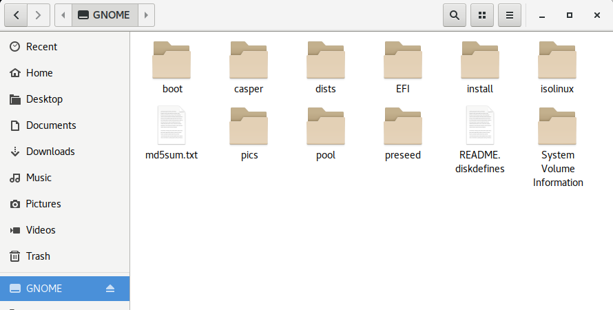

Regardless try looking up some key files from Ubuntu boot disk. Probably see folders like boot, casper, pool, preseed, EFI, dists, isolinux, etc. A file md5sum.txt is a dead give away too. If all those are in one place its safe to delete. If you find them scattered around you might want to just leave them.
I'll edit this in a minute with a screen shot of bootable Linux USB main folder.
Thats is Ubuntu gnome 17.04 but the folders will be the same. If you can't find them I would just pretend this never happened....lol
Thanks for your awesome reply. I can see all those files in my BOOTCAMP root (except one "System Volume Information). Going to delete those now.
