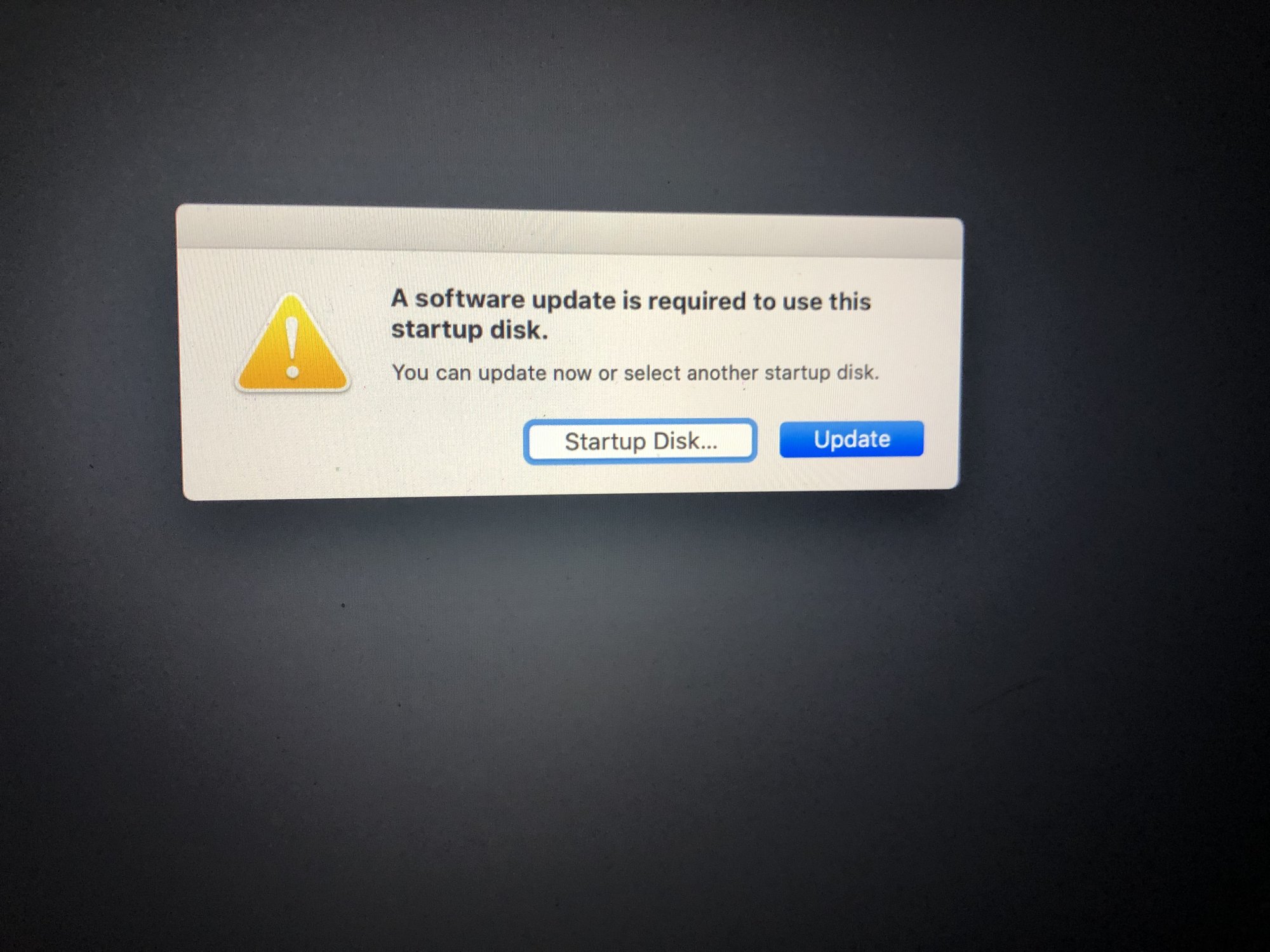

Having the same issue with my 2019 Touch Bar MacBook Pro. I installed Big Sur over my Catalina OS on my external SSD drive. I can boot into it using a 2017 MacBook Air but not my MacBook Pro. It will stop booting and ask for the disk to be updated. When I click on update, it will continue to boot, followed by a count down and then a blank screen. This cycle will repeat until it finally boots into the Catalina OS on the internal drive completely ignoring the external HD.
I can get it to boot the external hard drive you just need to connect it to the internet if you the startup security on. I tried to make a Big Sur USB install, i created it and when I tired to boot it from the USB it said it need a update

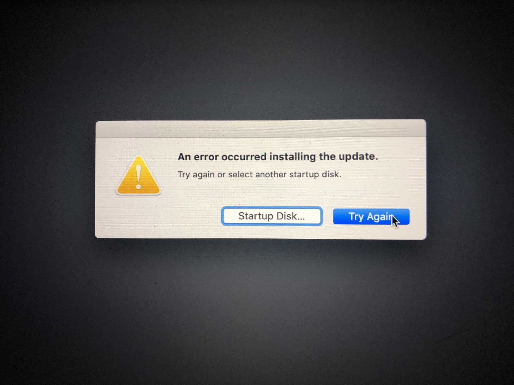

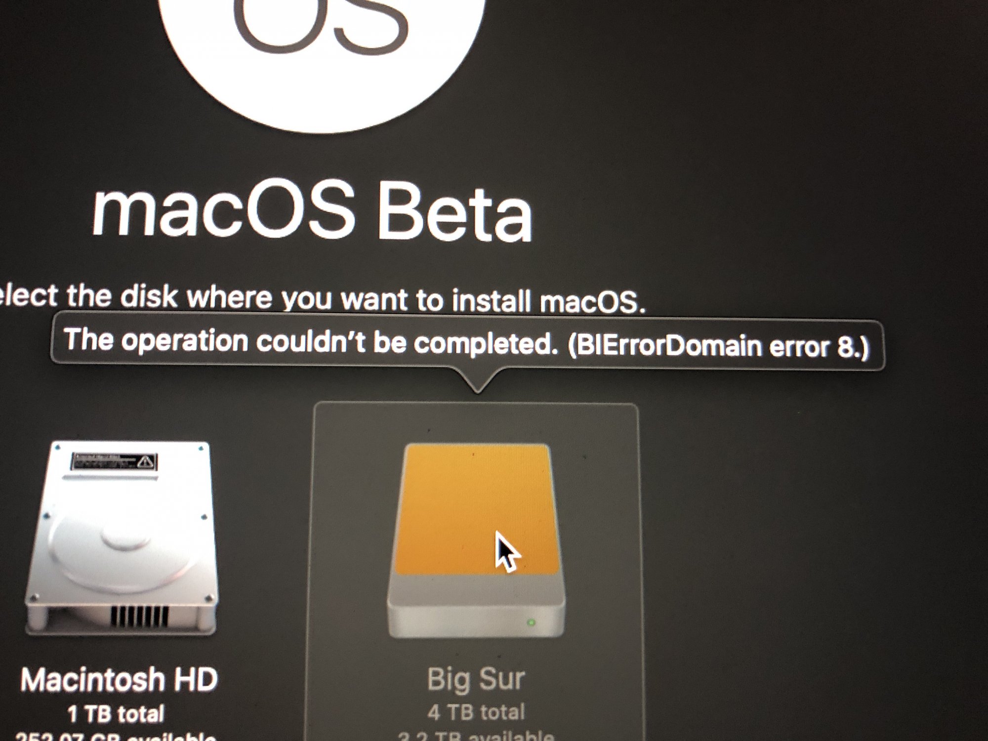

Trying to install Big Sur on a External Hard Drive. I made a clone copy of my macbook pro, So I can boot the USB external hard drive fine, and I log in I installed the beta profile and download the installer and when I tried to install it I get The operation could not be completed.
Then I created a USB Installer of Big Sur, and when I booted up to the installer I got this
After I did the Update then I got this
I have one more idea I was thinking about deleting the External hard drive and tried boot back to the Big Sur USB installer. What dose everyone think? Or is there anyway to fix that first error?

I’m trying redownload the profile again and this time I could choose what drive I wanted to install it on before I could not choose so I’m downloading the Big Sur installation
i reinstalling the profile and this time it let me choose where to install it before it just skipped that and it was installed fine and now I’m downloading Big Sur installer again
UPDATE: no luck still get the BIErrorDomain error8
