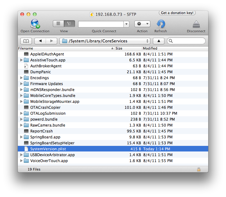

After the wifi icon appears in the status bar, power off the iPhone (Hold Sleep button until red "Slide to Power Off" slider appears then slide).
Put device with DFU mode again, jailbreak with redsn0w 0.9.8b5 – give it the beta 5 IPSW, uncheck Install Cydia and check Install Custom Bundle – select SSH2_bundle.tgz
The phone will reboot when the jailbreak is complete. Power the phone off once it’s started up and use redsn0w to “just boot tethered”.
Once the phone has rebooted again and is at the slide to set up screen, use your favorite SSH client to access the iPhone's filesystem (FTP client with SSH (SFTP) mode [ie. Cyberduck] or USB sync cable [PhoneDisk]). For an SFTP client the username is root and password is alpine.
Navigate to /System/Library/CoreServices/SystemVersion.plist.
Modify the SystemVersion.plist with a text editor (ex. TextEdit) and delete "<key>ReleaseType</key> <string>beta</string>" or modify it with a plist editor (ex. Property List Editor - part of XCode) and delete the property called Release Type. (I find it works best when you copy the file to your computer, make the changes, save it and copy it back to the iPhone)
Once the that's complete use Redsn0w to "just boot tethered."
You will now be able to activate the iPhone and restore from backup (iCloud or iTunes) or setup as new. After a sync your iPhone will be back to how you had it.
