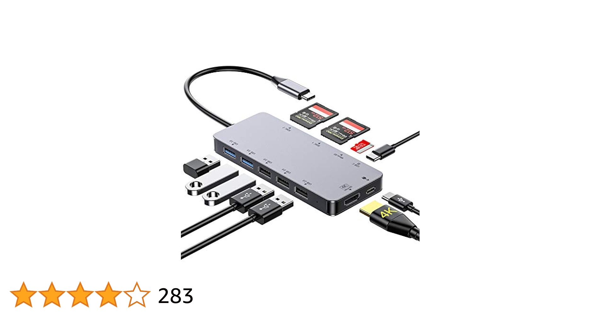

Yes, I've been using this hub:

These total failures do seem to often occur (though not always) when a hub or dock of some kind is used.
Having said that it doesn't seem unreasonable for users to have something like that in use when the laptops only come with 2 ports. Some expansion is foreseeably likely to be needed at some time.
The only thing I can think of is that they can supply/or draw too much power for the port. But that seems to be Apple's problem to solve - if indeed it is a problem.

Ok, that would then suggest that the problem is caused not by the manufacturing of this model with these specs but by using an incompatible hub... you say they "often occur"... how many cases have there been and was it always with the macbook pros or with the airs as well? It seems pretty extreme that the computer would completely die by using a less-than-fit hub and that feels then like playing russian roulette with every peripheral connected, at some point the mac has to connect to other peripherals.
If memory serves I believe there have been 4 on here so far.
Some of those reportedly blew the logic board.
The cause is unknown currently though.

Did you by any chance connect a dongle or any other external device to your MBP while it slept? Some dongles have killed/bricked M1 Macs this way. (Edit: I see that you have been using a dongle).

Do you have some information about what dongles and what macs are affected exactly? Is it just the pros or also the Airs? This is really disheartening!
I use a dongle with my 16", it even has power delivery and its been fine. Used the dongle for about 2 months now.
I would advice against buying off-brand dongles from amazon.
But in your case I really do think it was bad luck.
If I remember correctly, a lot of the problems have been with off brand hubs.
I would go ahead and get another M1. This time, try a Satechi hub.
I have a satechi hub and it works fine, but I think the OP had bad luck. i’ve read a few threads from members that have different hubs and they work fine, but others with some off brand Hubs do not. Perhaps when Big Sur OS has some more updates then many of the other peripherals will work

I have only read about dongles bricking/killing M1 MacBooks here on this forum. Seems like both Pro & Air are effected. I haven't had any experience with this as I have been cautiously avoiding connecting "USB-3 to USB-C" dongles to my MacBook. I did so because I was and still am illogically paranoid & not out of the honeymoon period with my MacBook. But based on what users who have experienced bricking have said following are important to keep in mind:
1. Avoid third-party dongles
or
2. Avoid leaving dongles connected to your Macs while they sleep. It seems that bricking takes place when Mac goes to sleep whilst connected to dongles.
I am not technical expert, just a lay user, so I can't say what's going on here. Perhaps it has something to do with the M1 Macs' structure or power setup. Some user, however, have found a way around to bringing M1 Macs back to life by kick starting through another Mac. You should be able to find the details on this forum or even on Google.
