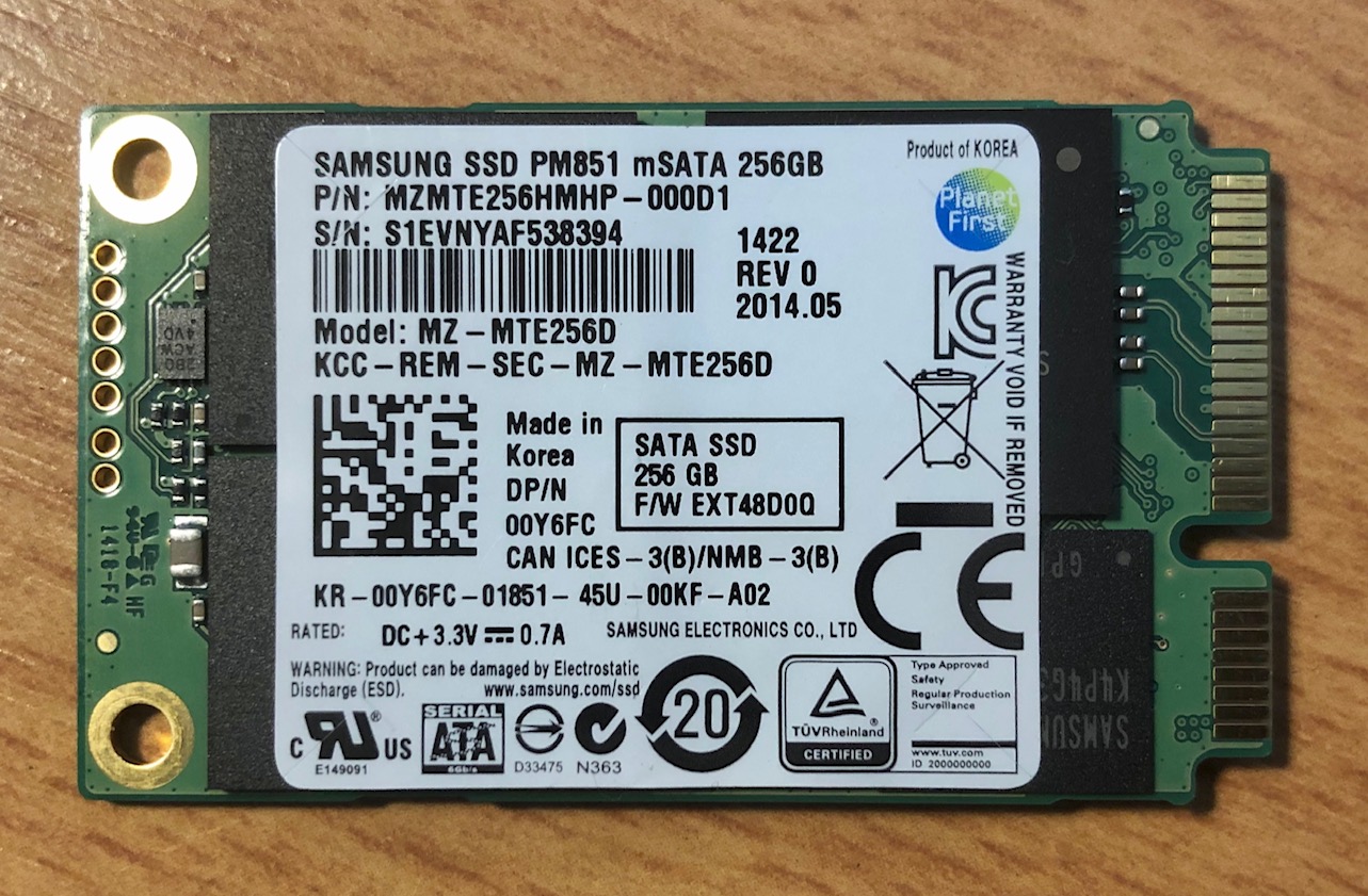

Excellente, mSATA it is. Actually I realised that I might have one already. A while back I found this one sitting in an enclosure. It could work, no? I must admit I find all the various SSD interfaces bewildering at best...
Oh yes, that's the one, 256GB, that's lucky!
Actually I've just realised that mine is a 256GB, probably Samsung as well ;)
Cheers :)

Haha great Hugh :) Gigabytes-Schmigabytes

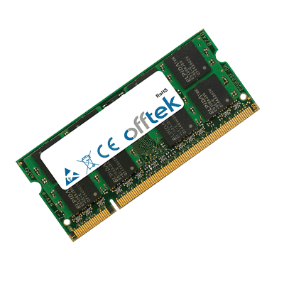

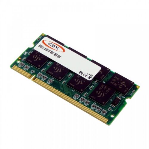

I checked at Everymac.com and it seems the RAM specs are the same for the 15" and the 17" DLSD, is that right?
I'm asking because at the moment I only see RAM for the 17" model on the Bay. As I'd really like to put 2GB in the 15" DSLD which arrives tomorrow I'm wondering if I can buy such a RAM stick instead.
Here are two examples

I'd wait for the PowerBook and check, if both socket are working and hold a working RAM-brick each.
If yes, you may go for two 1GB-RAM-modules. If one is faulty, you need to get a 2GB-module.

It turns out that it has two 512MB modules installed so both slots work, yay.
