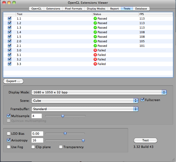

I am having the same experience as this with a 4890 Sapphire New Edition card. Have 10.6.4, Apple Graphics Update, QECI Exotic patch and installed all kext files in the "mapp.zip". QE now works however i have seen no improvement in Steam games. I still have to use the lower settings and still have frame lag at times. So it doesn’t seem as if much hardware acceleration is happening for me.
In the System Extensions only 4 of the 7 extensions from the mapp.zip were installed:
ATI4800Controller 1.6.10
ATIFramebuffer 1.6.10
ATIRadeonX2000 1.6.10
ATISupport 1.6.10
Is it possible to work out what extensions i should be running to make my card work better, especially with Steam games? I should be able to run everything on the highest settings right?
Here's some further info. I have used OpenGL Extensions Viewer 3.32 to benchmark my card and have attached the results. They look to be a little low from others i have seen. Also, i have tried other kext installs (1.6.16 and 1.6.18) all with the patches provided in Zeus, but none of those will allow Quartz Extreme. The 1.6.10 kexts are the only ones that are working for me. I have also attached my cards Rom. If anyone can take a look and let me know what's going on, or point me in the right direction that would be great. Thanks.
