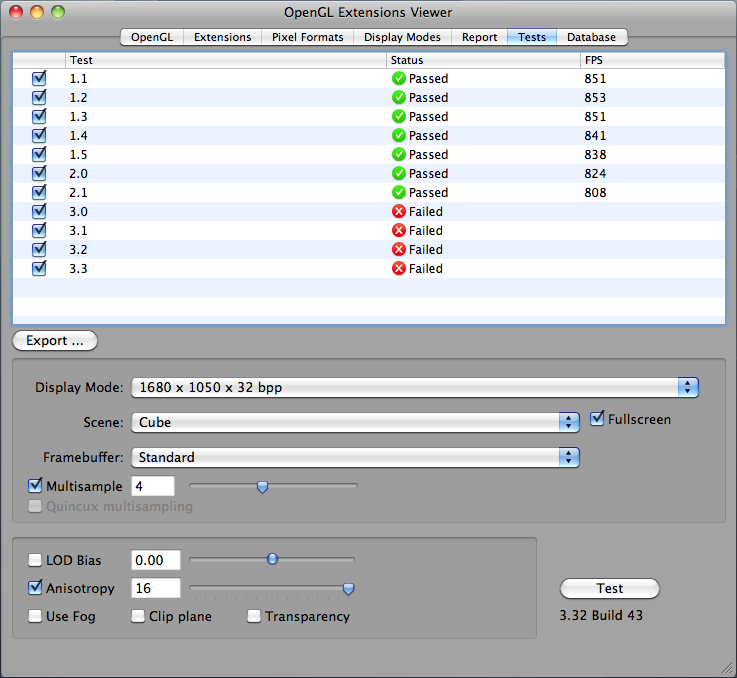

Another update on my card. I was curious to see what the OSX 10.6.2 kexts would look like so i installed the ones listed here (the dualdvi.zip) over the top of my existing 10.6.3 ones. The results were amazing!! The card is running better than ever. Have got great scores in the benchmark and Steam games can now be played maxed out and still give 100fps+. I can't believe that going back to the 10.6.2 Ati extensions would be the solution for me. Has even got rid of the slight tearing i was having with Finder windows too. This may be the solution for others too. Have included pics.
