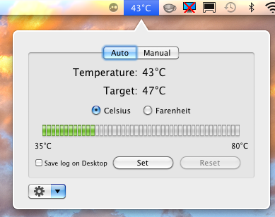

I've designed this app to be very easy to use. You set a target temperature, and it'll adjust the fans accordingly. I've coded it for my personal use, but since it's useful, I feel I should share it! 🙂

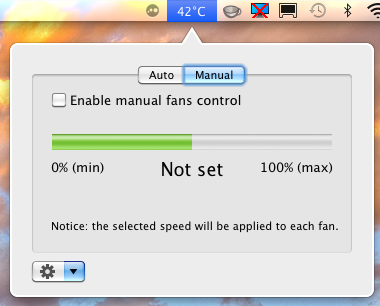

  • manual control: you can now manually control your fans' speed

On the status bar, if either auto or manual mode is on you'll notice a symbol right before the current temperature. √ means auto mode is on; ~ means manual mode is on.
The "save log on Desktop" checkbox has been introduced in the beta development, and I'll probably remove it. For further information, you can read the latest Beta post.
