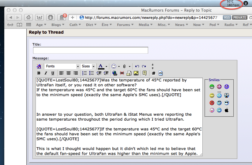

In answer to your question, both UltraFan & iStat Menus were reporting the same temperatures throughout the period during which I tried UltraFan.
If the temperature was 45°C and the target 60°C the fans should have been set to the minimum speed (exactly the same Apple's SMC uses).
This is what I expected would happen but it didn't which led me to believe that the default fan-speed for UltraFan was higher than the minimum set by Apple.
ATM, the Mini is not doing an awful lot, I'm listening to iTunes while writing this and the temperatures and speeds are normal. With UltraFan the speeds were always 245 rpm higher.

Rpm and temperatures a few moments ago.

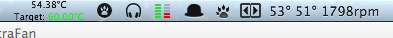

Hi Lost,
That output can't have been very useful to you, is there something I'm missing?
BTW, UFan seems to be working the way I expect since I reinstalled as the image below shows.

Hi Lost,
Glad it works as expected.

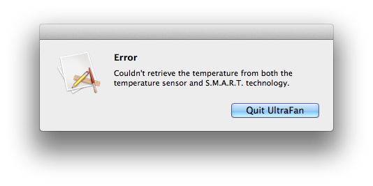

Have an issue with my 15" late 2011 MBP 2.4 i7 every time the MBP sleeps UltraFan 8.2 will not resume due to to being able to read the temperature sensor & S.M.A.R.T. state. Only fix to quit and restart the app
MBP is standard barring 8Gb of RAM, on 10.7.3, thx in advance
That's interesting. Probably the SMC needs some time to wake up.
If it's ok with you, I'm going to PM you a "beta" version to fix this. 🙂

Ok Thx, I believe it is the same and UltraFan simply needs a delay before executing
