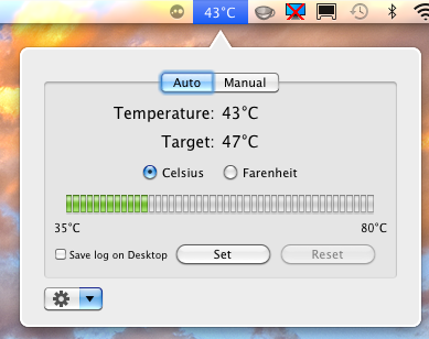

And please make "Save log on Desktop" work. If it needed an instruction before, please make it automatic on the next version so we don't have to follow the set of instructions every time there's a new bug discovered.

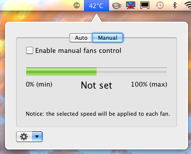

And here's a request. I don't know if it's a bug or not, but when I'm on automatic then forgot to press reset and switched to manual, I'd check the checkbox to enable manual, right? But it shows an error that I have to exit auto.
Here's the issue: The checkbox remained checked. Can you make it not-checked when that error shows up? Because that error shows up again when I uncheck it, making it appear 2 times which is kinda annoying.

Notice: if you want to save the log on your desktop, you have to allow some time (otherwise nothing will be logged...), and to provide information in the popup. If you don't no log will appear.

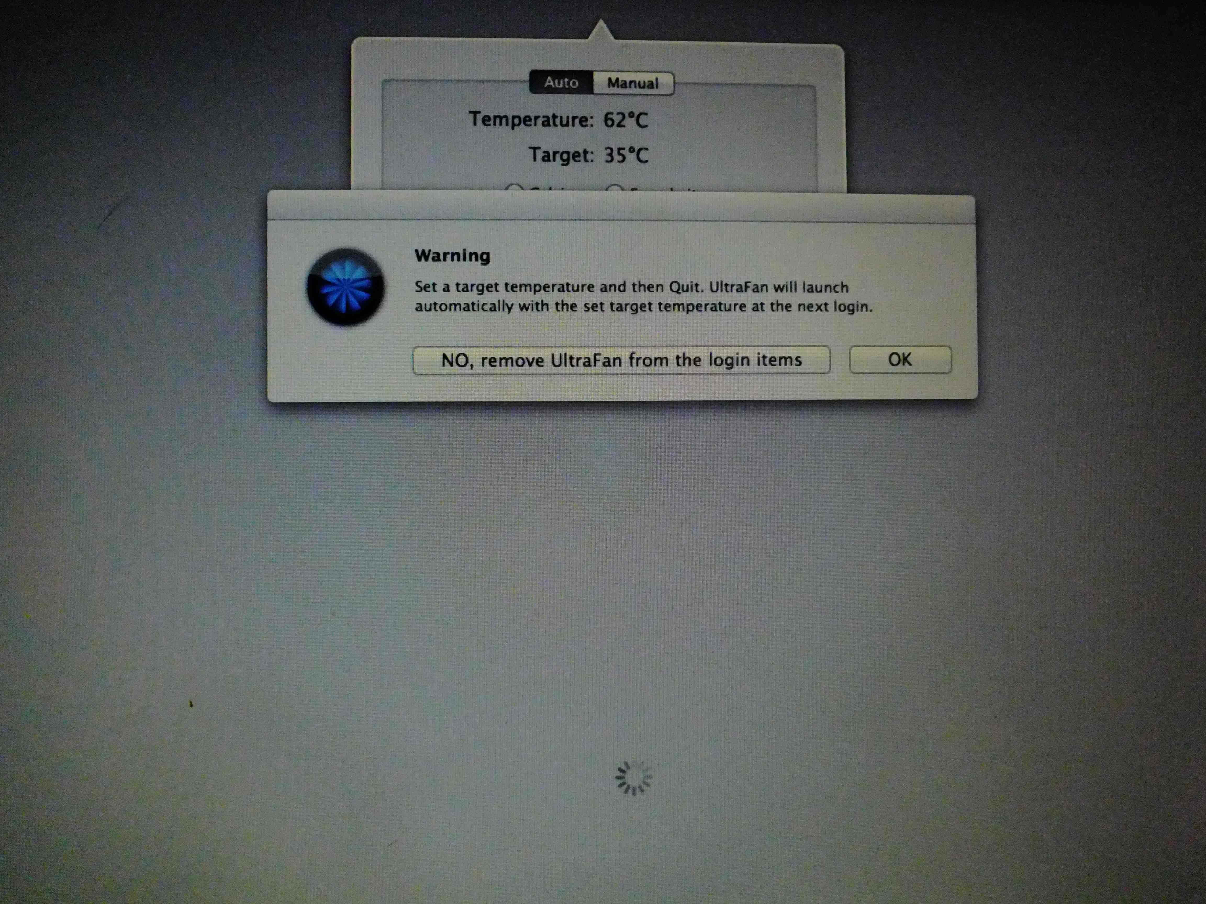

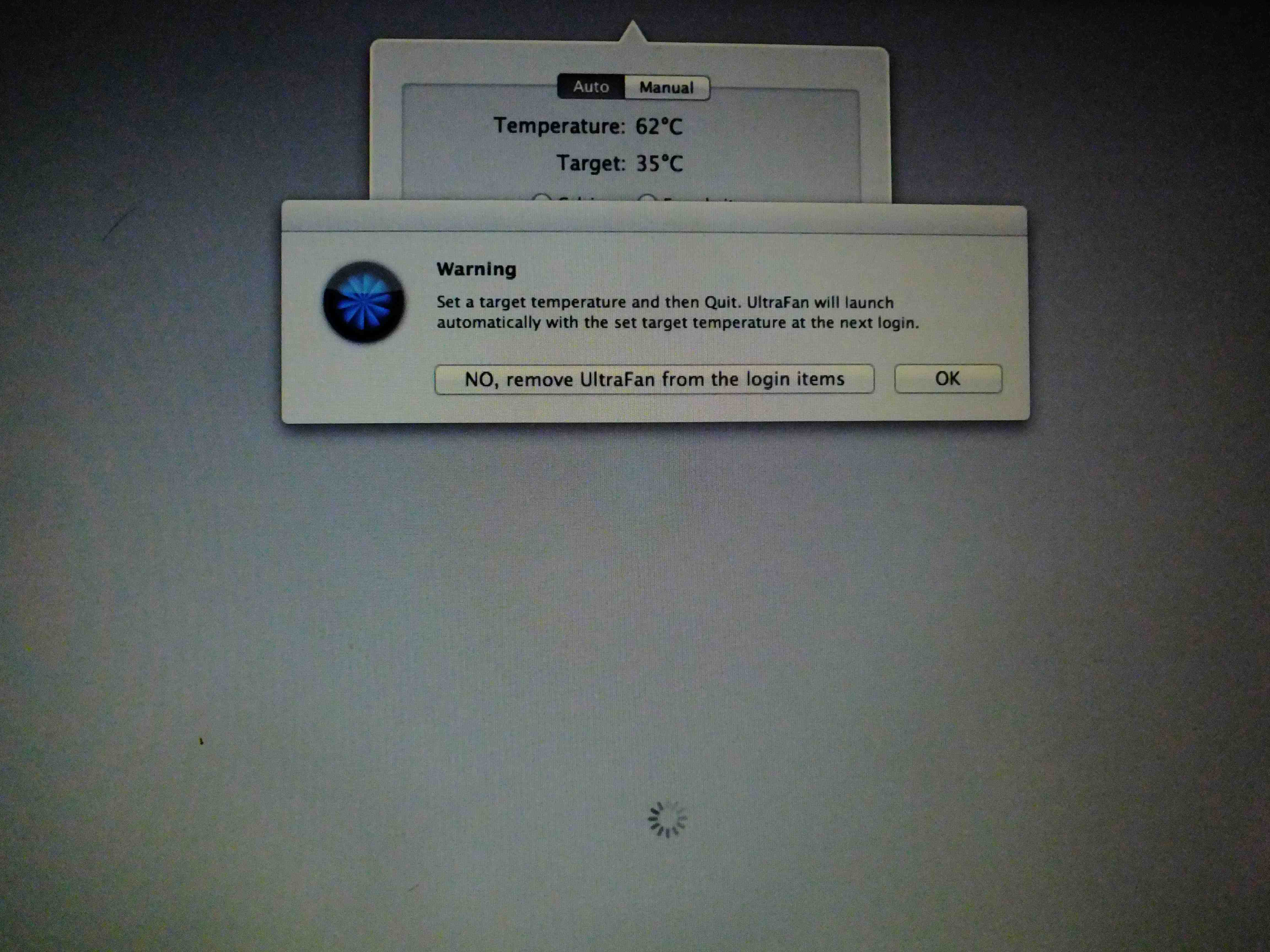

Bug detected. Open at login doesn't work when restarting. Before it shuts down, however, it gives me this lovely message that won't go away until the machine has completely shutted down. It's stuck in the screen.

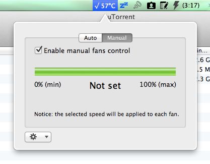

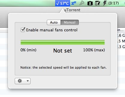

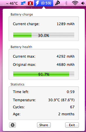

Found something. It seems that UltraFan is telling the temperature a lot different than the other application. Please explain why.
That's how the feature works, even though that message should appear before that screen. If you check "open at login" you have to make sure UltraFan is running in auto mode when you quit it. That way, at login UltraFan will automatically set the previous target.
If no target is set, UltraFan will not launch at login, as the message reports.
The image you posted is indicating battery temperature not CPU, so hence the big difference.
Correct. 🙂
