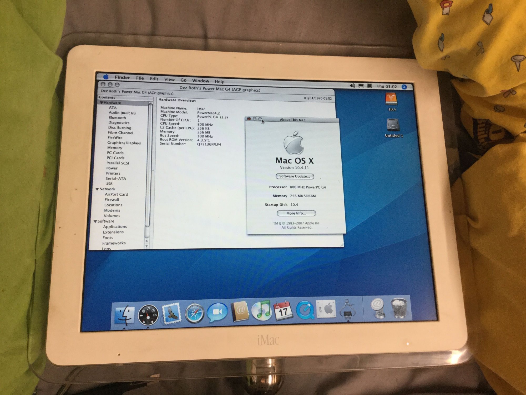

im pleased to report the swap worked, kinda, the machine POSTs and sometimes boots OS X but its very unstable etc
im still investigating these issues but it is rather complicated, in that there are quite a few variables at play more so then normal
i dont know for example what the rest of the board is like, for example it may have had other issues before it had its CPU fried?
but I am pretty pleased that it POST's etc it shows the PowerMac4,2 firmware and hardware is indeed compatible with the 7455 CPU, I had suspected it was because its firmware 4.3.5 is higher then say 4.2.8 the latest released for the PowerMac3,1(PowerMac G4 sawtooth) and I know the PM3,1 is compatible with the 7455

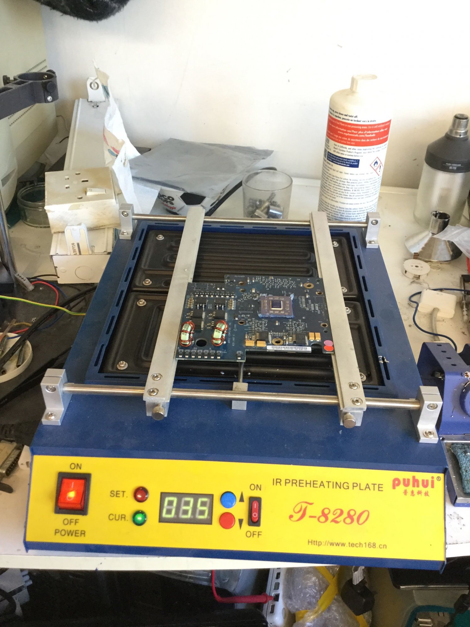

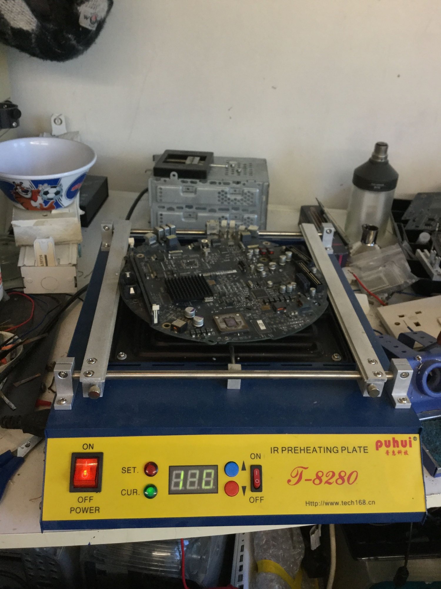

first getting the donor CPU card on the board preheater and getting it up to temperature

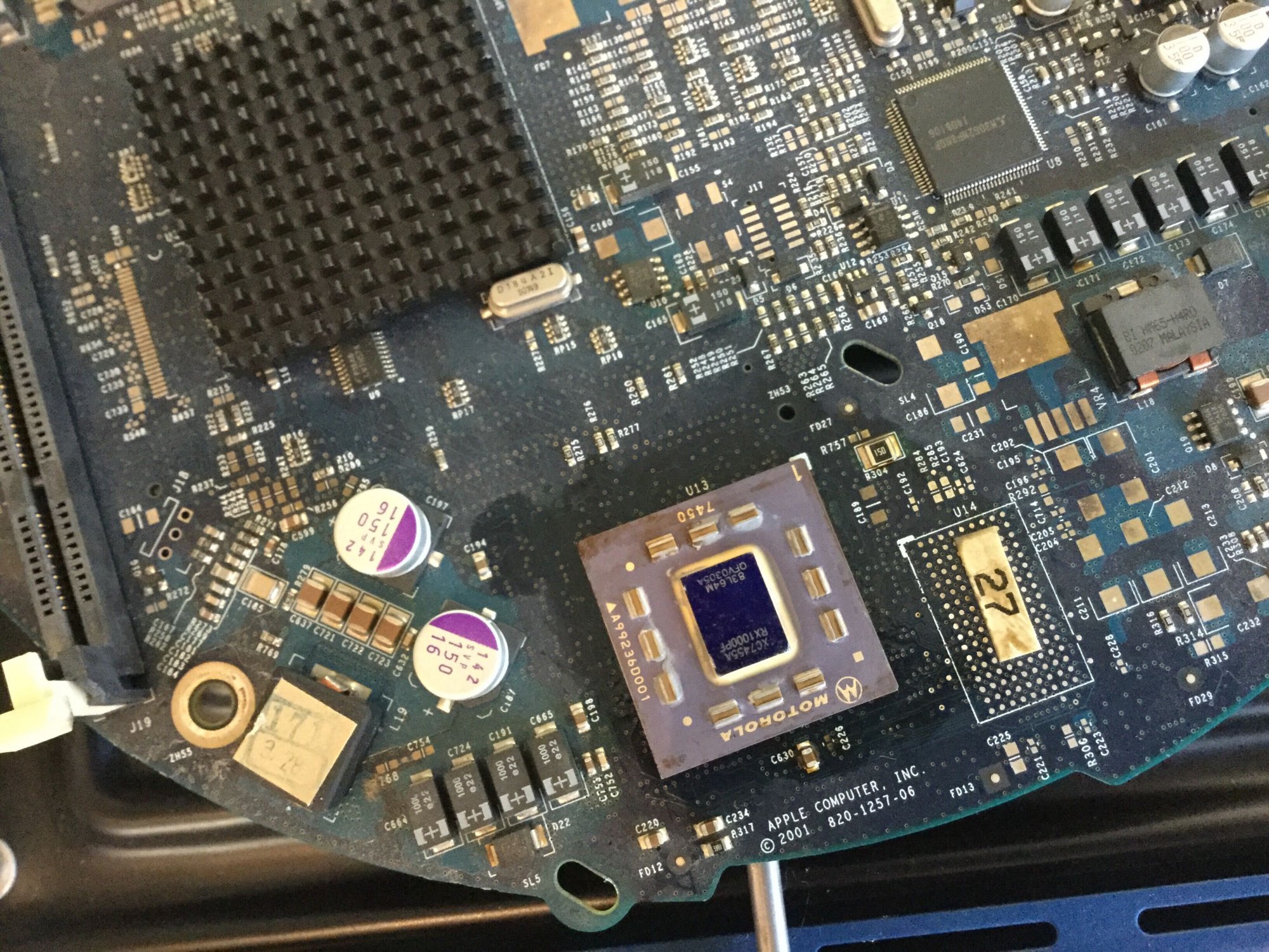

then heat gunning the CPU off

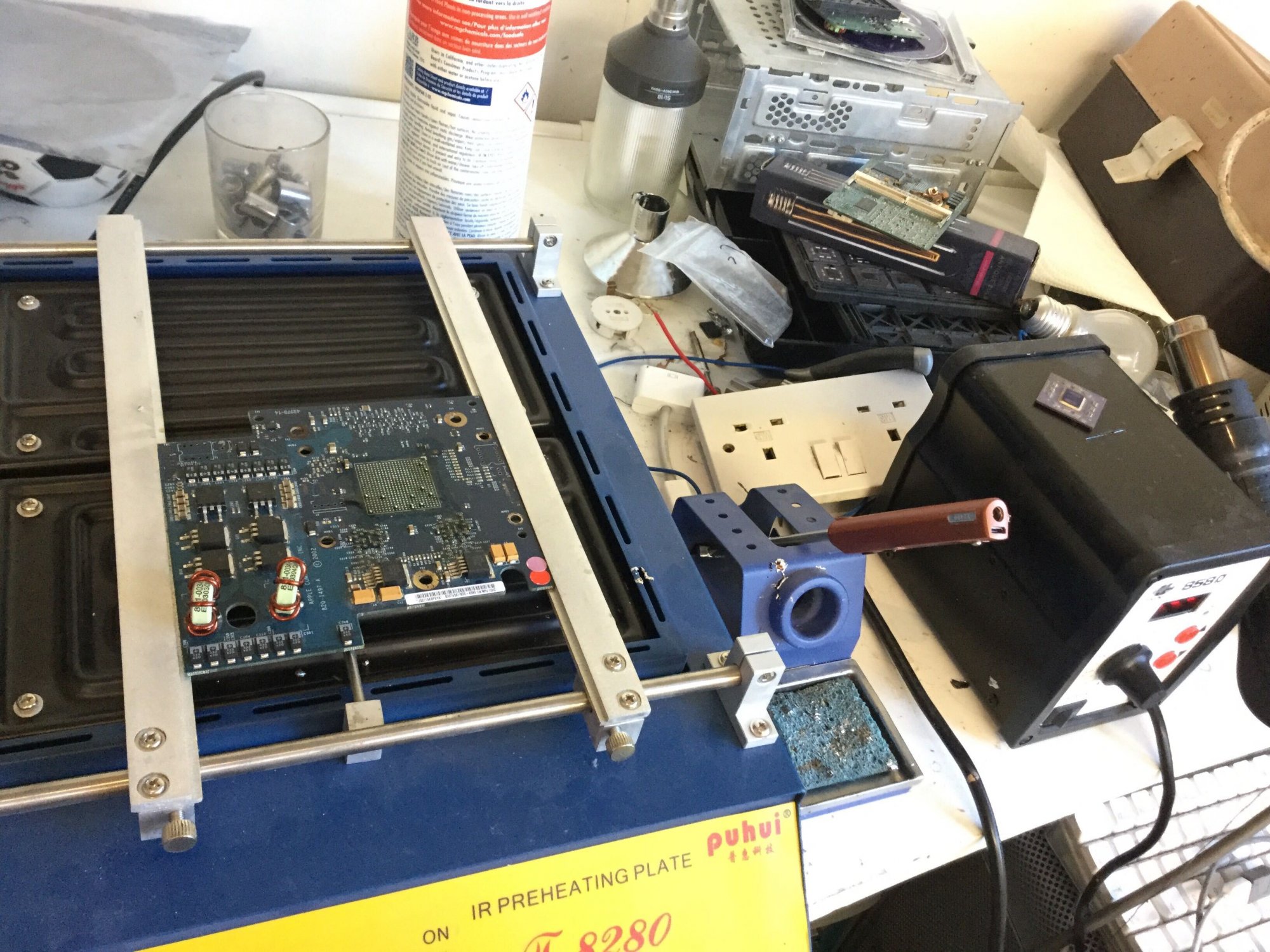

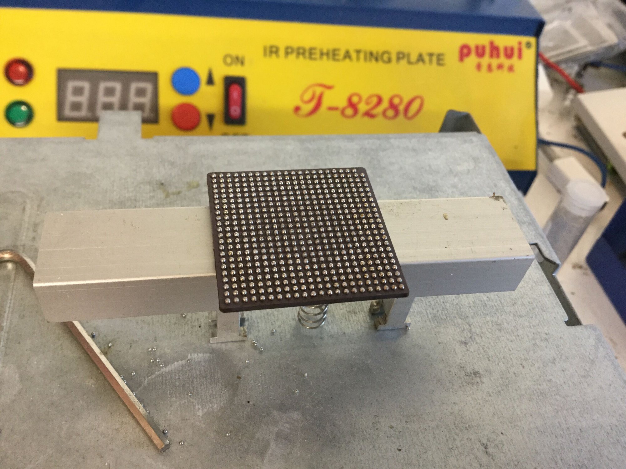

then cleaning up and reballing the "new" CPU
then moving onto the iMac G4 board, on the preheater once more

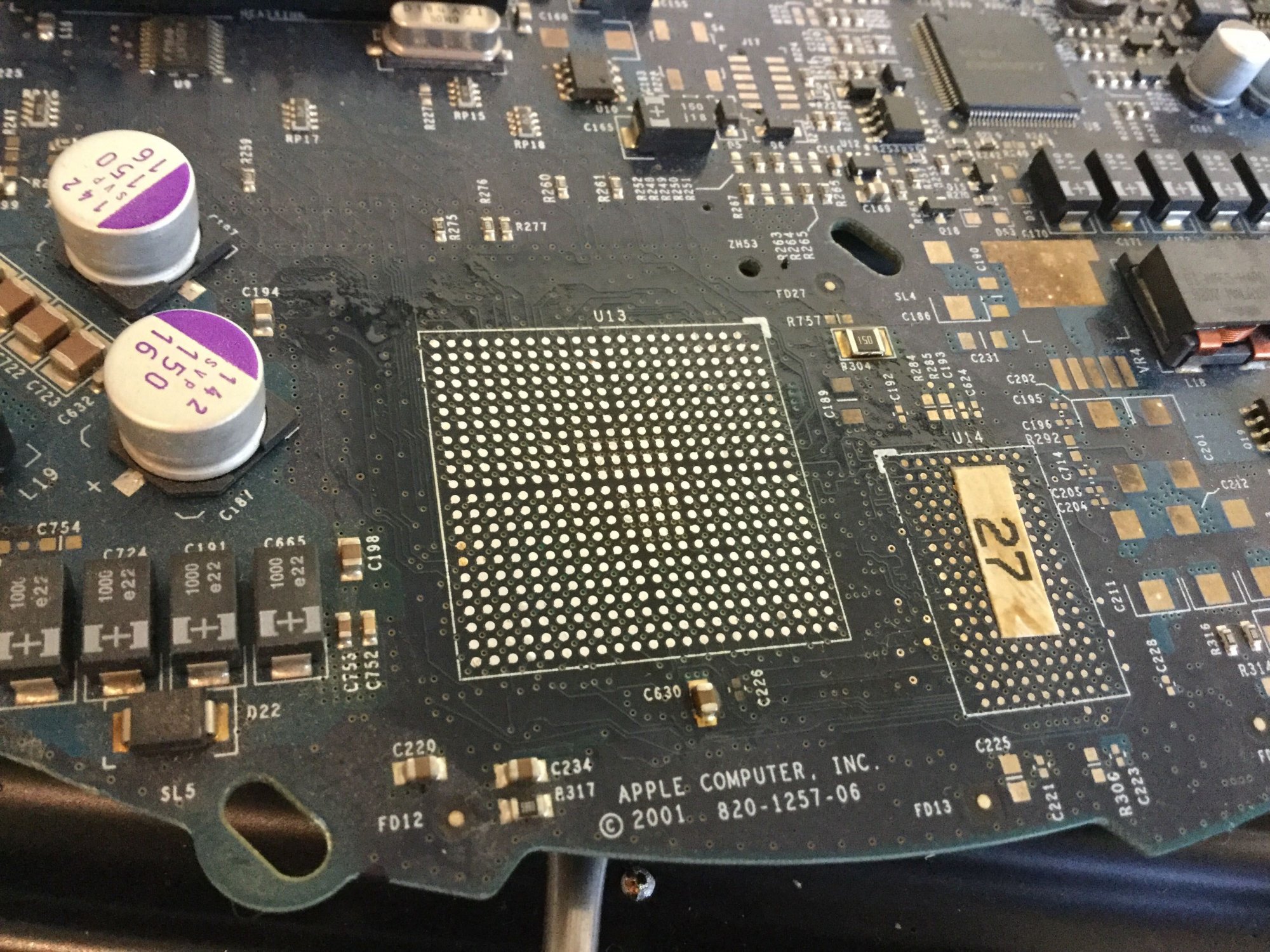

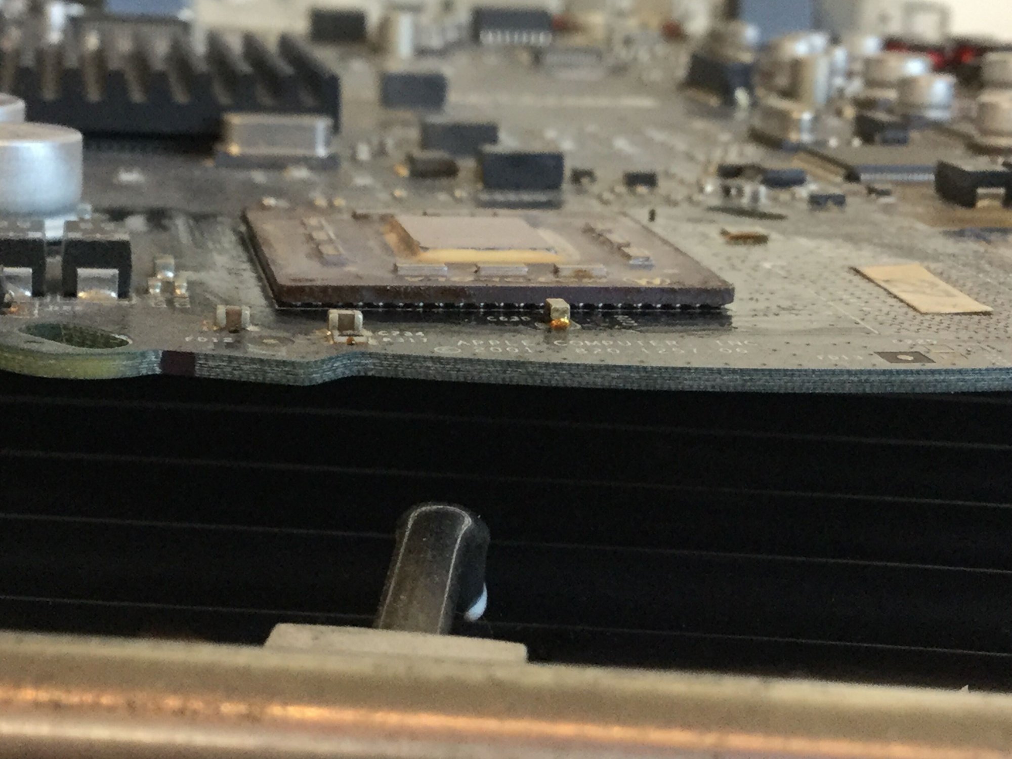

old fried 7451 removed and pads cleaned up ready for the "new" 7455

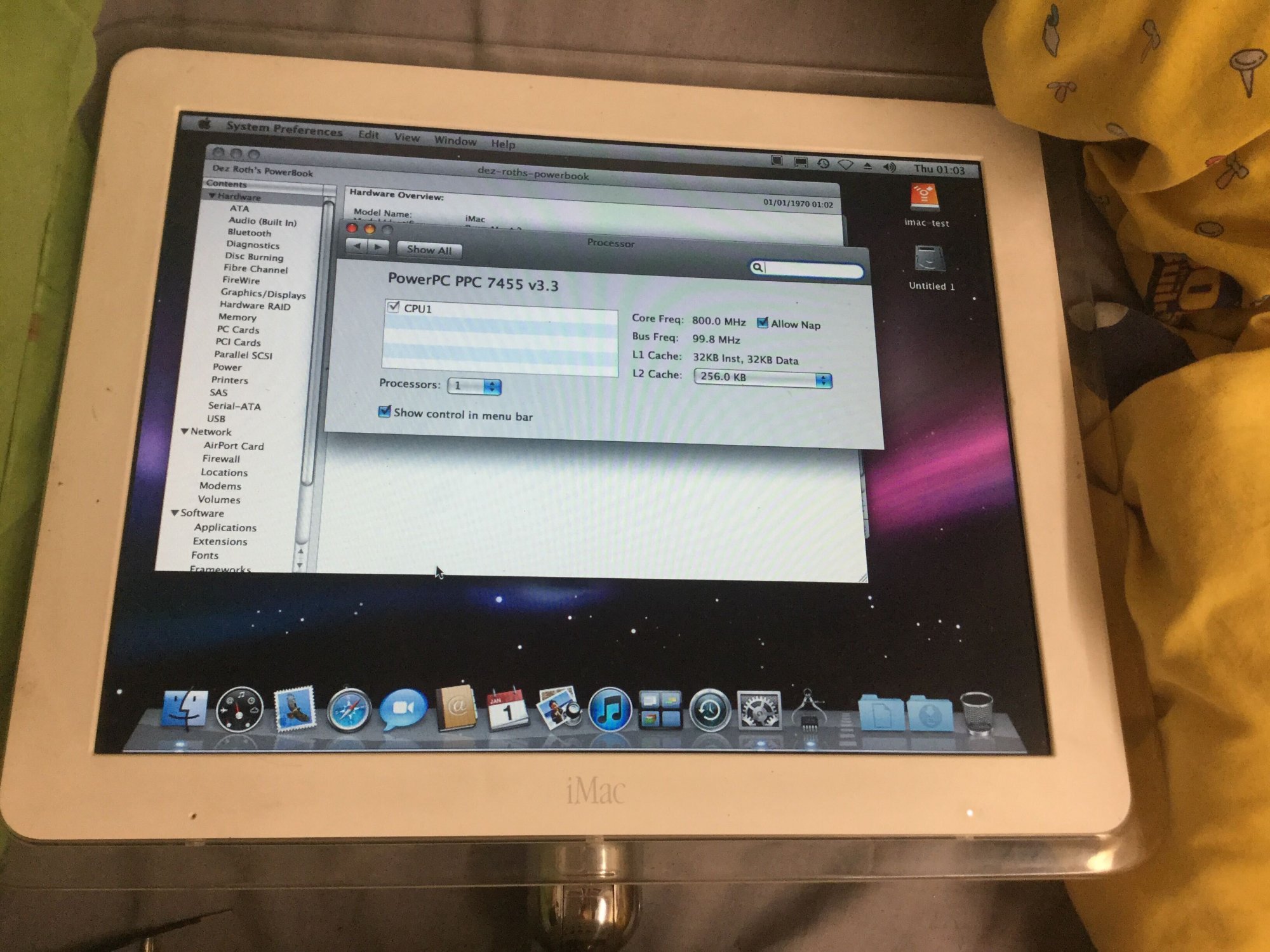

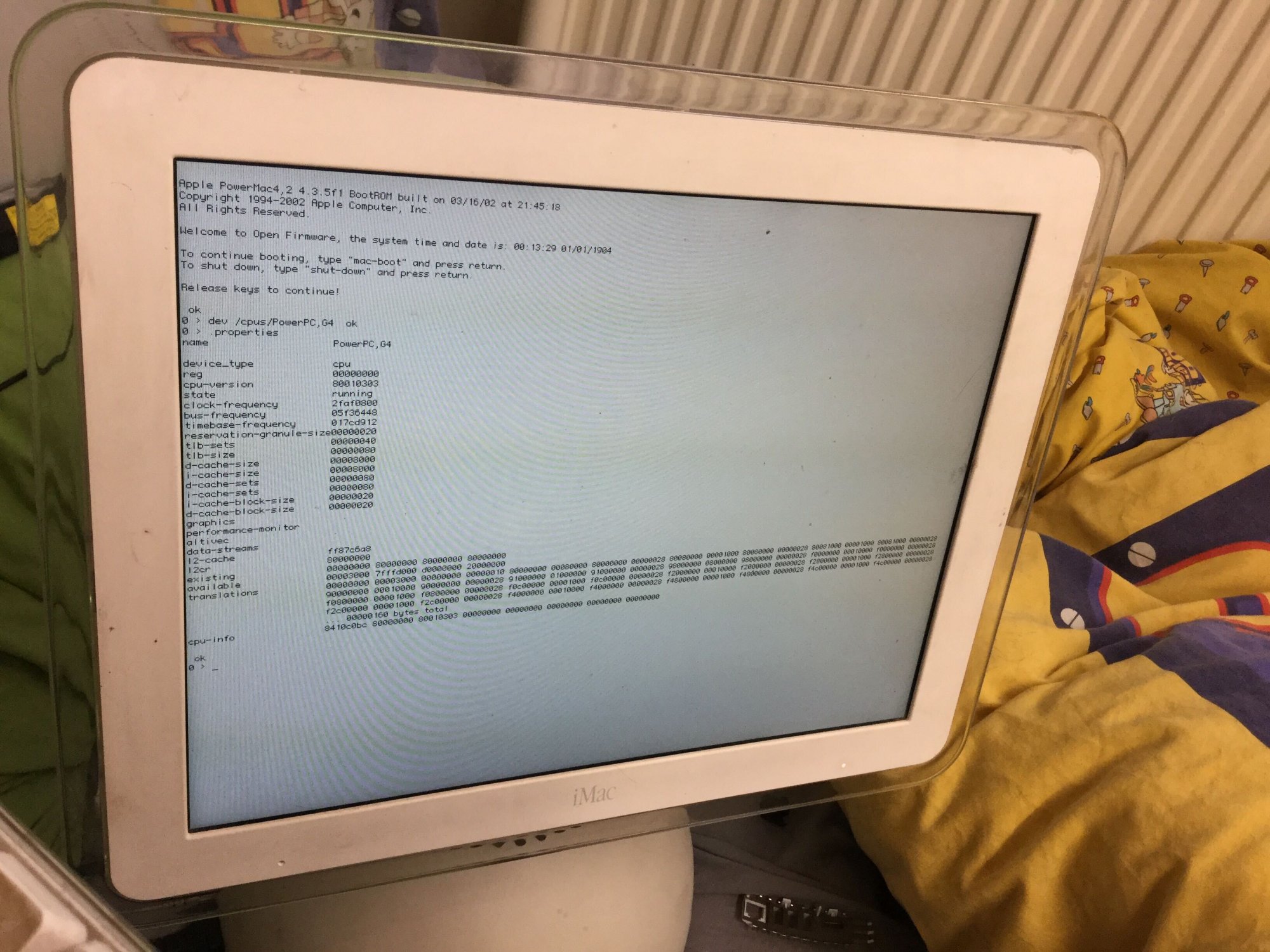

heres a few shots from OpenFirmware and OS X

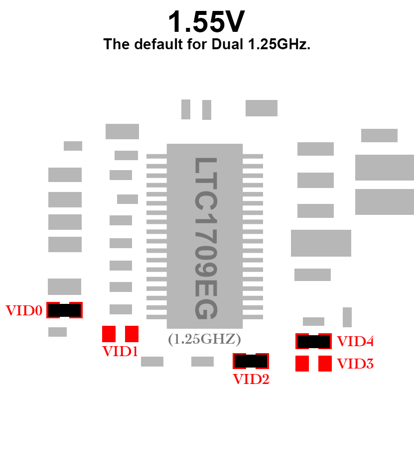

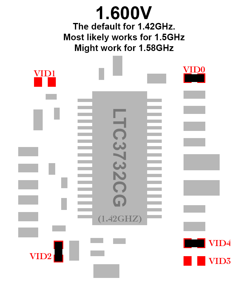

I've been researching the Vcore of both the 7451 and the 7455 and they both run around 1.6V, that shouldn't be the problem.
I have even looked for factory settings on the MDDs for 1.25GHz and 1.42GHz and working at 1.65V should not be a problem. I have downloaded a few datasheets to see differences and they all work around 1.6V. Your iMac @ 1GHz should not fail from excessive voltage.
I finally got the iMac G4 800, it's model 820-1398. I could only get the schematic of 820-1257 for free but the values do not match. The Vcore resistors measure 5k and those values are not in the schematic, and the bus speed resistors R636 and R637 are empty. Does anyone have my schematic?

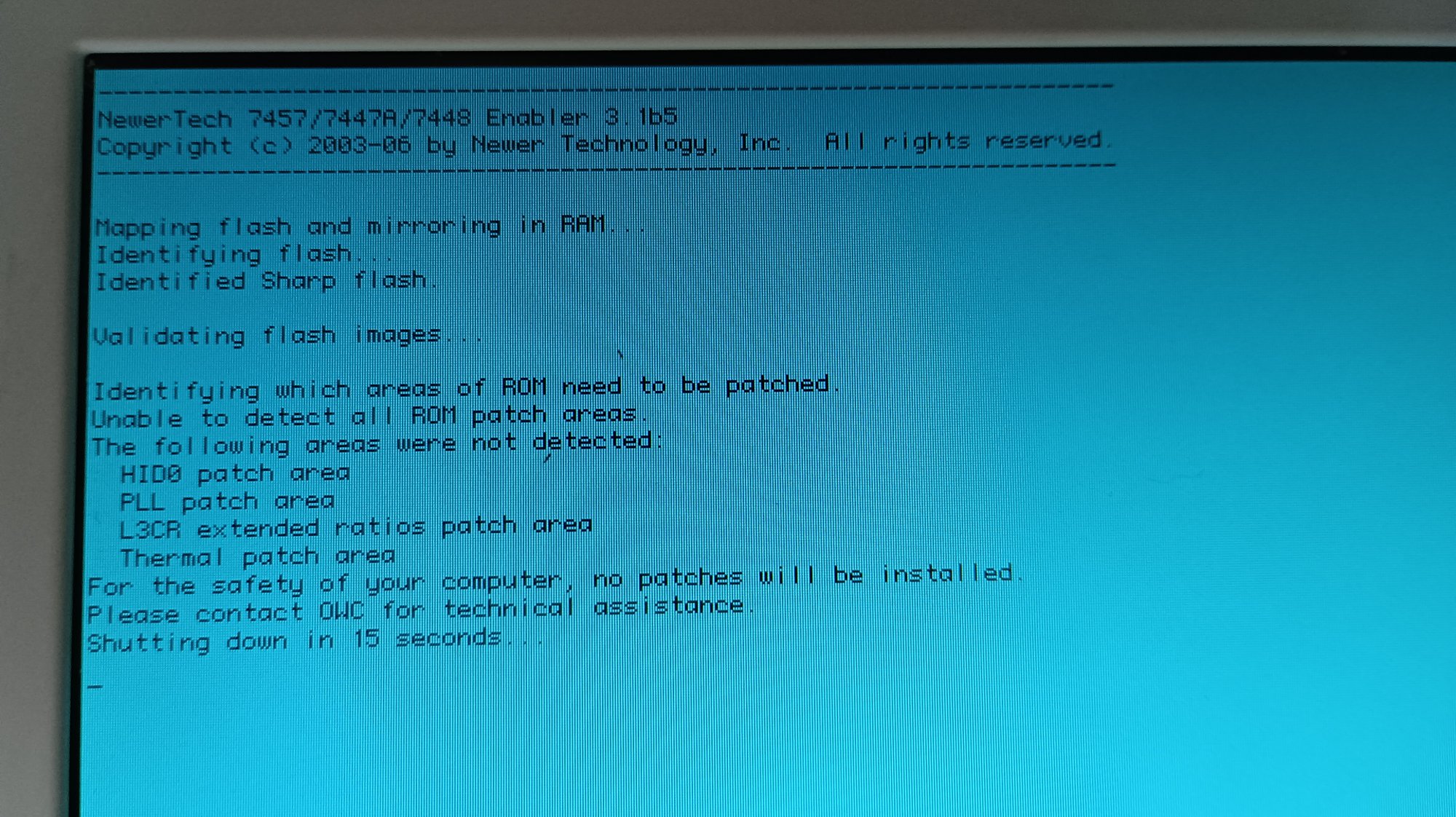

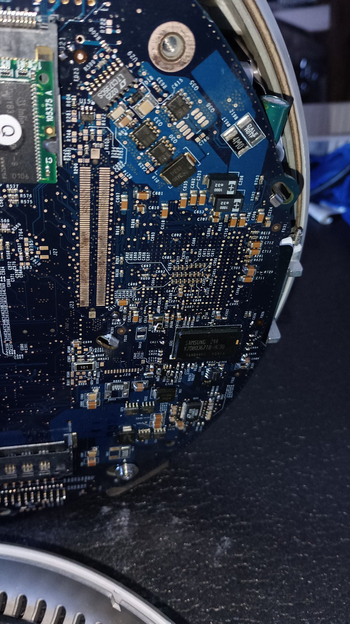

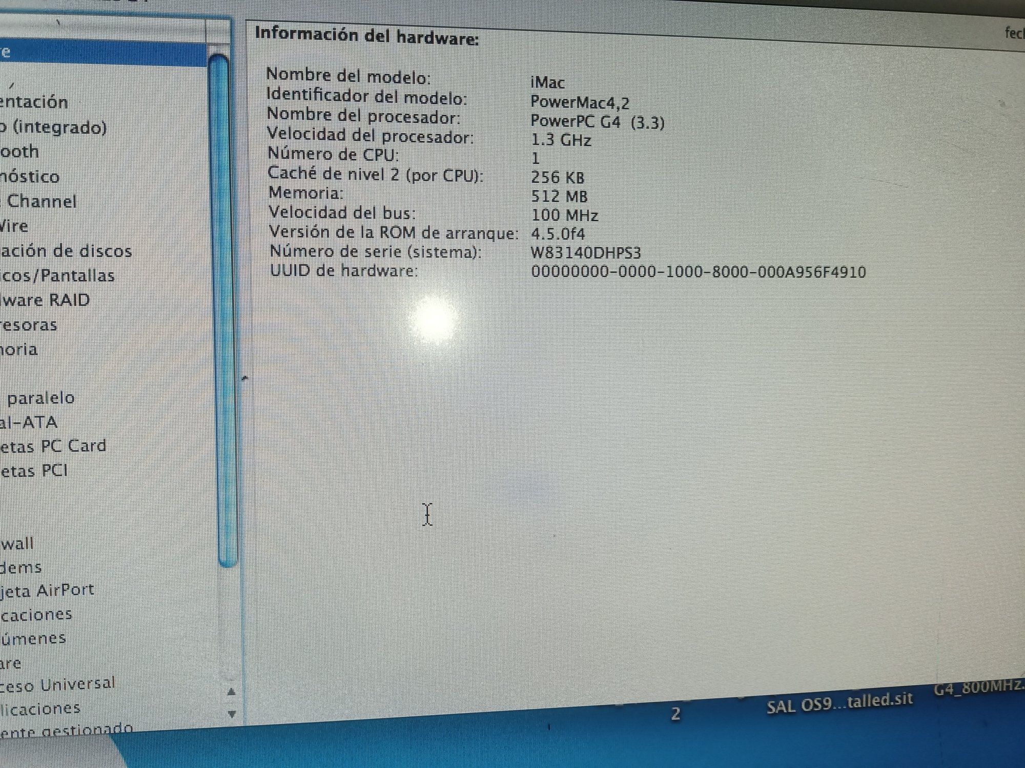

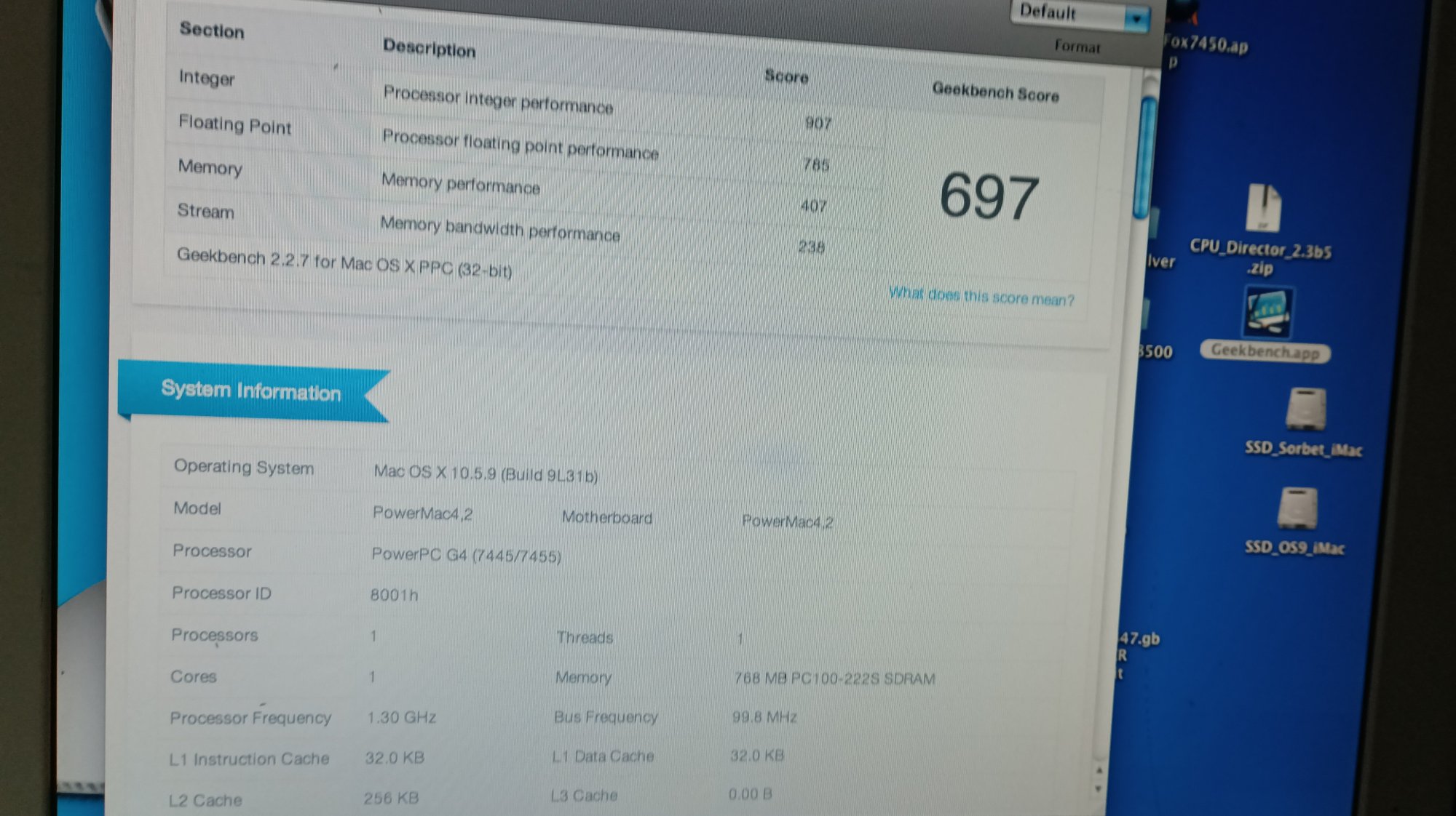

Hello. Today I finished making the changes to add L3 cache to my iMac G4 800@1.3GHz. I have removed the NOL3_Cache components and added the necessary ones, and the 2MB of cache, from the XSERVER CPU that the G4 1.3GHz donated.
The iMac boots perfectly but does not recognize the L3 cache. As I was told recently, in these AIO devices they must adjust the ratio and configuration of the L3 cache in the BOOT ROM and not in an EPROM, is that true?
I have tried to run the GigaDesigns patcher, which includes a cache enabler, but it gives me the following error:
It seems that the firmware does not contain such information. Do you know if it could be activated via terminal? or with some other patcher? @dosdude1 can you help me?

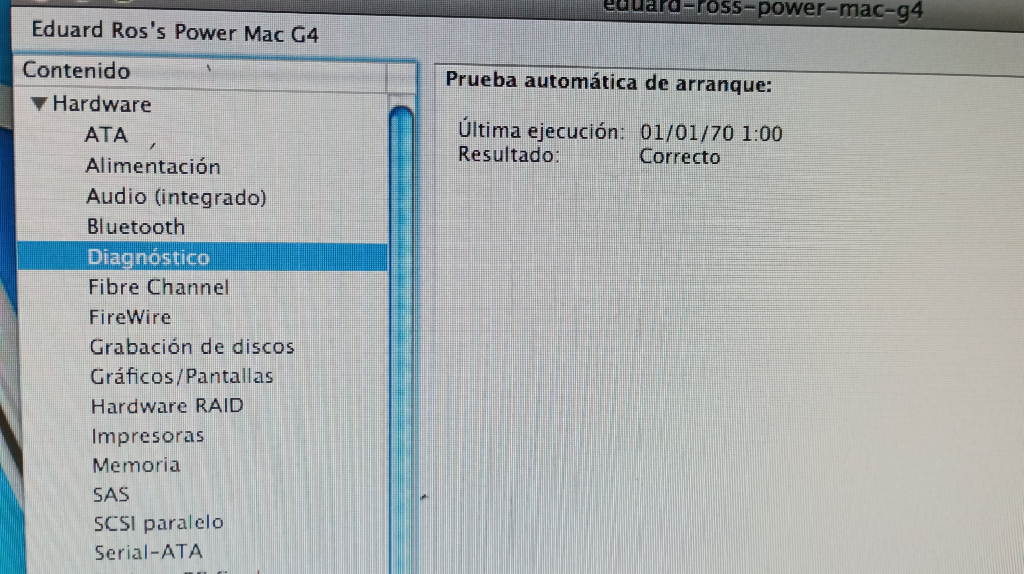

Awesome Stuff! glad to see it all still POST's with the L3 cache and its components in place, thats a good start 🙂
have you checked under the "Diagnostics" tab in system profiler to see if your getting any POST messages relating to Cache now?

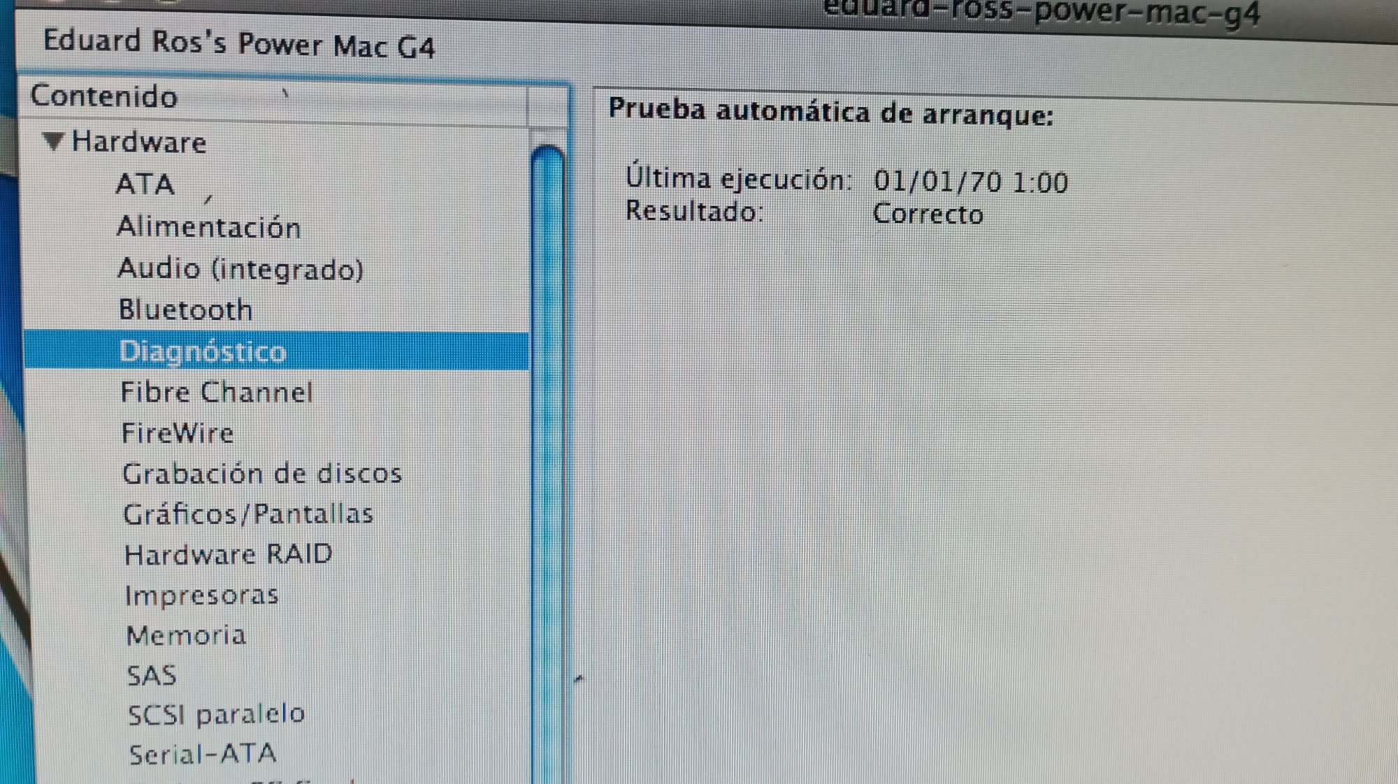

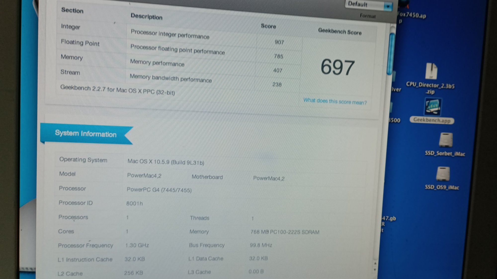

Thanks for answering.
As you will see in the attached photos, the diagnosis appears correct (the date is wrong because the battery has been removed).
I have applied the Sonnet Cache Enabler and no information appears in the System Profiler, so I have run GeekBench and the result has been the same as without L3 cache mounted, and it is not recognized either.
The message that must be overcome is the GigaDesigns patcher error, something must be added to the ROM so that it recognizes it.

the CPU firmware patchers, mostly all they do is remove the Unknown CPU check, they dont explicitly enable any *L3* cache, since even without any BootROM support MacOS just reads the L3 cache info off the SPD data (in the case of 7457 cards etc)
just as a sanity check, does the cache enabler do anything in Tiger?
also if in OS9 you install Sonnets crescendo software do you see any L3 cache pop up in Metronome? (I think 3.1 is the last OS9 crescendo software)
