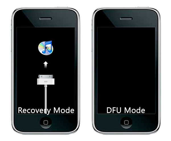

Wow, that's strange!
When you say recovery mode, do you mean the actual recovery mode(iTunes logo) or DFU mode(black screen)?
If you did recovery mode, try DFU mode:
While the phone is turned on, hold down the Power and Home buttons for around ten seconds. After six seconds of holding them both down, the screen will go black. Keep holding both buttons! Once you reach ten seconds, release Power but keep holding Home.
If you did DFU mode, try recovery mode(just power off the iPad and then power it on while holding Home before the screen comes back on) and see if that helps you restore the iPad.
