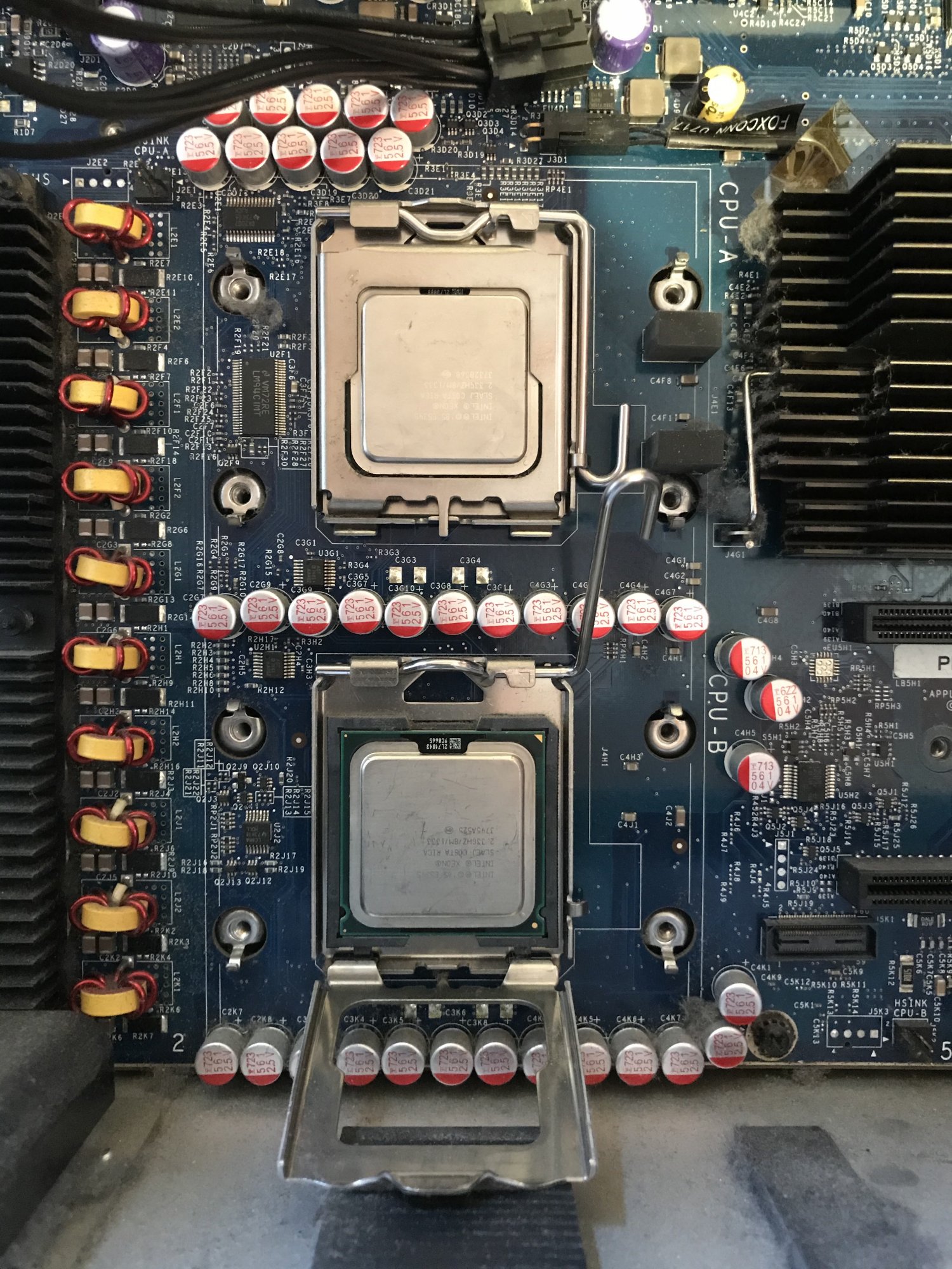

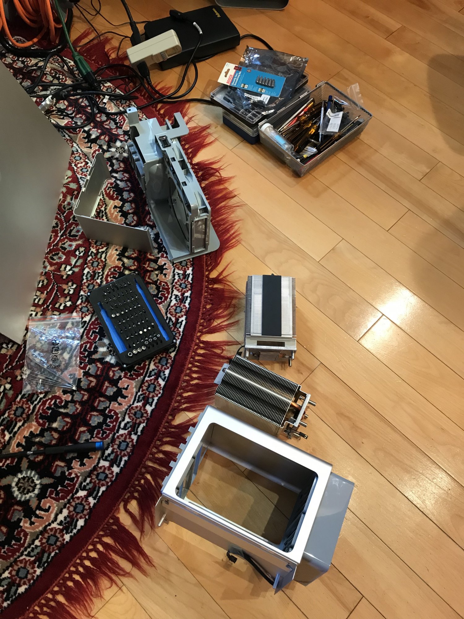

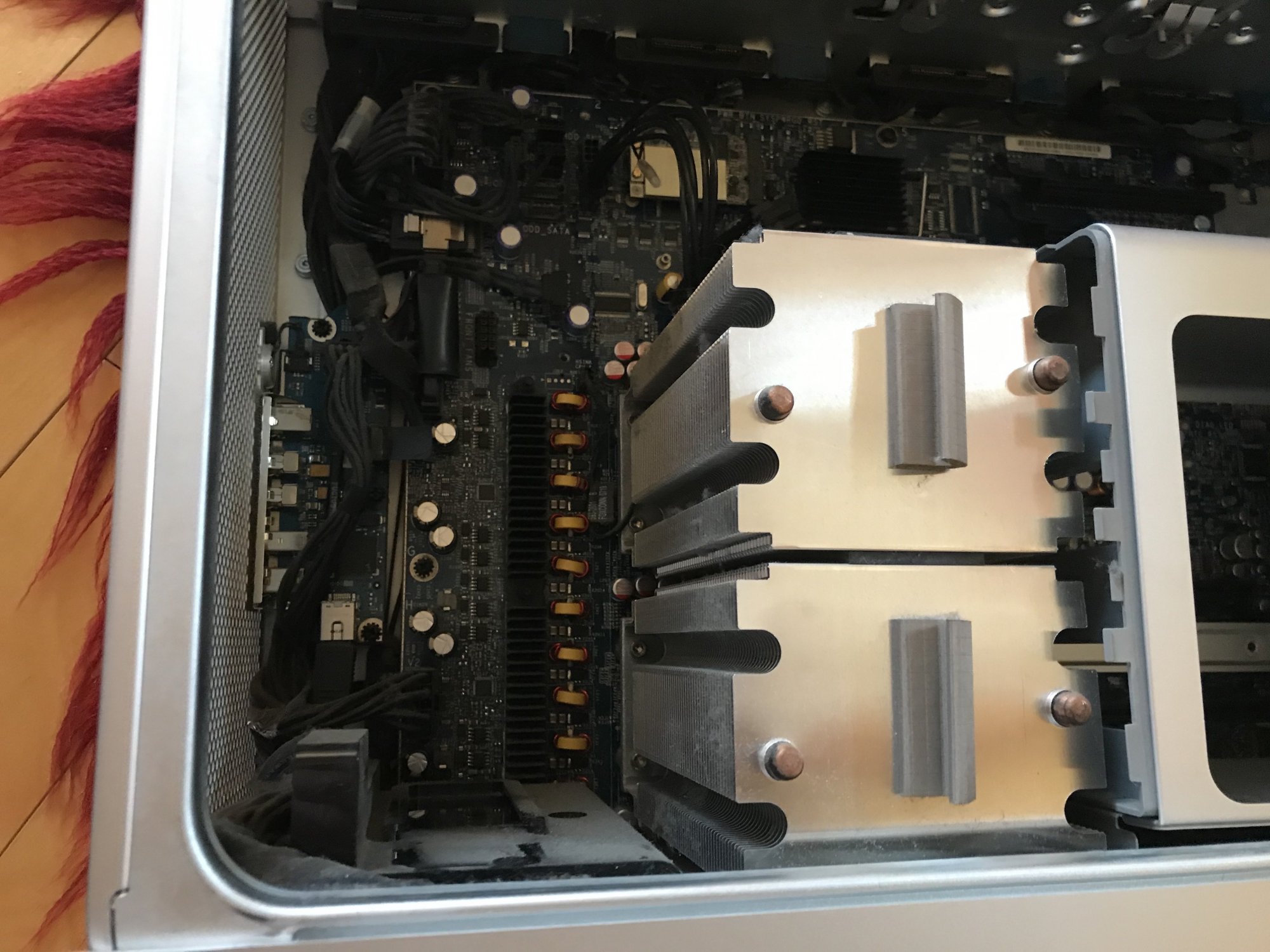

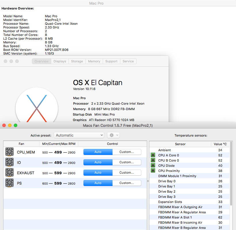

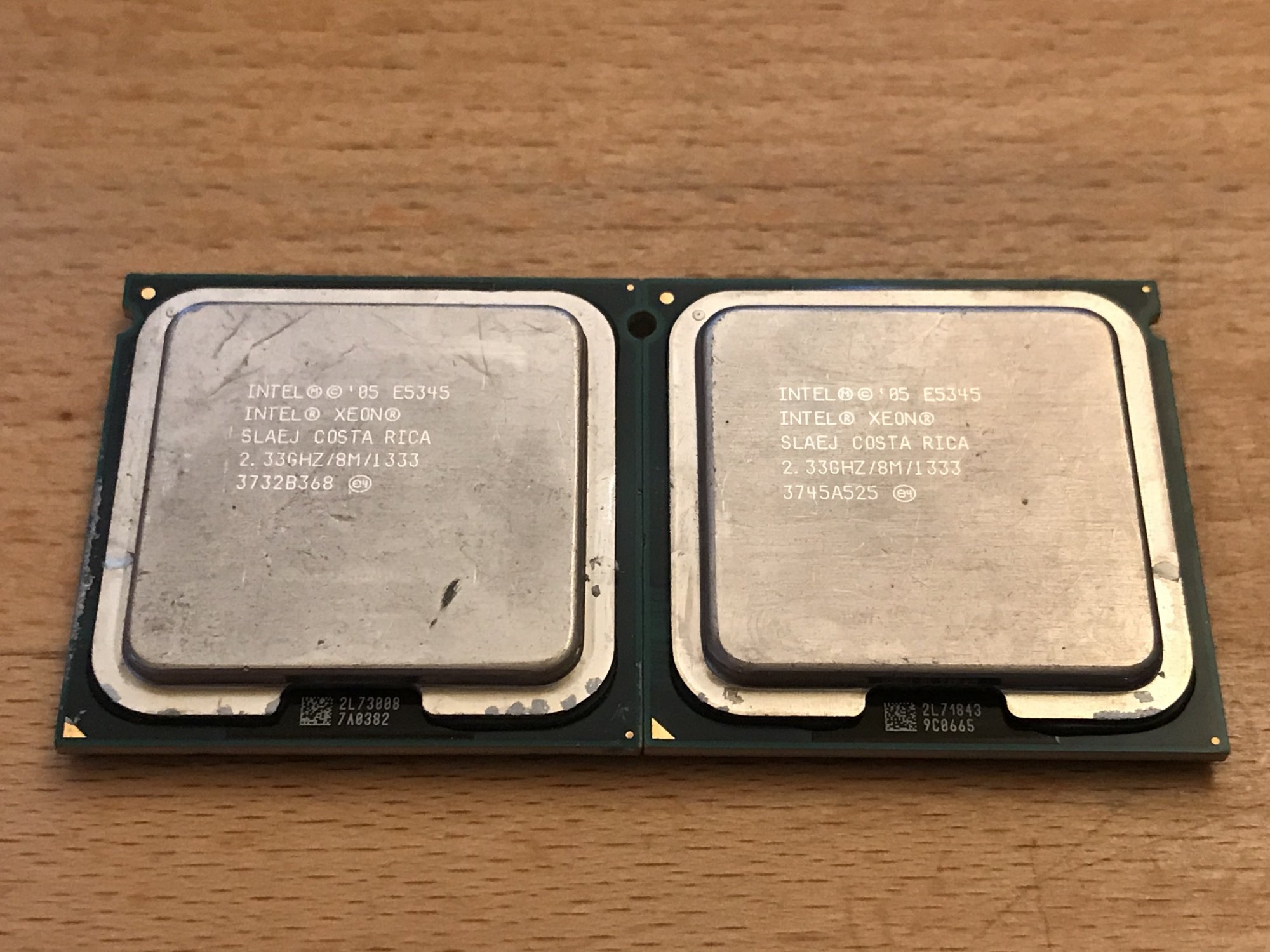

I am well aware of multi-CPU Macs, as I own a 2007 dual quad-core Xeon Mac Pro and a 2006 dual dual-core that I upgraded to dual "low power" quad-core E5345 chips (that were never actually used in Macs).
As @Bug-Creator suggests, having two separate M1 Ultras on the same mobo would be almost like having two separate mobos. The hardware design does not support this configuration properly, according to the engineers who have commented on this. BTW, while I don't claim to know much about this stuff, one of those engineers is the project lead for porting Linux to Apple Silicon, so I'm guessing he has a fair bit of knowledge of the subject.
Anyhow, I will use this post as an excuse to post my Mac Pro CPU swap pix. 🙂
