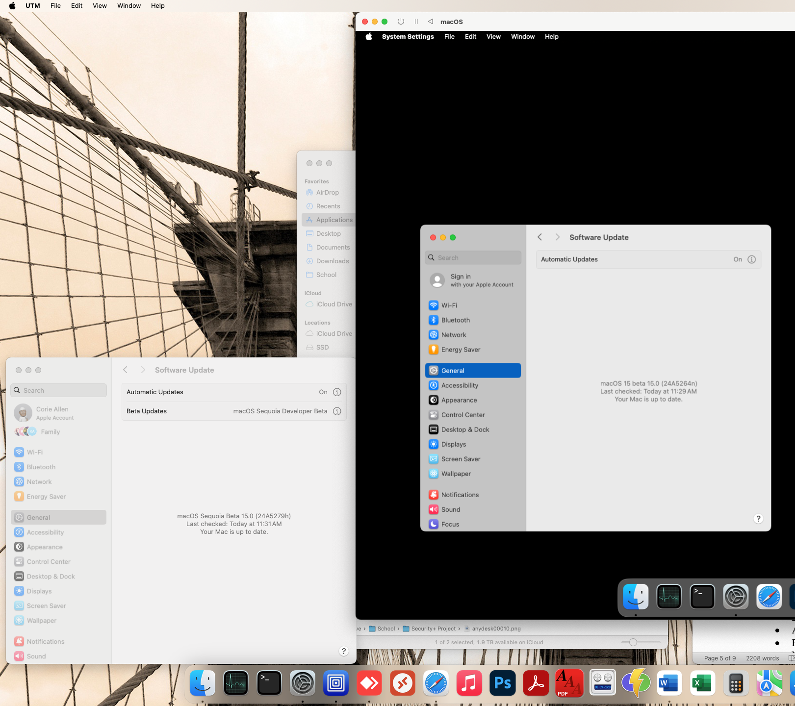

Has anyone been able to update their guest OS to the 2nd beta. The option for Beta updates doesn't show in my VM. Im using UTM.
You will need to get the full installer and use that to upgrade. Because you can't sign into iCloud from the VM you can't enable beta updates.
Thanks. Im hoping the iCloud log in is enabled for the 2nd beta

if it is, you won't be able to start by upgrading, you'll have to make a new VM using the IPSW, running on a Mac that's also running macOS 15.
The attached ZIP file contains a shell script that will enable beta upgrades through System Settings. (I just used it to upgrade my Sequoia VM to Beta 2.)
You may need to run this script each time you want to upgrade to a newer beta.

This worked for me, too on an M3 MBP! Thanks a ton! It saved me hours of work and disk space. I could simply upgrade my MacOS 15.0B1 VM under UTM to 15.0B2. Also, unless you are running a beta guest VM inside a Sequoia host (which kind of defeats the purpose of sandbox testing) you're not going to be able to log in with your Apple ID or use iCloud services.

Fusion can't virtualize macOS on Apple Silicon. Virtualization solutions on Apple Silicon which support virtualizing macOS use Apple's hypervisor framework, which is what prevents the iCloud logins from working. Fusion on Intel uses its own virtualization software which does not have the limitations that Apple built into its framework.
Signing in to iCloud should work on Intel-based virtual machines.

As best as I can tell, the following change should enable updating to the 15.1 beta
diff enable-beta-updates.sh.old enable-beta-updates.sh 3c3 < sudo defaults write com.apple.MobileAsset MobileAssetAssetAudience -string 98df7800-8378-4469-93bf-5912da21a1e1 --- > sudo defaults write com.apple.MobileAsset MobileAssetAssetAudience -string 1831c3e6-1dc4-4f6b-a9dc–7ae6a41d9af4
However, it didn't work when I just tested it in a macOS Sequoia VM. It may be necessary to build a new VM from scratch to get the 15.1 beta. (Use the Migration Assistant to get your data migrated from the 15.0 VM.)
Yes, the Sequoia host is a documented requirement.
I built a fresh Sequoia VM in UTM running under Sequoia. I was able to login to iCloud in the VM.
However, Software Update in System Settings doesn't offer the ability to enroll in Beta Updates in the VM even though I'm logged in. That's the only reason I rebuilt my Sequoia VM so I could enroll and update to 15.1 beta. (Sigh)
