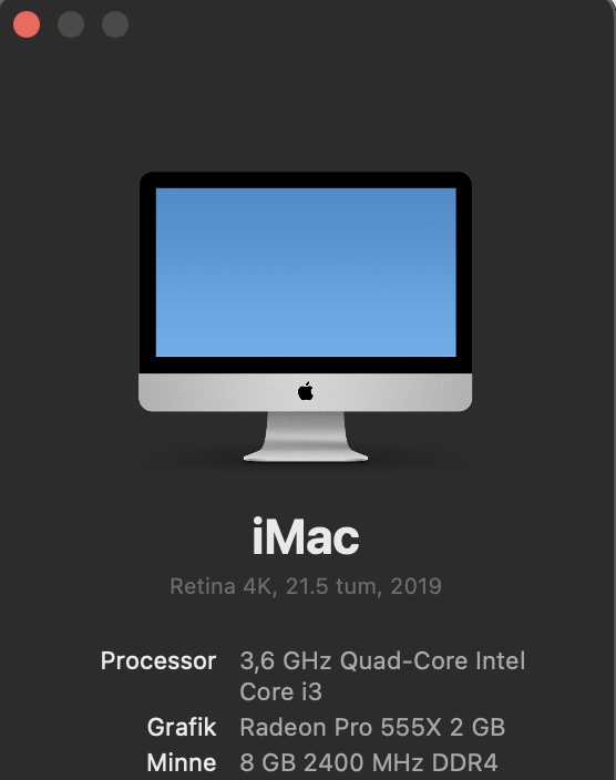

My iMac has these specifications, could it be the firmware? which machines do you have and firmware?
just a thought.
Modellnamn: iMac
Modellidentifierare: iMac19,2
Processornamn: Quad-Core Intel Core i3
Processorhastighet: 3,6 GHz
Antal processorer: 1
Totalt antal kärnor: 4
L2-cache (per kärna): 256 K
L3-cache: 6 MB
Minne: 8 GB
Firmware version: 1916.60.2.0.0
OS-inläsarversion: 564.40.4~66
SMC-version (system): 2.47f3

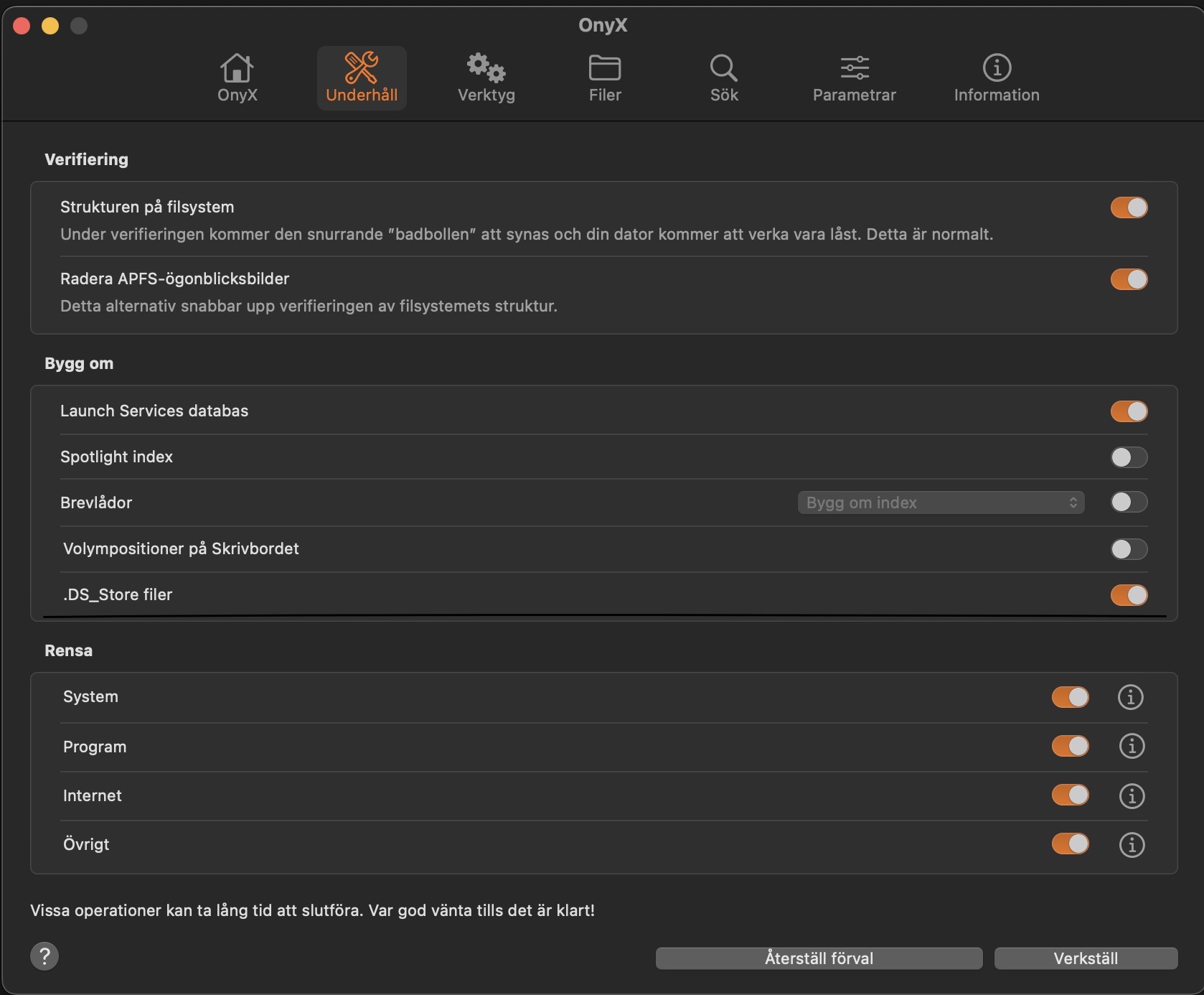

I checked those folders and found nothing but I ran the latest of Onyx 4.3.5 a couple of days ago with the settings as seen in the picture and haven't seen any of the file issues yet.
Very important to make a backup before running Onyx it cleans.
