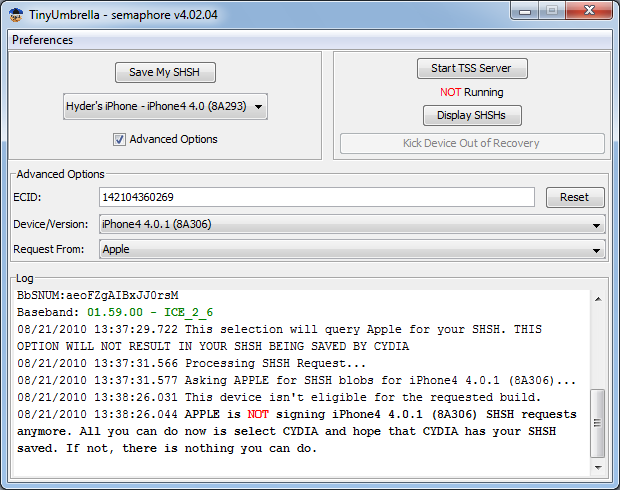

Why don't you read sephamore's blog? He's the guy that created TinyUmbrella, he may know a thing or two about this stuff. Here's a link for you. He himself says that if you didn't get 4.0.1 before Apple stopped signing, you're screwed. If you honestly were able to jailbreak your buddies' phones, then they either did have the hashes saved and you didn't know (this is easily possible if the hosts file was set to Saurik's server and they restored normally before the window closed), OR they were already on 4.0.1, and the restore failed which allowed you to remain on 4.0.1. If it isn't either of those cases, then only conclusion I can come to is that you're lying just to defend your point.
Hell, I'll attach pic of my phone failing to save 4.0.1 hashes from Apple. I can't demonstrate the same from Cydia since I got the hashes for all 3 of my iPhone 4s before Apple stopped signing them.

Both iPhones were on 4.0, neither had been updated nor had their SHSH files been saved. I used tiny umbrella to save their SHSH files then I used Saurik's servers to update the phones to 4.0.1.
What don't you understand about that?
What you're not understanding is you can't do that ANYMORE. Yes you could have done that before yesterday, but it's no longer possible because Saurik cannot retrieve the hashes from Apple. You probably saved hashes before. Even if you didn't directly save 4.0.1 hashes, if you saved 4.0 hashes, Saurik would have every subsequent version. Saurik does not GENERATE the hashes - only Apple can do that. He saves the hashes by sending a request to Apple.
This guy got a new phone that never had hashes saved. Apple isn't signing 4.0 or 4.0.1, and Saurik doesn't have them saved for that particular phone. So he cannot restore to those firmwares.
I'll tell you what. I'll buy a new phone, I'll pay out of my pocket. If I can restore it to 4.0.1 by pointing to Saurik's server, I'll give you the phone + $1000. If I can't restore it to 4.0.1, just reimburse me for the cost of the phone.
I don't want other people who are new to the jailbreaking scene to get confused. Purposely misleading people does make me angry, but otherwise I'm actually pretty calm at the moment.

The fack is I did update an iPhone to 4.0.1 AFTER Apple stopped signing and I was able to use TinyUmbrella and Saurik's servers.
