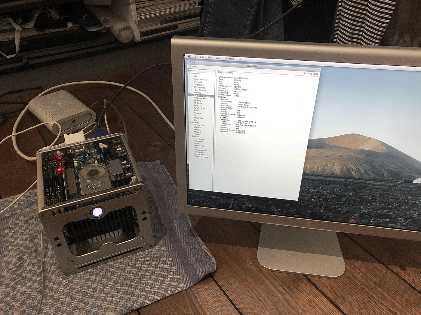

Well I took the gamble and so far it seems to have paid off.
For now I have only tested it in a DA G4 using VGA (didn’t have a DVI cable with me). I left it running the iTunes visualiser on max settings on full screen, for a good 12 hours. No problems so far 🙂
Thank you so much for the advice and especially to flyproductions for supplying the ROM.
I’ll post another update when it is finally fitted in my Cube.

Reactivated my Cube after a while, equipped with the Club3D 6200, flashed with the very rom i sent you...just to see, that it has flawlessly working DVI and even boots up fine with a dual display setup with VGA and DVI together.
Did you check the "usual suspects" i. e. pram-reset? What OS version are you running? And does the display/cabeling work ok with some other machine?
If yes to all, can you send me your card's PC-rom, so i can compare it to the one of the Club3D to check if (even that i don't expect so) there are any differences?

Sorry for the delay, I was waiting to get back on my PC to help eliminate issues.
Thanks for trying your set up for me. I had already tried the usual suspects, PRAM reset, PMU reset.. no luck.
I reinstalled my previous WANG XFX 6200 to check the displays, cables etc are all working fine. I also managed to get a dual display working, so no problems there.
Lastly, I restored the original firmware and tried it in a PC. There I found the fault - it seems that the DVI port is faulty 🙁
