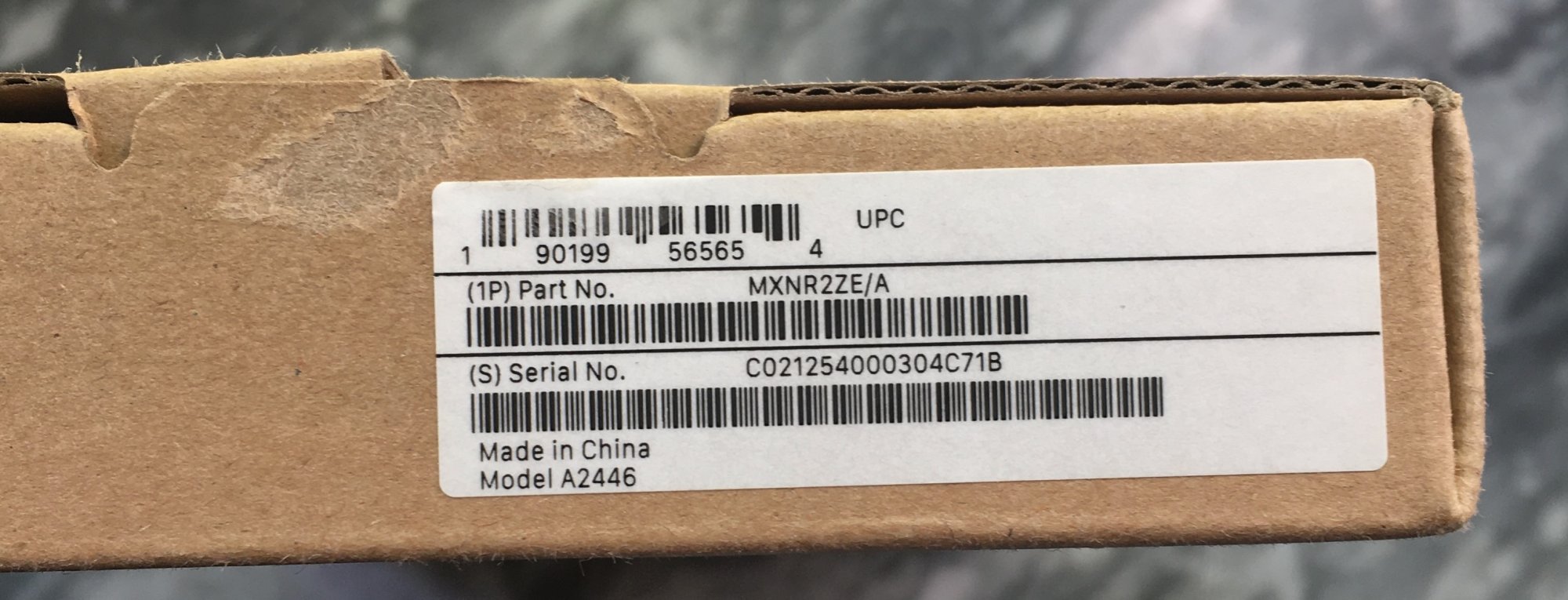

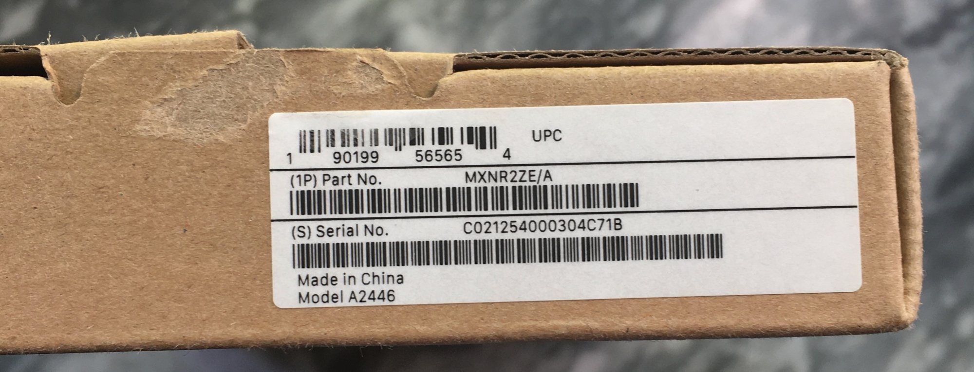

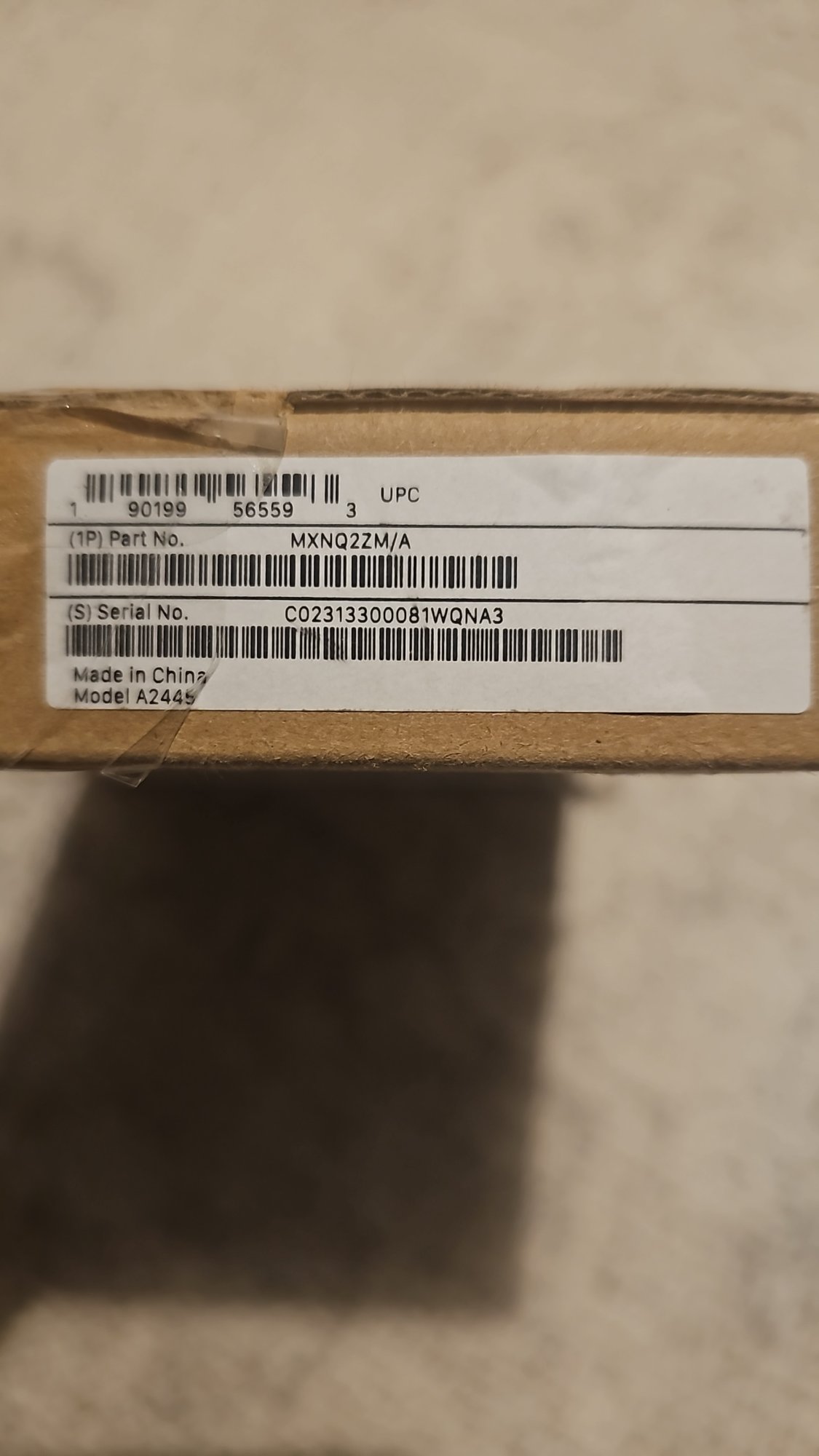

A relative of mine bought it just out of curiosity. Curious to see if the box could be original equipment vs Apple. So I think this is a non-Apple production product. He started the return without looking at the contents (without cutting up the box).
There, see - that's what makes me wonder:

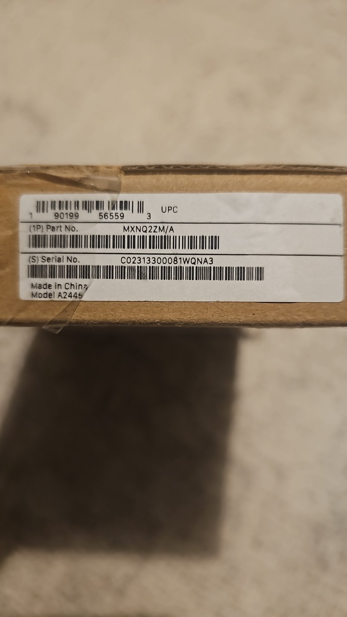

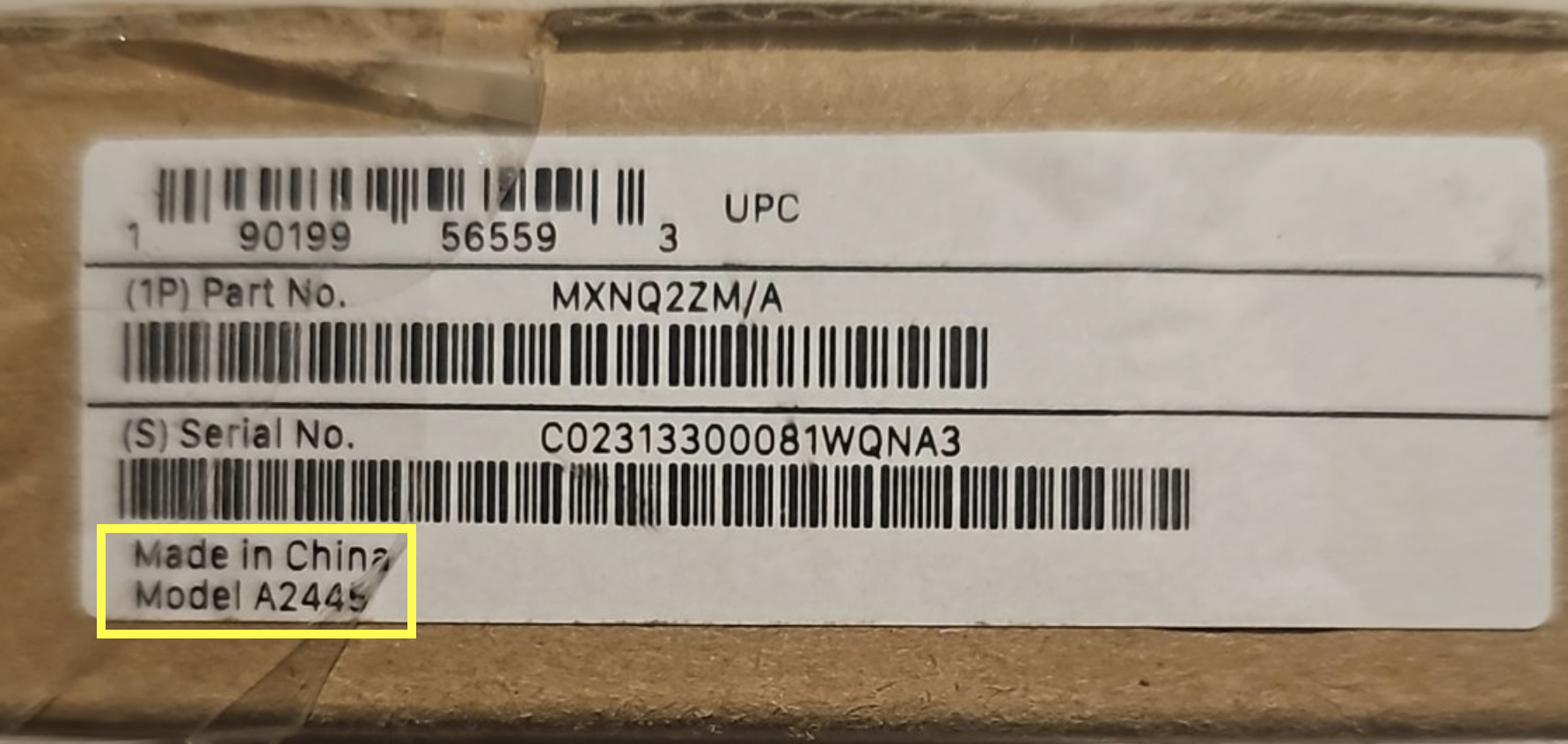

Model A2445. Hopefully someone will have genuine packaging for the same thing to be able to determine if that's correct or not.

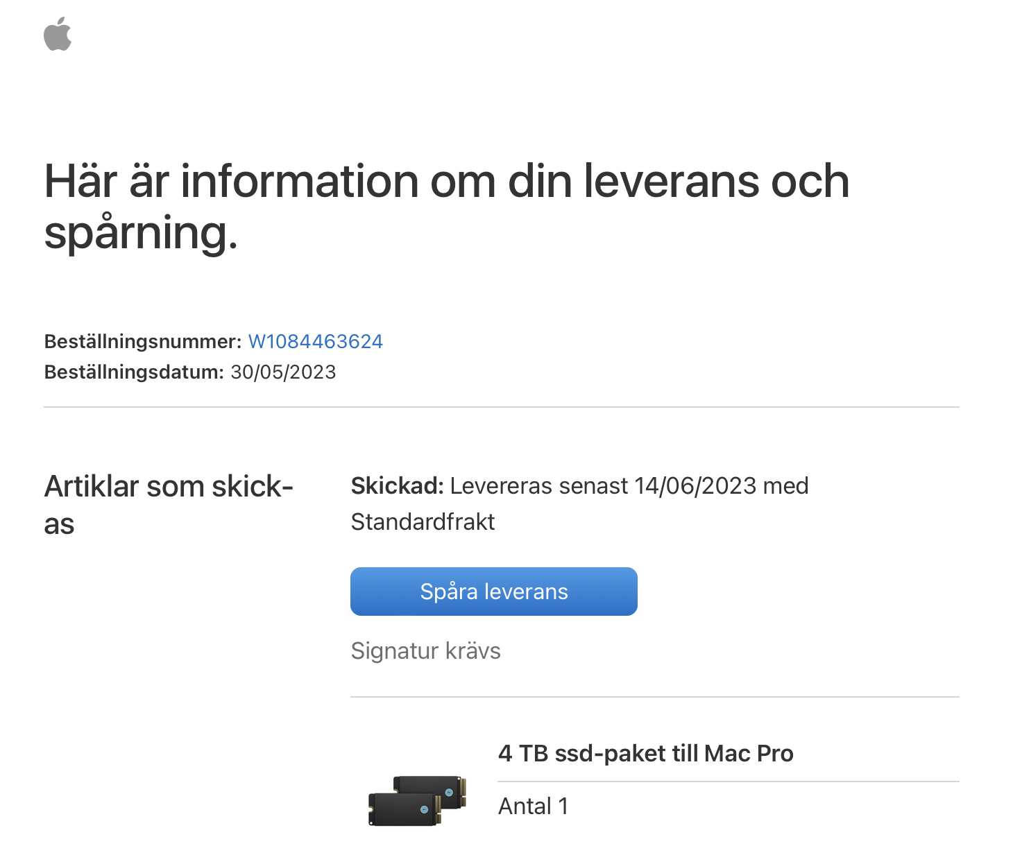

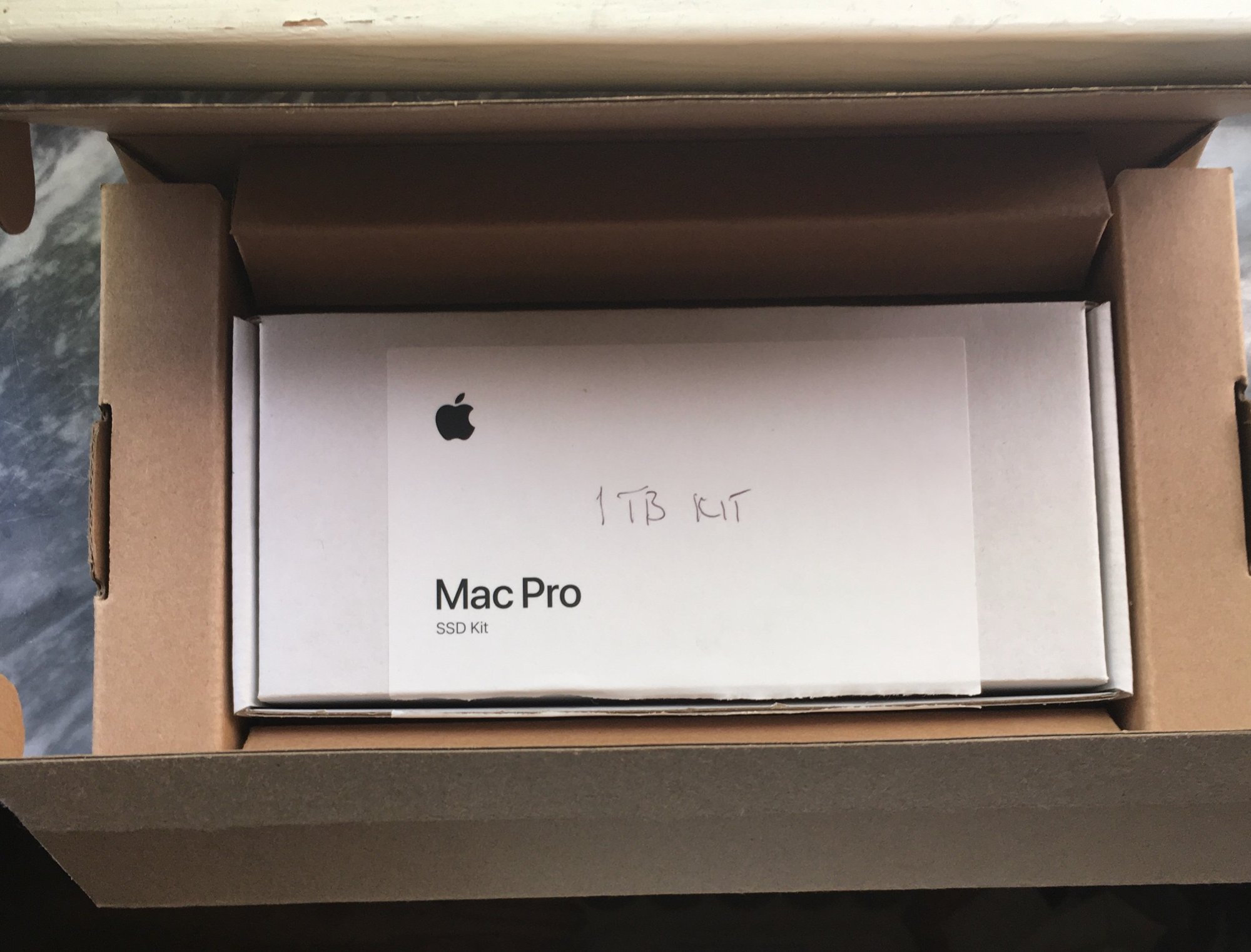

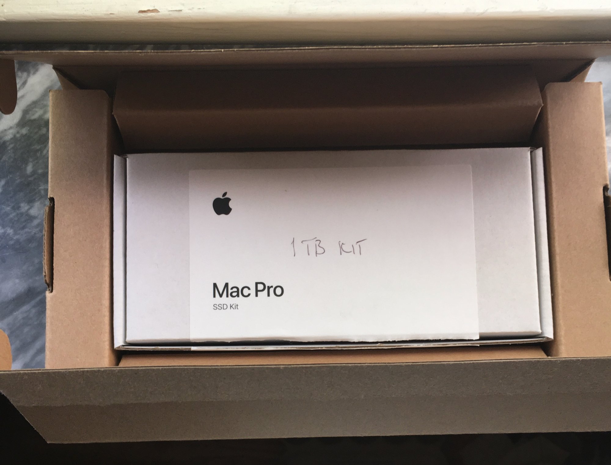

I am still of the opinion, it is a genuine part. I am baffled why you order from Apple's shop on Amazon, and then decide it's fake, without checking.
Here is my box with packaging. I ordered this directly from Apple Sweden.
I wrote 1 TB KIT to remind myself what size is in the box

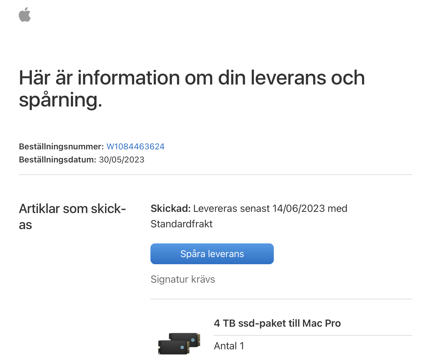

Can I ask how long ago you bought that?
I was told in the Uk that we can't buy the SSD separately. From the Apple Uk team;
So it looks like we have got to the bottom of it.
We can order the part but only as a repair not as an upgrade.
So in this instance we can not do this for you.
There are a couple of third party options and Apple authorised repair centres that may be able to do this for you.
If you head to locate.apple.com you will be able to see the authorised repair centres, it is definitely worth contacting a couple of local ones.

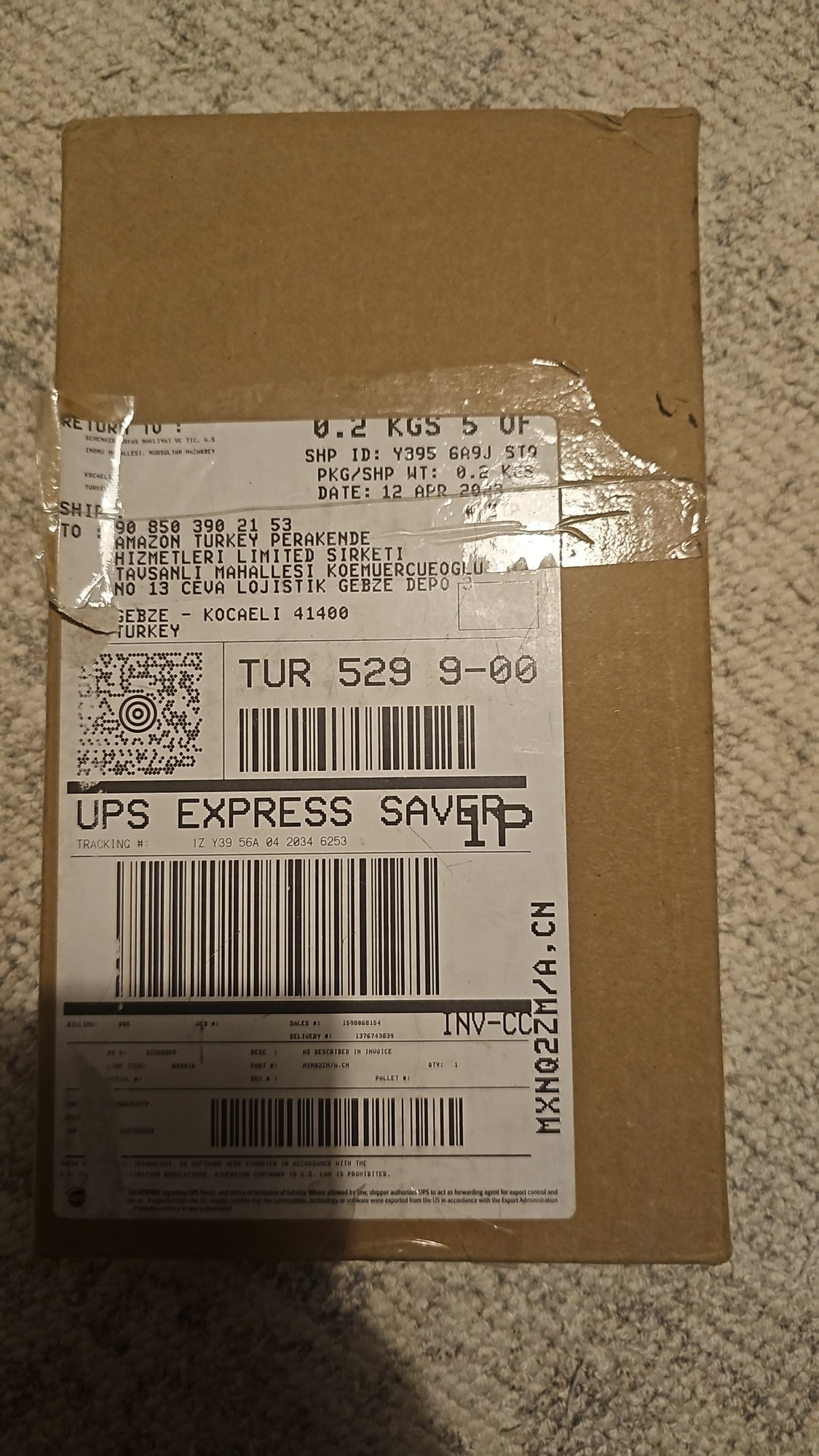

Actually, I didn't buy it, my cousin bought it as a test. The thought of returning it without damaging the package...
Now I'm starting to itch 😁. I wonder if I should buy it too. I will examine the package and analyze the situation.

Exactly right.
Good to see the other image above, that looks like the parts are genuine.
Genuine parts for replacement have boxes with labels exactly like that. Seems real to me.

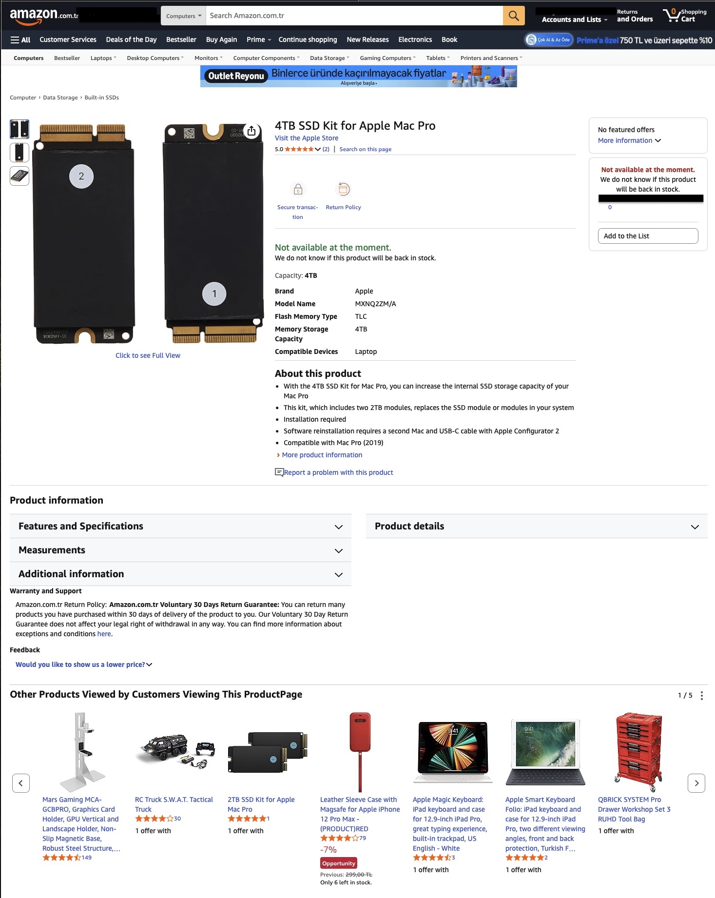

The king is finally back. And yes, I mustered up all my excitement and placed another order. All that's left now is the DFU wars (I need to find a second Apple machine). There are some good discussions going on here. I hope everyone is happy. Best regards.
Reactions: avro707

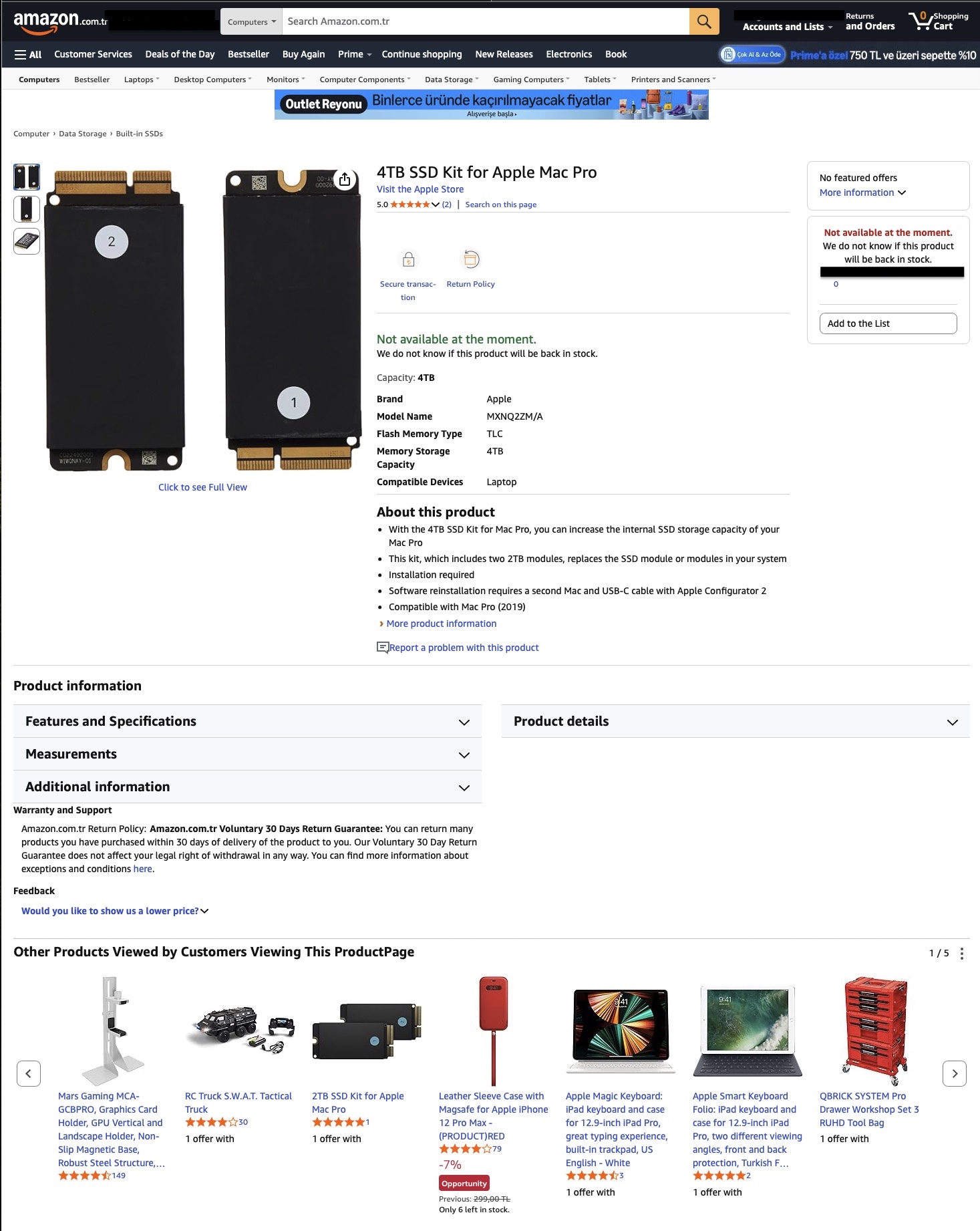

Can I ask where you're placing your order please, is it direct with Apple, (which country), or Amazon?
Amazon Türkiye... The seller is Amazon, and the store owner is Apple Store... I wish everyone had access to it. Also, 1 TB and 2 TB kits are on sale (there's not much price difference between them. I hope you can get it somehow. Best regards.
LİNK:
Amazon 4 TB SSD Kit
Amazon 2 TB SSD Kit
Amazon 1 TB SSD Kit

No, it's still there. In fact, there are currently 5 4 TB SSDs in stock. It's unlikely to be caused by your browser settings (unlikely).

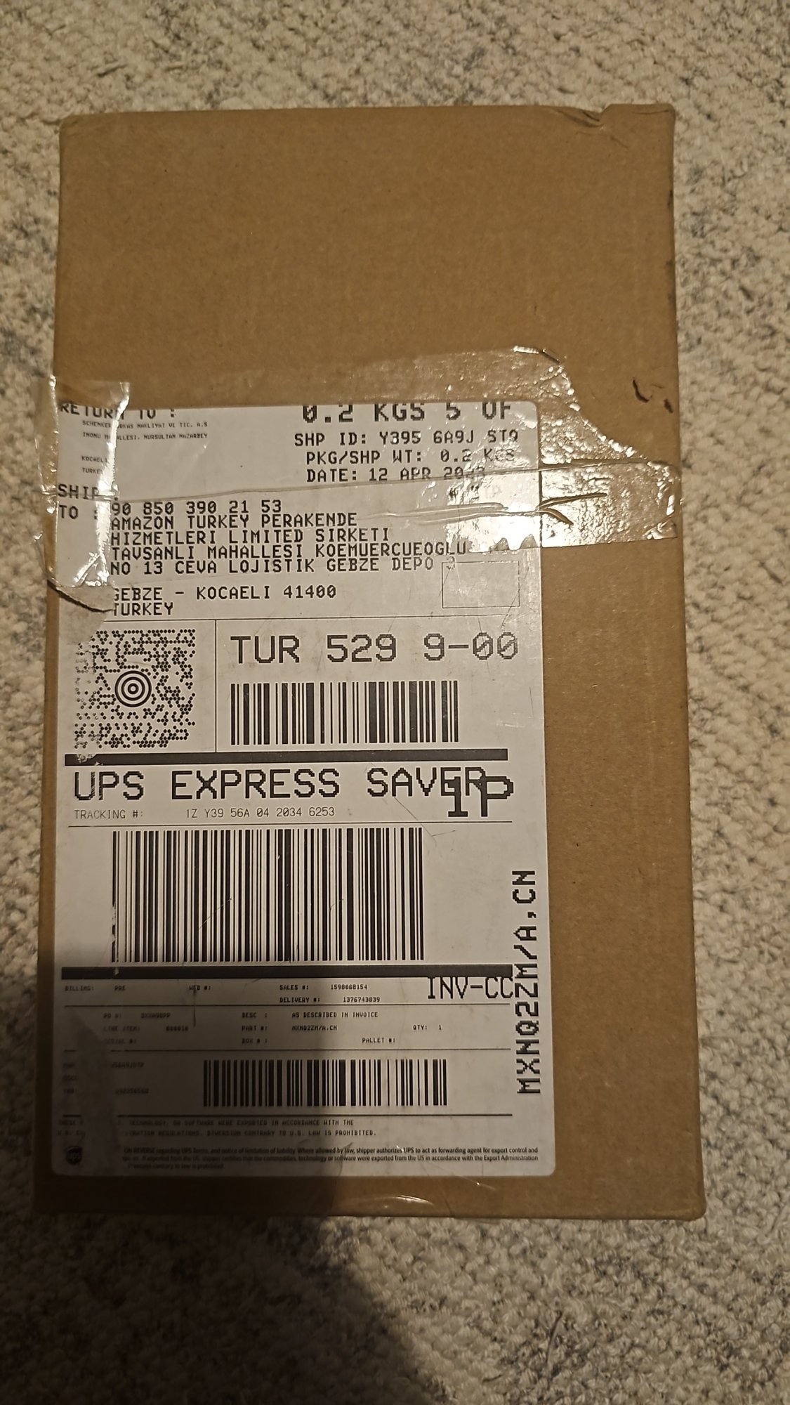

Amazon will not export the kit. As far as I can tell.
I also tried to log in on the Turkish site. When I ordered one kit, it produced an error. With no kits available
It won't let me do it now but I remember it came up with a red error bar.
All I see now is this;View attachment 2552985
Very interesting. Years ago I found a product on Amazon dubai. The only difference is that I gave the address of a friend who lives there and I was able to get the product. You seem to have no product at all, let alone the address. I just checked and there are still 5 of them. If I could, I wish I could make everyone happy, but it's a futile dream... Can you register a trial Tr Address (find a sample Tr Address from google) and check the stock status?
