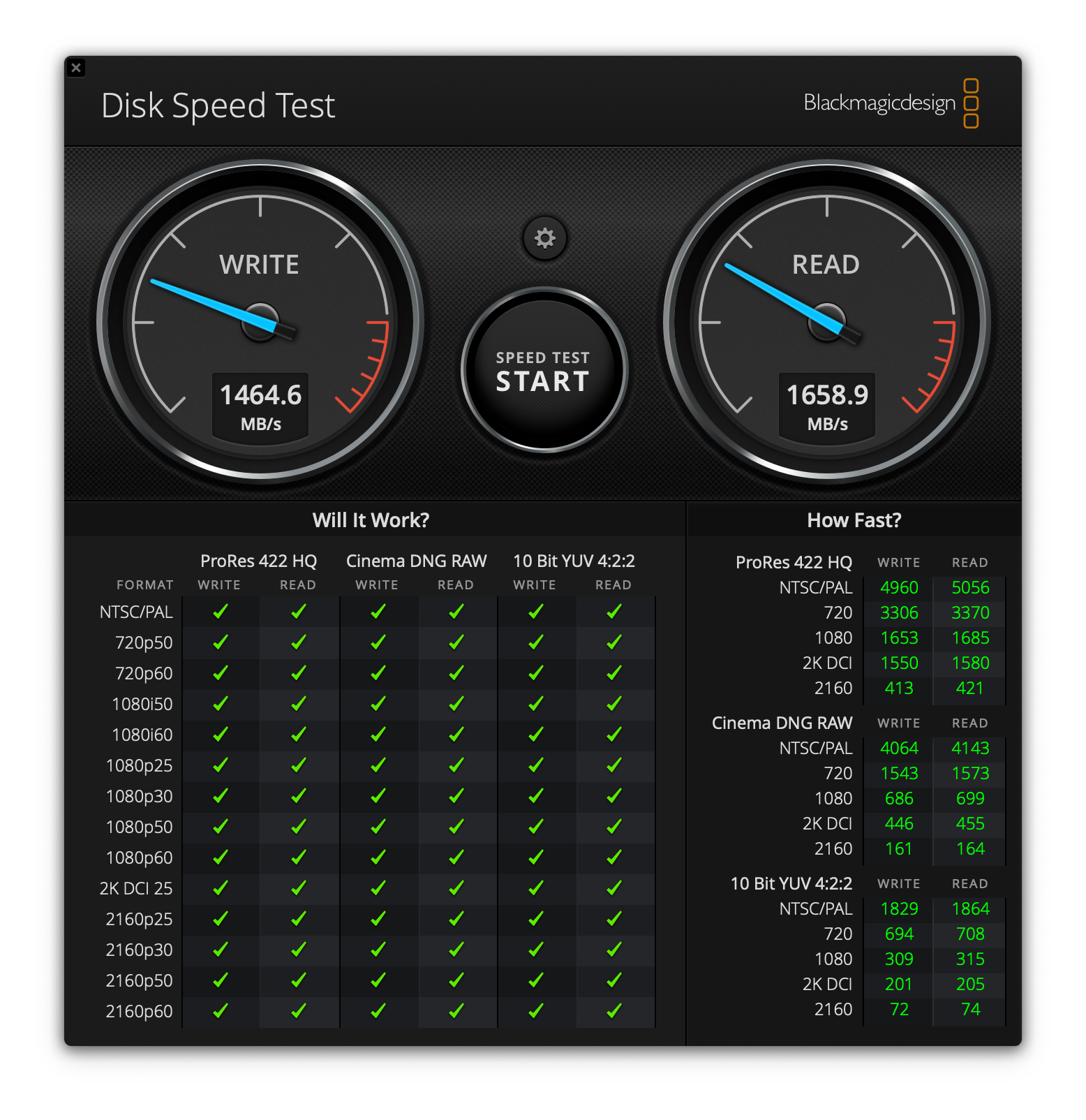

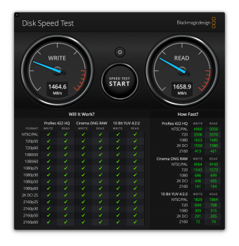

I upgraded my Macbook Pro (Retina, 15", mid 2015) with a 2TB Intel 660p M.2 nVME SSD and a Sintech NGFF M.2 nVME adapter. A High Sierra boot disk could not see the Intel SSD for partitioning, etc., but a Mojave boot disk had no trouble with it whatsoever. Install went perfectly, though restoring from my Time Machine backup proved problematic, as I had 2 HDDs in my old 2010 Macbook Pro. I had to use drive caddies to transfer the files.
Hi. I'm looking to upgrade the same as you [although probably with a 1TB Intel]. It will also be on Mojave. Im just writing to see if you had any issues, kernal panics etc or is it all good? Thanks in advance.
It's been about 6 months of heavy use and I haven't had a single problem with the laptop at all, drive included.
Thanks for the quick reply. I had heard some reviews that the drive can slow down because it's a QLC, but seemingly only if your are continously writing large files. I use my computer mostly for music production. I"m guessing you would recommend it?
I would recommend it, yes.
