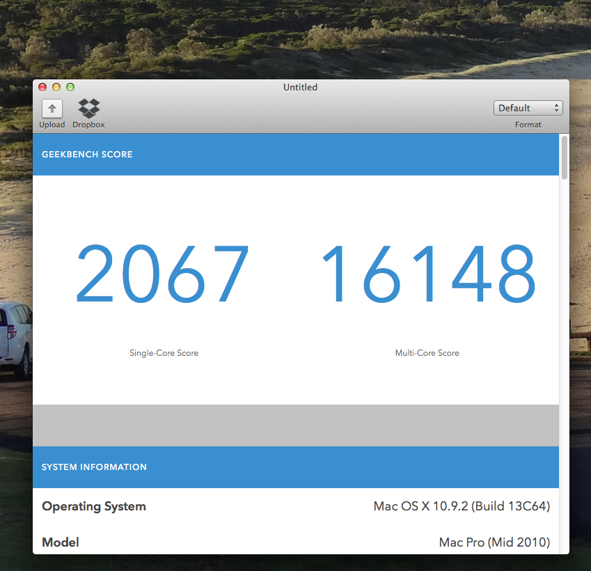

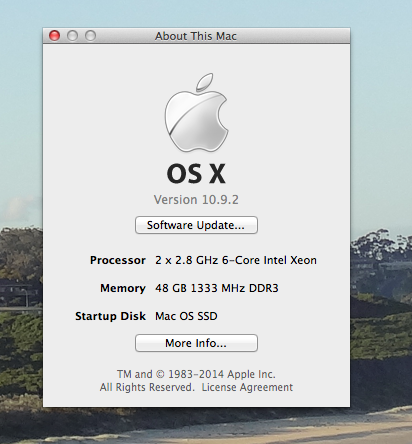

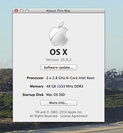

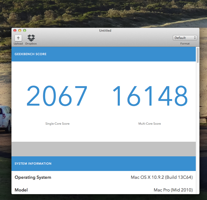

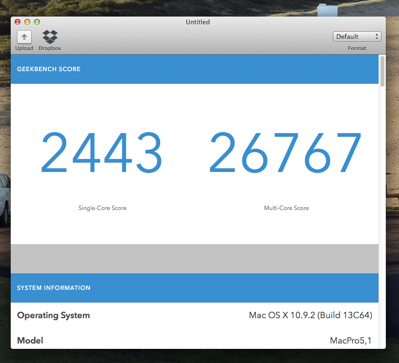

Installed and running 🙂
Some before and after stats attached.
