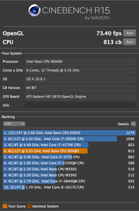

Unfortunately it's not so straightforward as you seem to imply. Scroll down to the bottom of the first link in my previous post. There are only two 7970 6GB video cards listed, both by Sapphire and both are overclocked 5% and 10% over the reference design, which is already an overclocked version of the base model. Based on common sense, the extra power increase would be more than the clock speed increase in terms of %, in addition to increased VRAM. However the two posters (K15 and KBS756) who reported using the 6GB cards somehow decided to attach to an external PSU.
