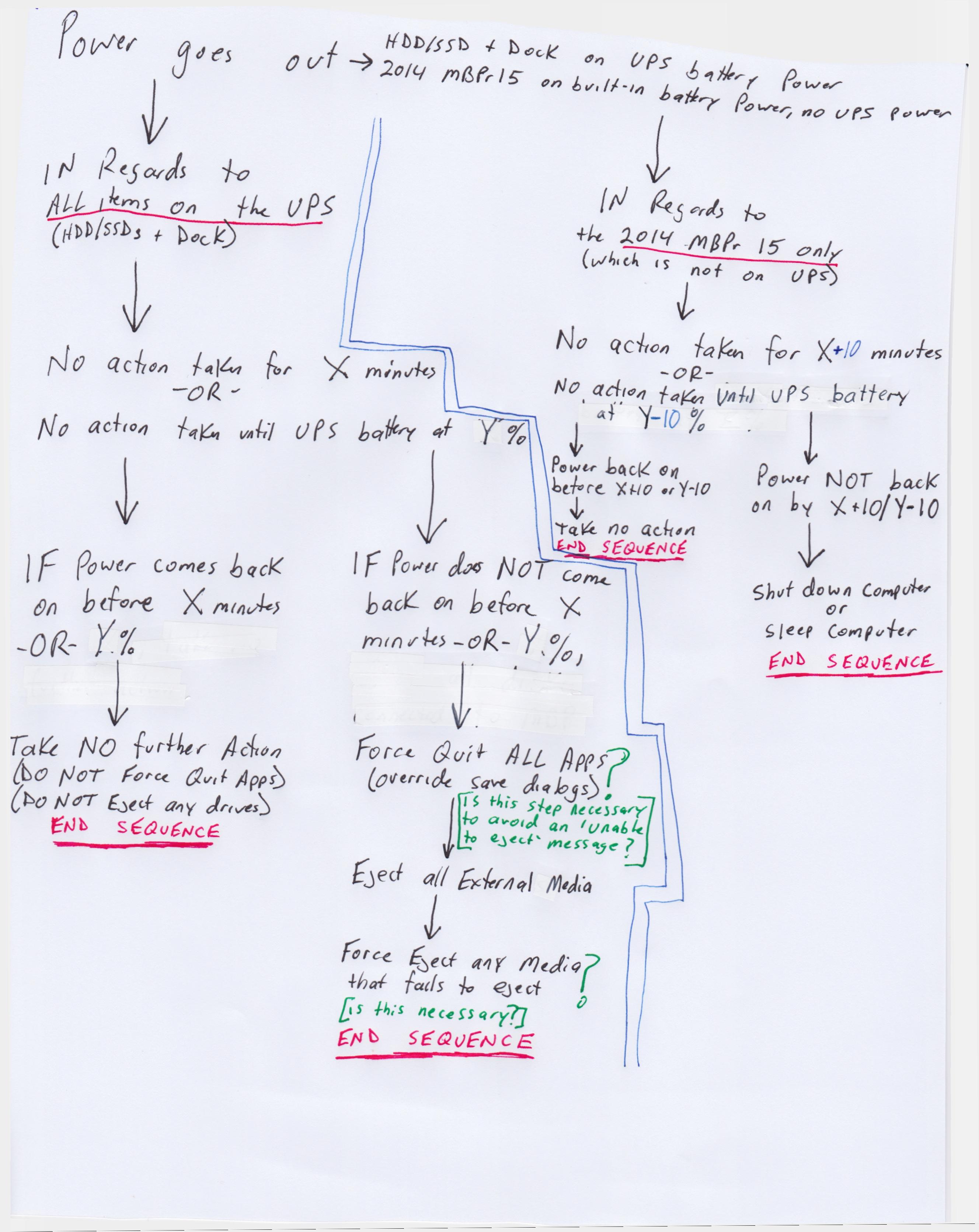

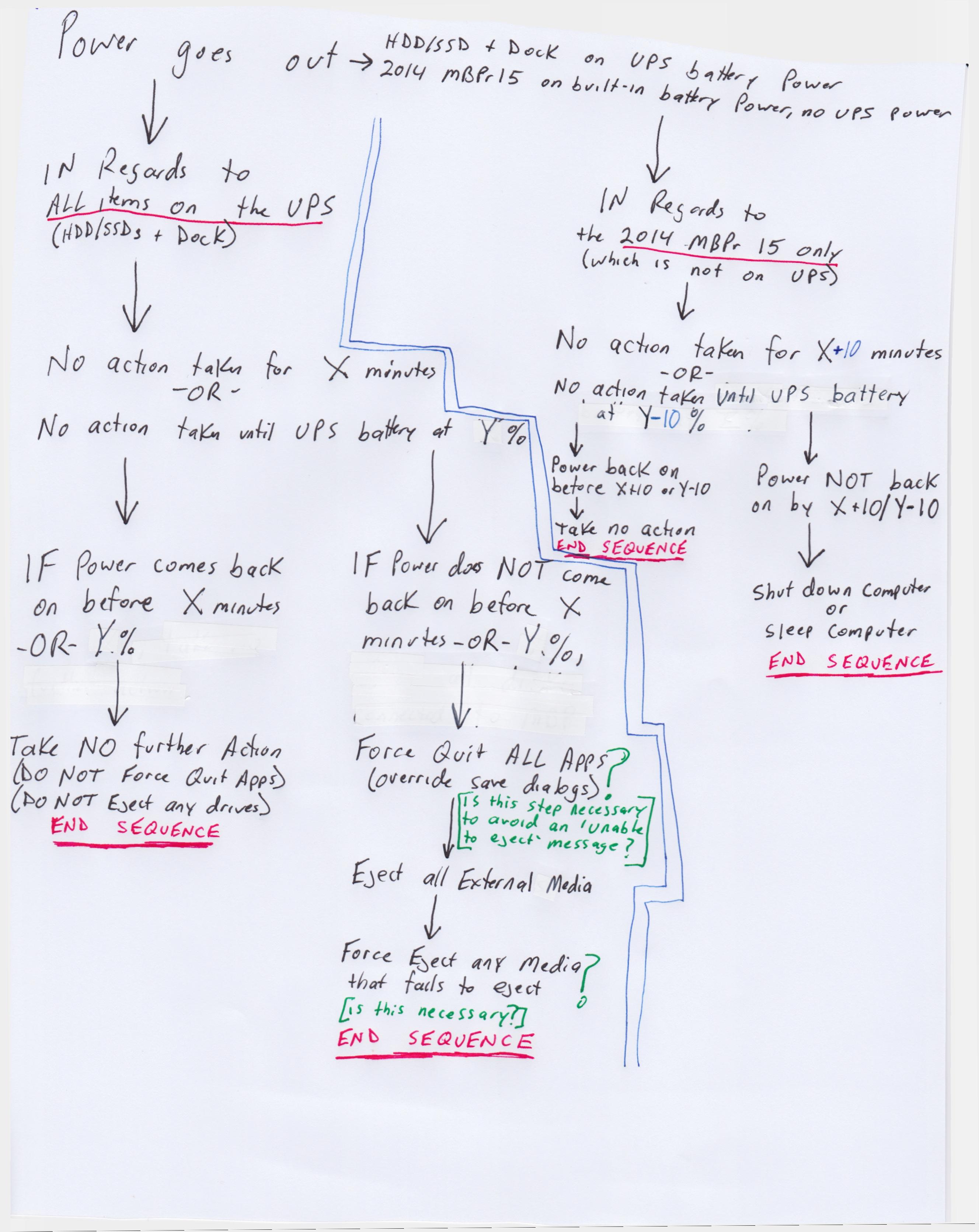

The reason I was originally thinking about having the shutdown command at 95% was to account for extremely short outages where the power goes out for a minute or two and comes back on (even though this unit is a modified sine wave, given the HDDs and SSDs all operate on DC power as does the Thunderbolt 2 hub, I figure this should not be an issue having them operate on a simulated sine wave UPS for just a few minutes.) Would it be better to think of the MBP and UPS from a separate line of reasoning? For example...
