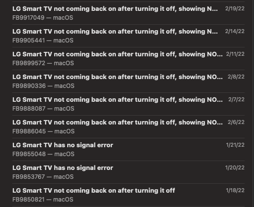

This has been an on going issue from way before Monterey 12.3. I have 4 large 52 inch LG Smart tvs throughout my house, I use one in my office as my main screen on my 2018 Mac Mini, ever since Catalina, into Big Sur and then into Monterey 12.2; I've had this issue where I can use the Mac mini for several hours not shut it down, turn the LG smart tv off come back several hours later turn the LG smart tv back on and it says "No Signal", tested it on all four of my LG Smart tvs in my house and they all do the same thing.
Seeing as I'm an Apple Advisor, I created a test account and tested it, still happened, disconnected all other devices from the machine, even erased and reinstalled ran the machine completely vanilla on a new install and it still happened on all 4 of my LG Smart tvs. I even tested using with 3 different HDMI cables.
I decided to bite the bullet because it was just getting extremely annoying, and just call Apple to see if I can get the issue escalated to SSE.
After speaking with Tier2 they went through the motions with me and we pulled logs, seeing as every time the issue happened I'd create a new entry into the feedback assistant and uploaded logs. The tier2 advisor had me upload all my logs along with making me run some data collection tool on my machine and then upload the logs for them along with screen shots of my system preferences display window.
I think about a week went by and I got a call back from the tier2 advisor and he gave me an update and let me know that engineering didn't see the graphics controller dropping off or cutting out so it wasn't a hardware issue, and didn't see the anything concerning in the logs neither.
So they decided it might be my cable or it needed me to use an adapter, so they sent me both. I tested with the adapter but it lowered refresh rate from 60hz down to 30hz which was not acceptable on a 52 inch screen, just wasn't going to happen. Left the new cable in they sent me.
The issue was still present, let the tier2 advisor know that. He then called me back a few days later that the engineers let him know that they would be pushing out a firmware update for HDMI, that I can expect that in 12.3. I thought great so Monterey 12.3 gets released I installed it and so far it was fine for a while, but then I left my machine running over night, woke up to turn on the screen and it says "No signal" .....SMH.
I really hope they get it together. I might have to call Apple back and have them reopen my case.
I posted the issue on Open Radar.
